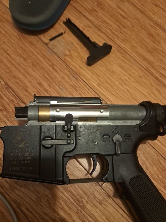

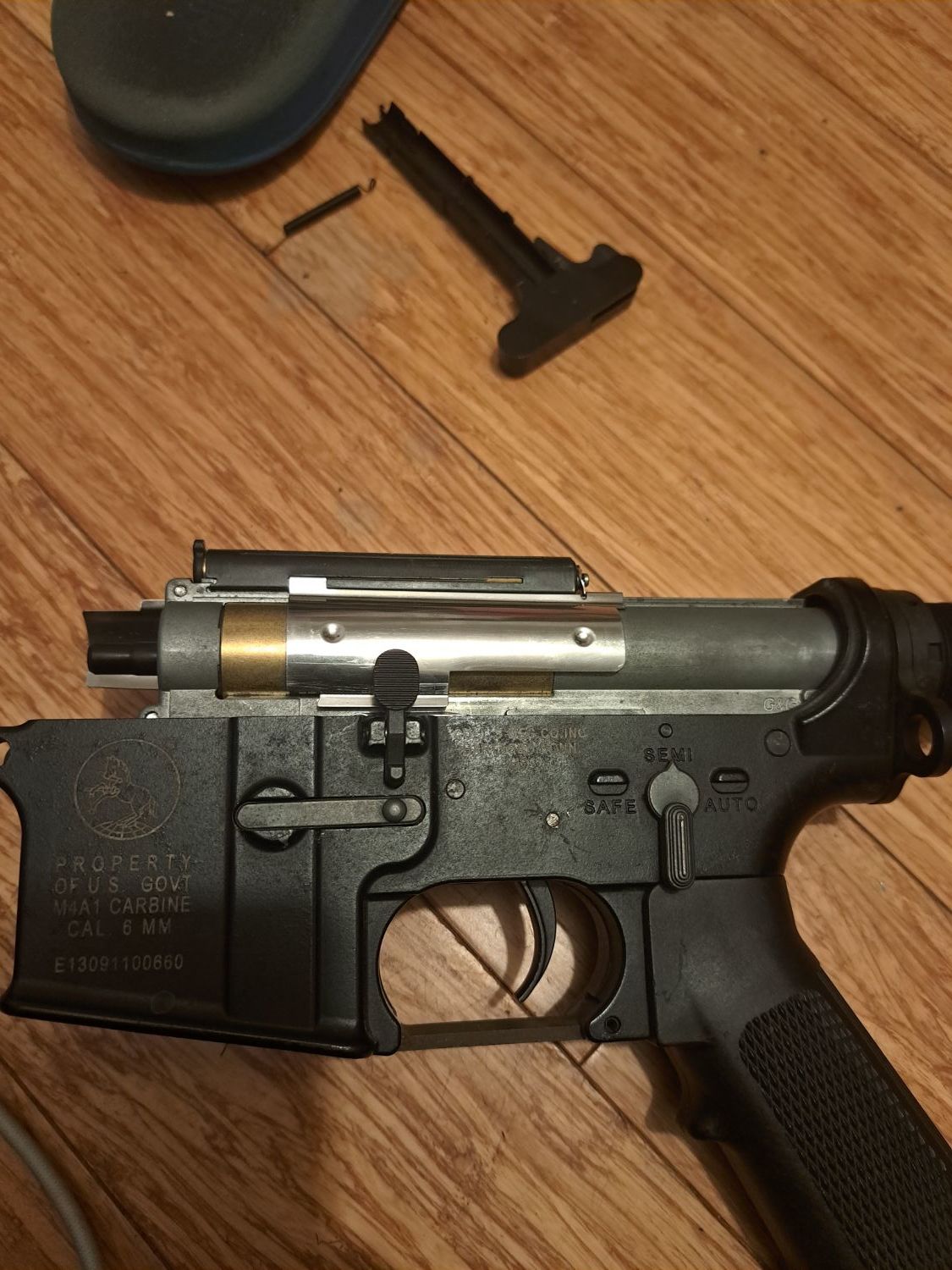

Bobbyw Posted June 5, 2023 Posted June 5, 2023 Need help identifying the gear box in my cybergun m4, it does not look like a v2 gearbox however I'm struggling to find someone with same gear box. If anyone could help me identify would be amazing thanks
Supporters Lozart Posted June 5, 2023 Supporters Posted June 5, 2023 1 hour ago, Bobbyw said: Need help identifying the gear box in my cybergun m4, it does not look like a v2 gearbox however I'm struggling to find someone with same gear box. If anyone could help me identify would be amazing thanks It's a V2 gearbox with added pneumatic blowback. All the internals will be pretty standard but the cylinder will have a hole at the top to bleed off air to make the flappy bit of metal rattle about. You could replace it with a standard cylinder and ditch the annoying clacky thing.
