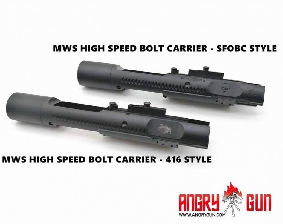

Crazy_Crystal Posted January 17, 2020 Posted January 17, 2020 so I notice angry gun uploaded some new bolt designs the other day... and I'm sat here wondering if the branded 416 bolt means they have more things in the works potentially? anyone have any thoughts or info on this?
Guest Yukarin Posted January 17, 2020 Posted January 17, 2020 55 minutes ago, Crazy_Crystal said: so I notice angry gun uploaded some new bolt designs the other day... and I'm sat here wondering if the branded 416 bolt means they have more things in the works potentially? anyone have any thoughts or info on this? They have already announced a 416 receiver back at the MOA show.
PopRocket123 Posted January 17, 2020 Posted January 17, 2020 39 minutes ago, Yukarin said: They have already announced a 416 receiver back at the MOA show. Which version? I'd love a 416A5 that's not made by VFC
Crazy_Crystal Posted January 17, 2020 Posted January 17, 2020 2 hours ago, Yukarin said: They have already announced a 416 receiver back at the MOA show. nice, I completely missed that one!!! and now to do some googling...
Guest Yukarin Posted January 17, 2020 Posted January 17, 2020 2 hours ago, PopRocket123 said: Which version? I'd love a 416A5 that's not made by VFC Dunno, 416s aren't my thing.

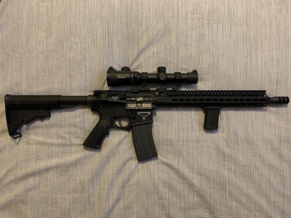

hunter511 Posted January 18, 2020 Posted January 18, 2020 Latest build state. Really liking the AngryGun BCM front end and Surefire Blast Warden. Next buys are BCM Gunfighter Mod 3 grip and a foregrip. GothicGhost and RobHedley 2
RobHedley Posted January 19, 2020 Posted January 19, 2020 13 hours ago, hunter511 said: BCM Gunfighter Mod 3 grip Just as a heads up Dave’s Custom Airport sell a Gunfighter Grip clone for £14.00. I have one but have yet to fit it. https://www.davescustomairsoft.co.uk/GunfighterGBBRGrip?search=Bcm Saves paying full real steel prices although I did have to buy a real steel foregrip as couldn’t find a clone. i am currently looking for a clone stock that looks like the Gunfighter stock to complete my John Wick/ Tarran Tactical TR1 build.
