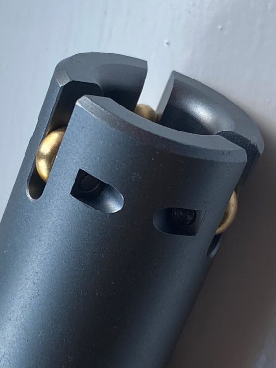

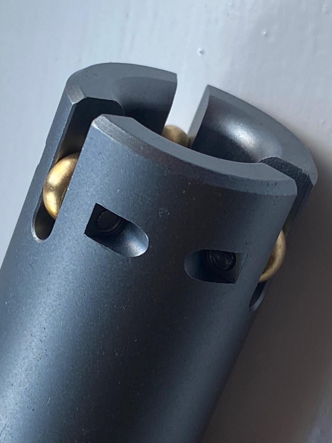

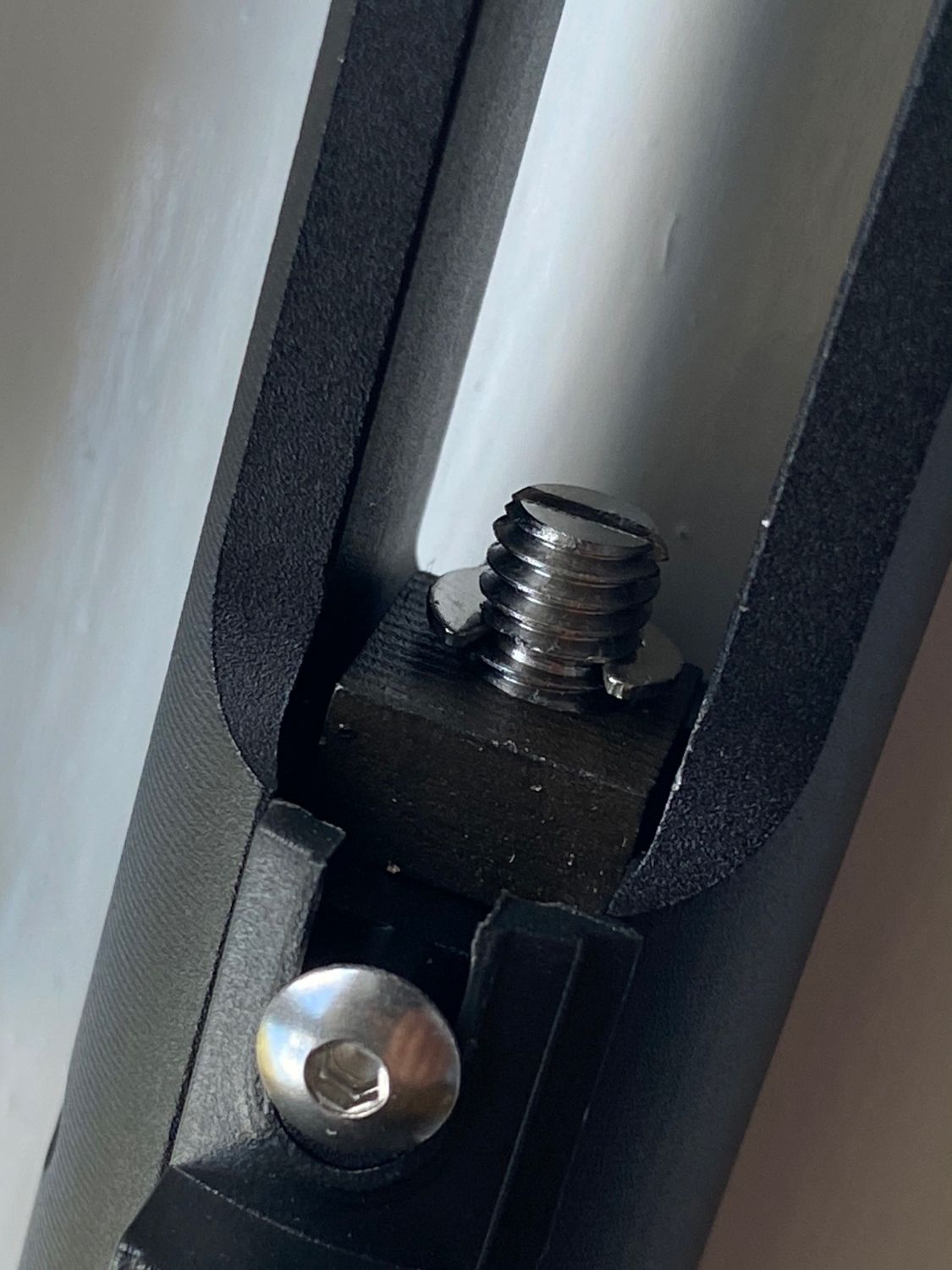

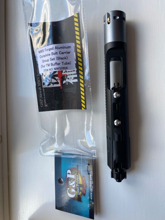

AlphaBear Posted October 22, 2020 Posted October 22, 2020 I got my mitts on a G&P bolt. The bolt is very light, I’ve not weighed it yet but it’s definitely lighter than the stock marui. The quality is very high. I’ve taken a few close ups. You can see how well formed the nozzle is. Definitely better than an Angry Gun one IMHO. Now what’s interesting is that screw for the bolt carrier hammer assist/firing pin and the circlip holding it. Ain’t that a strange design or is this considered an enhancement? What gives?
jsmithski Posted October 22, 2020 Posted October 22, 2020 I think that “upgrade design” is to better seal against the end of the bolt. Does it allow to screw/unscrew that shiny end part? If so, does it do anything?
AlphaBear Posted October 22, 2020 Posted October 22, 2020 I haven’t unscrewed anything to see what the insides are like. To be honest I got it on a whim whilst waiting for my replacement marui nozzle to arrive. Now I’m thinking, I may as well get the G&P npas valve and shove it into this bolt so that I can swap to using higher power when needed. I’m on a standard length (CQB) barrel so either i get the 3.5 version of the npas or I just get a 4.5 and adjust the power accordingly and hope that version works with the CQB. Dunno yet. Any thoughts? Now going back to the screw part it’s holding the hammer part of the bolt or whatever it’s called. Unlike the marui which has that bit forged as part of the bolt the G&P has it as a separate bit. See the pins below and you’ll see what I mean. Wild Weasel 1
jsmithski Posted October 22, 2020 Posted October 22, 2020 Got it but is there a posibility to move that screw in/out? There’s an oring on the other side so screwing it out would make the oring sit tighter possibly. I got no experience with GP npas.
