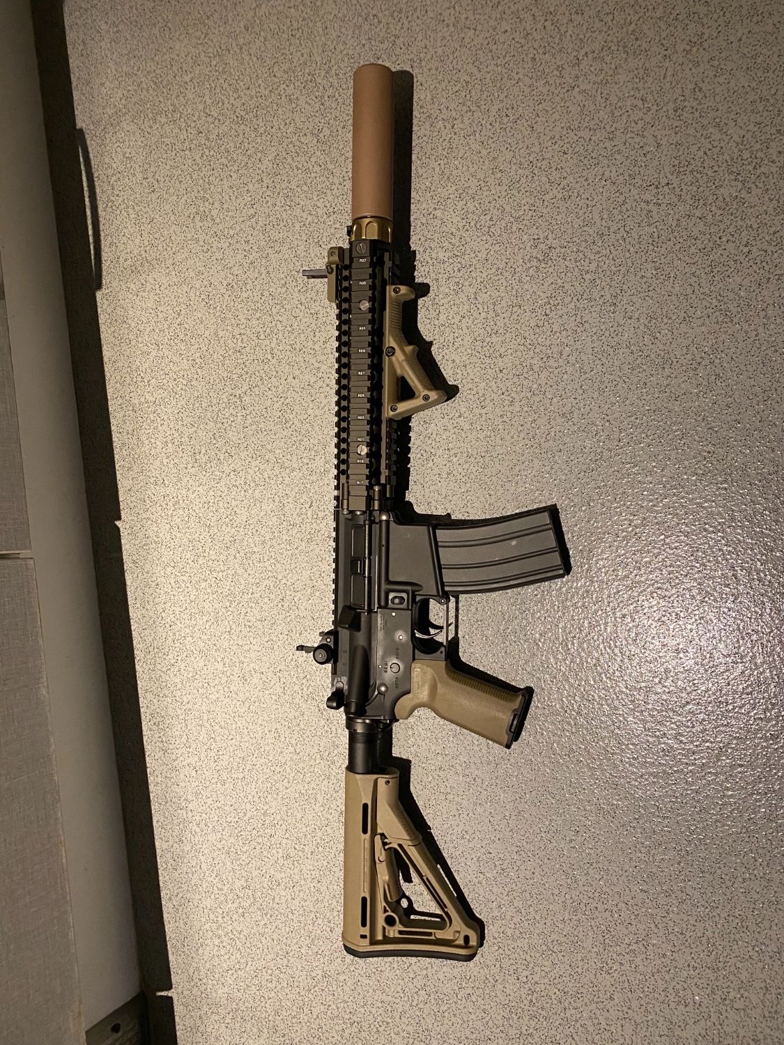

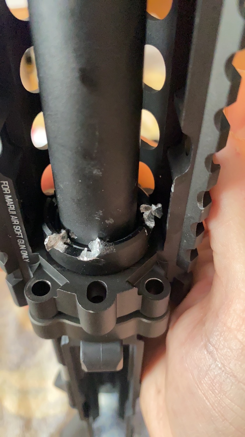

SkyNex0 Posted January 18, 2021 Posted January 18, 2021 Dont hate now but how to I get lose the railnut?? Ive tried to untread it on both directions but no way its moving. Just demolishes... sabaka and Shizbazki 2
SkyNex0 Posted January 18, 2021 Posted January 18, 2021 Is heat needed seeing as the picture kinda demonstrades violence ?
Supporters Shizbazki Posted January 18, 2021 Supporters Posted January 18, 2021 Heat is needed! My MTR 16 G Edition castle nut would not move for love nor money. Heat gun for a few minutes warmed it up enough that the glue melted and witha wrench i was able to get it off without damaging too much.
AlphaBear Posted January 18, 2021 Posted January 18, 2021 Damn! That’s the infamous MK18 with the almost impossible barrel nut isn’t it? I would have suggested using the correct tool to remove it but that may not be possible now as you’ve lost the teeth.
AlphaBear Posted January 18, 2021 Posted January 18, 2021 Otherwise a tungsten carbide cutting bit should do it... but be careful you don't nick the barrel or rail... Dremel do a cutting/milling bit which will eat up the metal easily...
SkyNex0 Posted January 18, 2021 Posted January 18, 2021 (edited) Yeah I guess it is. Is it righty tight lefty losey?? Seeing I added heat and used force. Next step is more force which means 99% break the nut. Is it easy to find replacements? EDIT: All I wanted was to change the railto one with another color, didnt think it would be such a mess ?. Just did my mtw and ptw to mk18s with brown/fde rails and now I wanted to this one aswell since I bought 3 fde ones. And I never thought this one would be like a nightmare EDIT2: Might aswell ask about the buffertube, Ive ordered a buffertube slingplate with a qd, well I have any issuses about losing the buffertub and replace the endplate with a new one like a real ar15 or is it glued aswell? Ty. Edited January 18, 2021 by SkyNex0
Reap Posted January 18, 2021 Posted January 18, 2021 @SkyNex0did you use hammer and chisel on that nut? I’ve acquired a heat gun to do mine but I’m waiting until I find information on the correct tool, before I even attempt it. I’ve seen a few people asking about this nut but it still seems like an unanswered question in regards to which tool fits it best.

SkyNex0 Posted January 18, 2021 Posted January 18, 2021 I looks black to me? Cant see any difference betwen the upper and the rail? Ah well since I only managed to damage the nut and nothing more I might aswell keep the black/fde one on then. Ghk mk18 is much lighter then the tm one?. Thanks anyhow for replies :). And yes I used a hammer and a punchtool

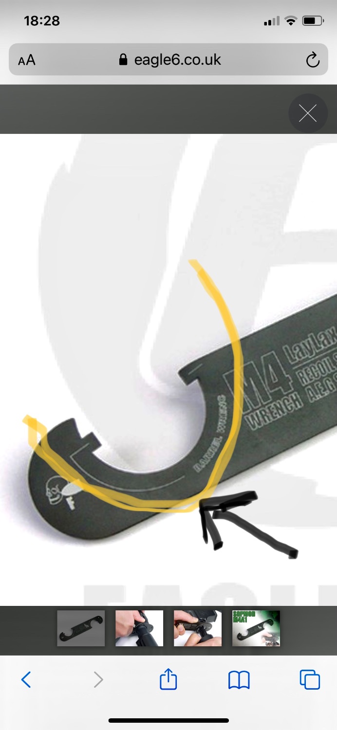

Reap Posted January 18, 2021 Posted January 18, 2021 This is the tool eagle6 use in their videos for the MWS, so I’m thinking about buying one of these, they’re around £20. Grinding along the yellow line until it fits inside the DD rail, and welding a new handle on to it where black arrow is pointing, but that is assuming the castle nut is the same diameter in the mk18 and the teeth fit nicely. AlphaBear 1

AlphaBear Posted January 18, 2021 Posted January 18, 2021 4 hours ago, Reap said: It sure is a dark bronze, it’s lovely infact. Yup it sure does look nice..... it's similar to the madbull colour if not the same... they probably use the same RAL codes? The fundamental problem with the Mk18 MWS is that the hop rubber can't be changed easily coz you can't get the bloody rail off and ergo the barrel out. That is correct yes?
Davegolf Posted January 18, 2021 Posted January 18, 2021 Yup, id personally sooner buy a bog standard MWS and make my own MK18 without PITA parts. SSPKali and quango2k 2
AlphaBear Posted January 18, 2021 Posted January 18, 2021 20 minutes ago, Davegolf said: Yup, id personally sooner buy a bog standard MWS and make my own MK18 without PITA parts. Exactly what I have gone and done.
Reap Posted January 19, 2021 Posted January 19, 2021 Unfortunately I bought the MK18 before we knew about the dreaded barrel nut, however I’m not rushing into upgrading, I have a SixG brass nub from Dave which has sat in my draw since November, I’m kind of learning from other people mistakes before I attempt it, this one largely comes down to having the correct tools for the job.
AlphaBear Posted January 19, 2021 Posted January 19, 2021 Yeah that’s true. Once the correct tool becomes available we will all have a laugh about it.
