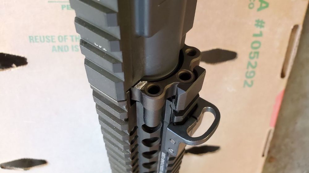

Kerberos Posted March 30, 2021 Posted March 30, 2021 (edited) Does anyone have a picture of the barrel nut keeping the Mk18 Mod 1 GBBR rail locked in once it's been removed? I finally got around to getting a clamp, heatgun, and tool to try to remove it. I ended up shearing off one of the anti-rotation tabs on the rail, but the nut seems glued directly to the rail, not the barrel itself. Edited March 30, 2021 by Kerberos Clarify what broke

Reap Posted March 31, 2021 Posted March 31, 2021 @Kerberos On Friday I quickly made a tool at work for this but the bars external diameter was too big so I need to make a new one, I noticed my gas block was glued to the inner barrel, I was surprised by this as I thought it would just slide out after removing the 2 grub screws, that being said the missus hair dryer was enough to heat it up so I could break the seal. I won’t lie I’m actually scared of the heat gun marking the paint or causing some kind of discolouration to the receiver or hand guard rail. starting to regret not going with the original MWS now, my reason for picking the MK18 was that I believed it would be the MWS V2 reviewed, improved and finely tuned, and maybe it is just that! and that’s why we can’t get to the innards of this gun-because we don’t need to? I often hear people saying “why buy a TM and then change the internals? its no longer a Marui if you do that, It’s already amazing out of the box” so there’s obviously a debate to be had there because so many people DO buy a TM and change some of if not nearly all of the internals-and I haven’t been around long enough to contribute to that one. I haven’t had a chance to skirmish this gun yet, and all the test firing has been done in very small enclosed environments, however lockdown is soon to be lifted and we can go skirmishing again and see what the MWS MK18 ZET is all about.

Kerberos Posted March 31, 2021 Posted March 31, 2021 (edited) @Reap That's really weird, because my gas block came off just fine after I removed the grub screws. As for the heatgun discoloring the barrel/rail, I had no issues with that. Had the heatgun on the barrel nut for almost 3 minutes and I damaged the clamp holding the gun down more than the gun itself. That being said, I planned to keep the gun mostly stock, the only thing I wantedd to change was hop up nub with the SixG nub I had ordered months before I got the Mk18. Only reason I got the MK18 was because I figured i might as well get one with the nice MK18 length rail by default, so I'd have an option to run with either the shorter MK18 rail, or my 12 inch RIS II rail. I guess I'm just going to keep the internals completely stock, because I don't really want to risk damaging my expensive TM anymore than I have. Ended up epoxying the anti-rotation tab back on, and tried to smooth it out best I could. It's mostly hidden by my replica holosight, but I'm a little upset with myself for messing up the externals of such a nice gun. The gun performed quite well the one time I got to skirmish it. Just wanted to see if i could squeeze out a little bit more accuracy at range with the SixG nub Edited March 31, 2021 by Kerberos

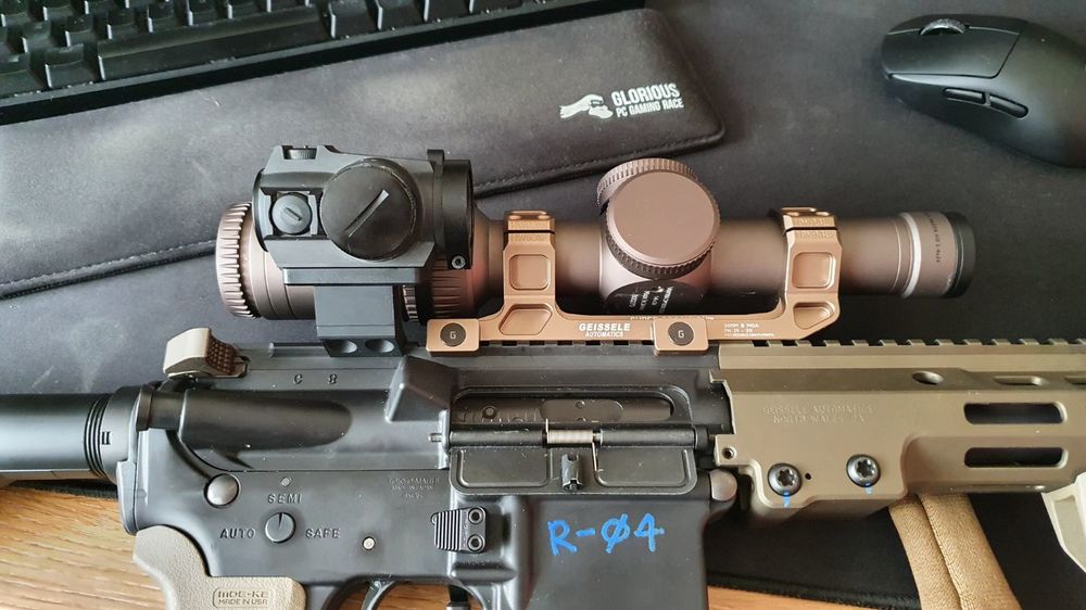

quango2k Posted April 1, 2021 Posted April 1, 2021 Offset mount arrived at last. Waiting on a 1.93 mount for the vortex in black and a 13.5 urgi rail. Decided to go long lol.. So if anyone is after a 9.7 geiselle rail it will be up for sale shortly.
