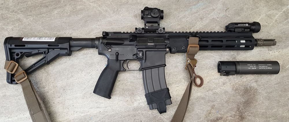

SSPKali Posted April 2, 2021 Posted April 2, 2021 5 hours ago, AlphaBear said: Ooooooh nice. I’m liking that! Hmmm i wonder what an URGI 9.3 will look like on my CQBR? Lol A lot like this! 1? Tom_84 1

AlphaBear Posted April 2, 2021 Posted April 2, 2021 (edited) 2 hours ago, SSPKali said: A lot like this! 1? Stop tempting me lol Hopefully HAO will start shipping soon to the UK again. Edited April 2, 2021 by AlphaBear

Wild Weasel Posted April 2, 2021 Posted April 2, 2021 4 hours ago, SSPKali said: A lot like this! 1? Or this... SSPKali and AlphaBear 2

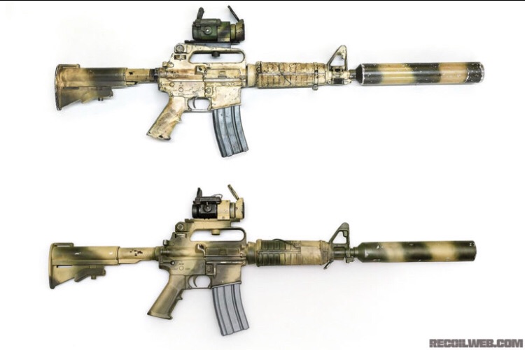

JSwan Posted April 4, 2021 Posted April 4, 2021 Has anybody ever recreated the “Gordon Rifle” CAR-15 from Black Hawk Down? I really like the look and wanted to give it a go. Seems simple enough but wondered if there were any examples knocking about ?
alxndrhll Posted April 4, 2021 Posted April 4, 2021 11 minutes ago, JSwan said: Has anybody ever recreated the “Gordon Rifle” CAR-15 from Black Hawk Down? I really like the look and wanted to give it a go. Seems simple enough but wondered if there were any examples knocking about ? The main thing you'll struggle with is finding a matching/close enough upper receiver complete with carry handle. If you can tick that box the rest should be relatively simple. Brownells do a Car stock which is manufacturer by B5 Systems (which means it's probably very good quality), may as well order the slim handguards from there while you're at it. Then it's just a question of how accurate you care to be with the gizmo's you attach to it.
