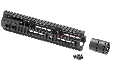

Khyber Posted March 4, 2022 Posted March 4, 2022 Hey, does anyone know if this Madbull Noveske rails fit the MWS out of the box? I'm trying to source one. The 10" full picatinny version without the open top as I will be removing the front sight. Thanks

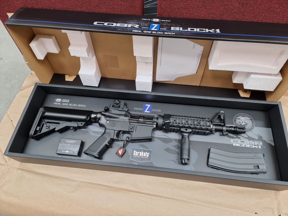

shrwd Posted March 7, 2022 Posted March 7, 2022 Hi all, new to the MWS gang ? Managed to secure a CQBR from fire-support's recent stock drop and I must say, she is a beauty! Already have some Magpul goodies on route as well as looking to change the stock for the Carbine version as I prefer the look. Also interested in one of the famous SixG SUPER NUB's to enable the lift of .36's. Does anybody know if these are still available to purchase? SSPKali and MAX DICKER 1 1
Khyber Posted March 7, 2022 Posted March 7, 2022 15 minutes ago, shrwd said: Hi all, new to the MWS gang ? Managed to secure a CQBR from fire-support's recent stock drop and I must say, she is a beauty! Already have some Magpul goodies on route as well as looking to change the stock for the Carbine version as I prefer the look. Also interested in one of the famous SixG SUPER NUB's to enable the lift of .36's. Does anybody know if these are still available to purchase? Welcome to the club. It is sure to bring a big grin to your face. I'm still in the honeymoon period with mine ? The SixG nub will be available again in a couple of weeks I was told by the guy who makes them a few days ago.

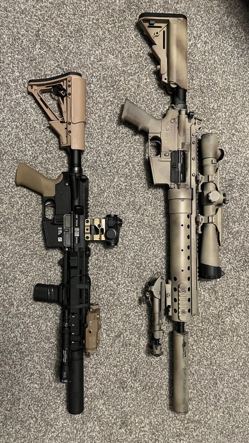

ArranTurner Posted March 7, 2022 Posted March 7, 2022 My two MWS builds! question for the guys running DMR builds, the MK12 is currently set up with the following: PDI 370mm barrel MR HOP 50 deg Trimmed omega nub Black NPAS As it stands on a 0.2 it’s clocking at circa 375fps (1.3J) and around 1.73J on a 0.4 That is with the NPAS wound all the way out on green gas (Vorsk V6) at room temperature Is my only real option here moving to red/black gas to see around 400-425fps on a 0.2? Would a longer barrel really make much of a difference? Fairly sure there is no air leak as power is consistent and I’m seeing similar figures from the L119 (albeit slightly lower with the factory barrel) Anyone done a power comparison between green and red gas? cheers! Tom_84 and Wavey_Gravey 2
Davegolf Posted March 7, 2022 Posted March 7, 2022 You will need red gas for 400+ or go longer barrel. PS the PRI looks sweet ?
ArranTurner Posted March 7, 2022 Posted March 7, 2022 13 minutes ago, Davegolf said: You will need red gas for 400+ or go longer barrel. PS the PRI looks sweet ? Cheers mate! Really think red would give me the 30 or so FPS boost I’m after? If I went the barrel route, 455mm? cheers!
shrwd Posted March 7, 2022 Posted March 7, 2022 6 hours ago, Khyber said: Welcome to the club. It is sure to bring a big grin to your face. I'm still in the honeymoon period with mine ? The SixG nub will be available again in a couple of weeks I was told by the guy who makes them a few days ago. Thanks and appreciate the heads up on the nub.

Davegolf Posted March 8, 2022 Posted March 8, 2022 21 hours ago, ArranTurner said: Cheers mate! Really think red would give me the 30 or so FPS boost I’m after? If I went the barrel route, 455mm? cheers! Yes, green is not potent enough. Im not a big fan personally of long barrels as I they can start hurting accuracy if you cheap out. As the barrels become longer the likeliness of them being out of true or having flaws increases. The longer the barrel the more imperative quality is.
ArranTurner Posted March 8, 2022 Posted March 8, 2022 4 hours ago, Davegolf said: Yes, green is not potent enough. Im not a big fan personally of long barrels as I they can start hurting accuracy if you cheap out. As the barrels become longer the likeliness of them being out of true or having flaws increases. The longer the barrel the more imperative quality is. Will give that a test then, I’m in the same boat in terms of barrel length, coming from building AEG DMRs running sub 250mm barrels to get decent voluming for 0.4+ it does feel wrong going for a super long barrel here
Cyberlawyer Posted March 9, 2022 Posted March 9, 2022 I run a 455mm Crazy Jet in my MK12 DMR build and it has been very good. I can get 450fps on green gas as long as the weather is reasonable and I haven’t noticed any difference in my groupings or accuracy at 50m (which is the longest I can test at home). I usually run .36g BBs at 385fps rather than .2s at 450 fps. It gives much better overall performance for me at least. ArranTurner and Davegolf 1 1

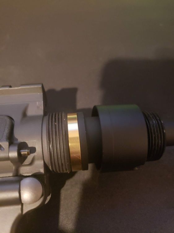

Snippy Posted March 11, 2022 Posted March 11, 2022 (edited) Interesting, finished my build for my mws and decided to muck around with it. I noticed after every shot, the shot after the bb would roll out and this is with a good 12 clicks of hop applied Full 21 clicks seems good. Anyone else had this issue with propane? Couldnt be a bolt bounce as it's happening every other shot. Brand new and stock internals, unless I over tightened the outerbarrel with the PTS handguard and shifted the hop. WIll disassemble and report back and tinker with how many clicks it takes to not roll out, but essentially it shouldnt roll out even with 1-2 clicks? Edited March 11, 2022 by Snippy
Wild Weasel Posted March 11, 2022 Posted March 11, 2022 10 hours ago, Snippy said: Interesting, finished my build for my mws and decided to muck around with it. I noticed after every shot, the shot after the bb would roll out and this is with a good 12 clicks of hop applied Full 21 clicks seems good. Anyone else had this issue with propane? Couldnt be a bolt bounce as it's happening every other shot. Brand new and stock internals, unless I over tightened the outerbarrel with the PTS handguard and shifted the hop. WIll disassemble and report back and tinker with how many clicks it takes to not roll out, but essentially it shouldnt roll out even with 1-2 clicks? Check the screw holding the hop adjuster is tight as it can cause it to catch the bolt and wind the hop off?
Snippy Posted March 11, 2022 Posted March 11, 2022 (edited) 3 hours ago, Wild Weasel said: Check the screw holding the hop adjuster is tight as it can cause it to catch the bolt and wind the hop off? It definitely is tight, I will muck around with it some more. I remember reading someone on the this thread where their hop adjuster was decreasing hop after a few shots, forgot how they fixed it. @HorribleSkrub had an issue, but he had over hop issues haha. @ajumma had aftermarket bolt/nozzle guide interfering with the hop wheel. I did notice in one instance of testing, I lost two clicks of hop, but again, 12 clicks of hop the BB shouldnt be rolling out? Unless my adjuster spring isnt applying enough tension :x The nozzle couldnt be over pushing the bbs though as at a full 21 click the bb stays (thats one good thing lol), or could it?! Hnng stock mws y u do this to me Edited March 11, 2022 by Snippy
Davegolf Posted March 11, 2022 Posted March 11, 2022 Most likely an assembly issue if all standard parts.
Snippy Posted March 11, 2022 Posted March 11, 2022 1 hour ago, Davegolf said: Most likely an assembly issue if all standard parts. Wonderful :') I'll take some photos later when I do another round of inspection!

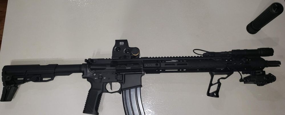

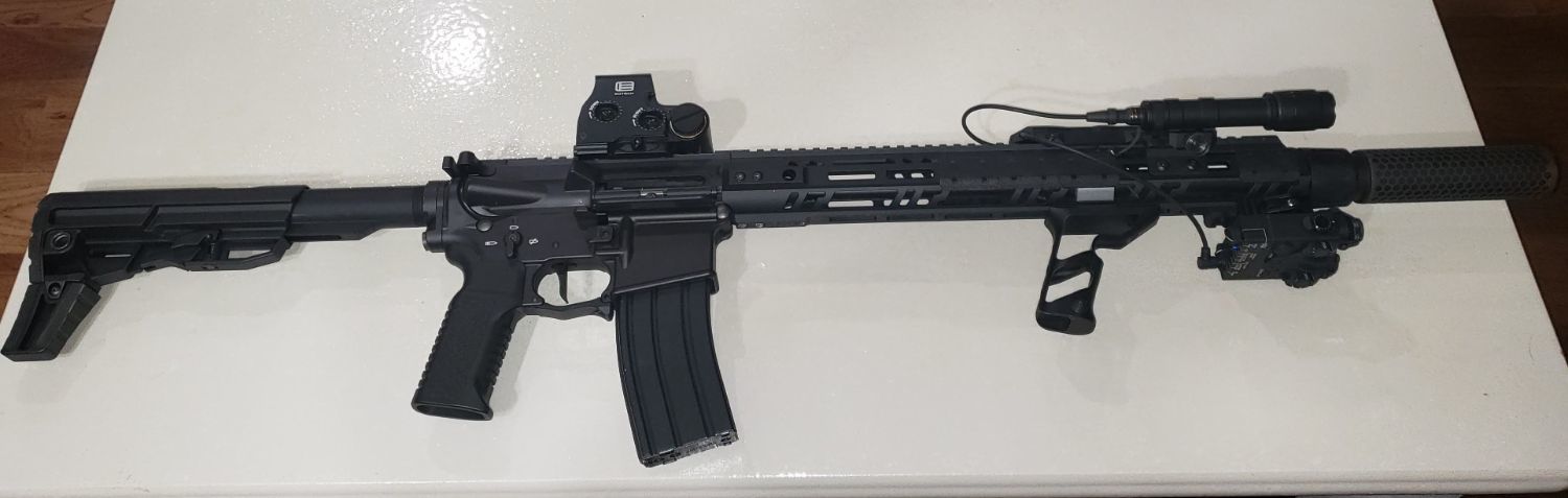

shinedown Posted March 12, 2022 Posted March 12, 2022 Got a TM MTR 16 just wanted to post a few pictures of my setup, upgraded inner barrel to a 410mm and angry gun MWS high speed bolt carrier with gen2 MPA w/ adjustable fps everything else is stock, gun now has a range of 260FPS to 370FPS. Fires 0.2's bbs at 360~370fps and 0.49's bbs at 290~305fps using green gas. Mock suppressor is Knights Armament KAC 556 Red dot is Eotech EXPS 3 replica 600 Lumen tactical light Replica Dbal-a Peq box Would like to change the rail if anyone know of a good clamp on M-lok and barrel nut that would work using a 5KU Mid-Length / 16" barrel https://www.evike.com/products/23488/ had to mil the flute to fit the barrel nut since it would not fit inside

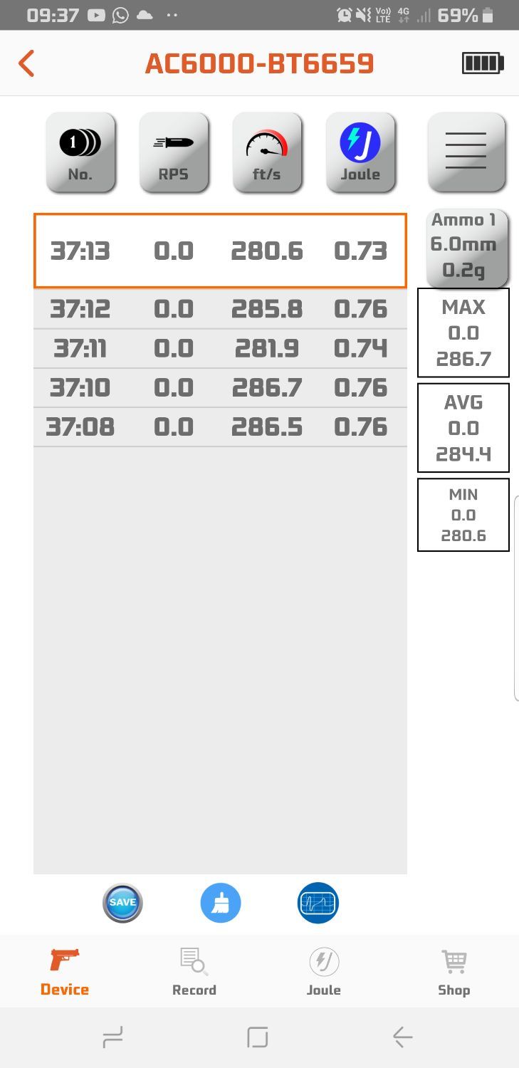

Khyber Posted March 14, 2022 Posted March 14, 2022 (edited) Just fitted an RA-Tech NPAS to my TM MWS. Great FPS improvement. Super happy with the results. First pic is before then second after. This is without the hop adjusted correctly. Had the barrel out and since have not set the hop properly. I just wound the hop on around half way to stop the BBs rolling out. Tested at ambient room temp with .20 BBs. Would highly recommend to anyone wanting to get your MWS closer to site limits on green gas. @Mr. No_Face Here are the results you were interested in. Edited March 14, 2022 by Khyber demandt 1

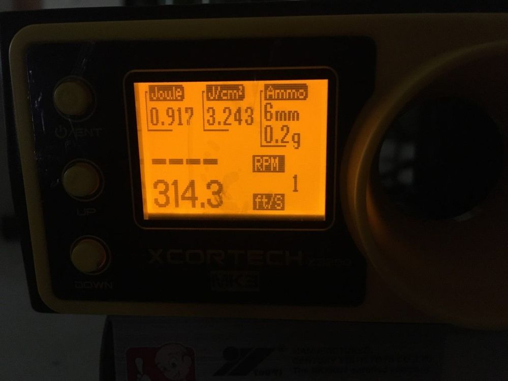

Guest Mr. No_Face Posted March 14, 2022 Posted March 14, 2022 (edited) 5 hours ago, Khyber said: Just fitted an RA-Tech NPAS to my TM MWS. Great FPS improvement. Super happy with the results. First pic is before then second after. This is without the hop adjusted correctly. Had the barrel out and since have not set the hop properly. Tested at ambient room temp with .20 BBs. Would highly recommend to anyone wanting to get your MWS closer to site limits on green gas. @Mr. No_Face Here are the results you were interested in. Nice, so it's actually worth the investment. 280fps seems to be the standard reading for most stock builds with .20s but mine gets a consistent 315 to 314fps? I've done nothing to it so I find that slightly strange. Edited March 14, 2022 by Mr. No_Face
Khyber Posted March 14, 2022 Posted March 14, 2022 2 hours ago, Mr. No_Face said: Nice, so it's actually worth the investment. 280fps seems to be the standard reading for most stock builds with .20s but mine gets a consistent 315 to 314fps? I've done nothing to it so I find that slightly strange. Wow that's good. What gas is that with? For me its definitely worth the 20 squid its cost and 15 minutes to fit it.
Guest Mr. No_Face Posted March 14, 2022 Posted March 14, 2022 WE 2x high performance premium green gas. Will definitely be purchasing that RA_Tech npas
