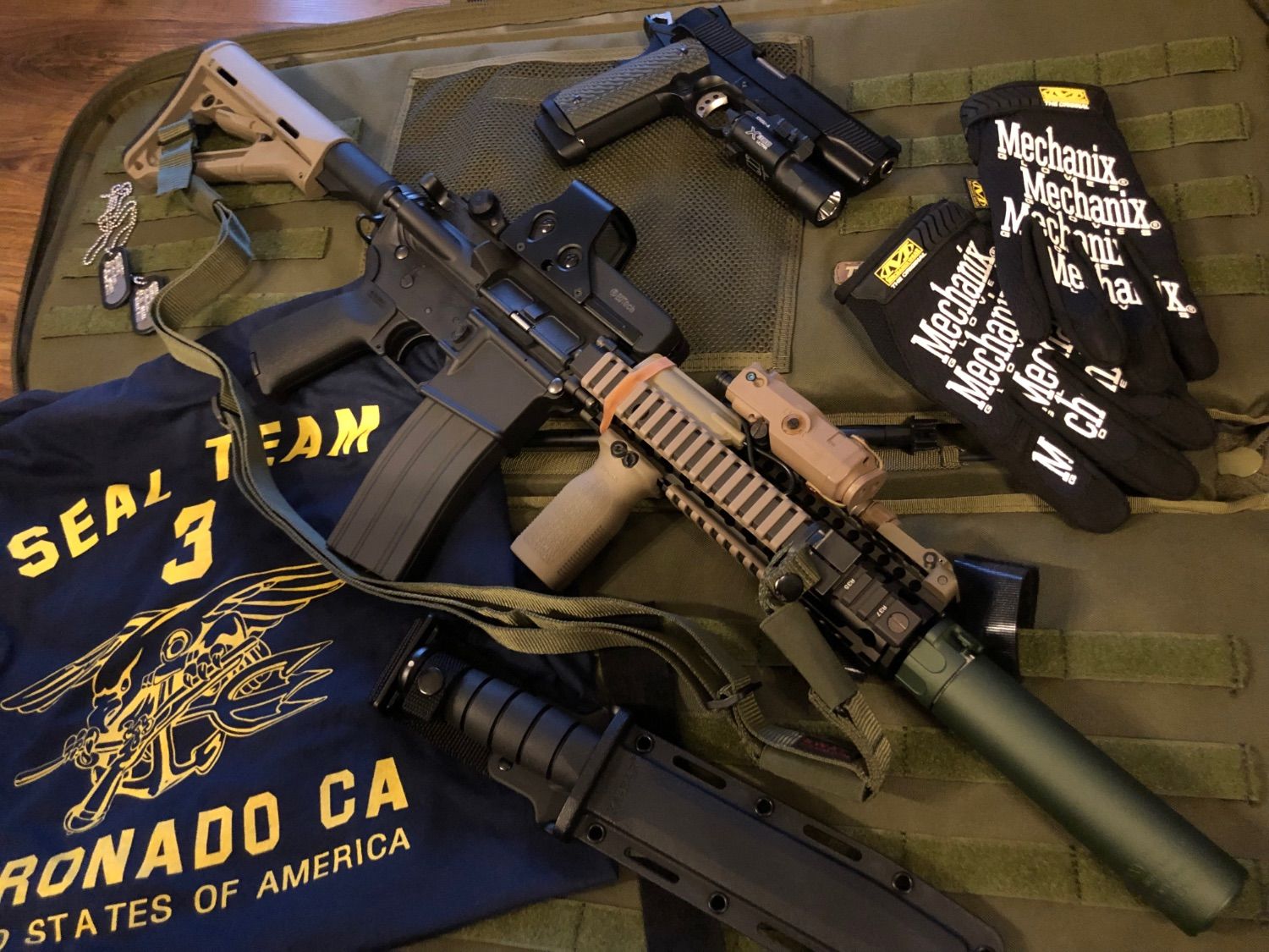

NoRo Posted July 1, 2022 Posted July 1, 2022 Here is my updated MK18, still waiting for the tan eotech 558.
