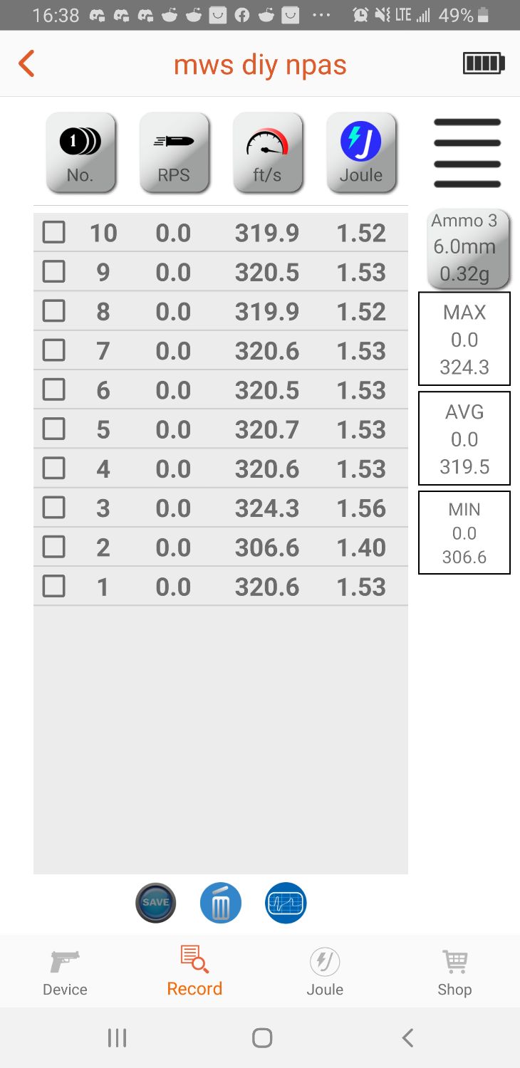

Hecker Posted May 18, 2023 Posted May 18, 2023 1 hour ago, JimFromHorsham said: @Heckeris your chrono set to MPS ? no fps mate
JimFromHorsham Posted May 18, 2023 Posted May 18, 2023 8 minutes ago, Hecker said: no fps mate then something is way off , I’d be taking a much closer look at your rifle and chrono settings .
Hecker Posted May 18, 2023 Posted May 18, 2023 18 minutes ago, JimFromHorsham said: then something is way off , I’d be taking a much closer look at your rifle and chrono settings . idk its very snappy and abbey ultra is supposed to be weaker than gg and propane ive done a complete strip down and nothings off, barrels been cleaned ive also replaced all the springs in the nozzle with a dytac set and its about the same maybe 3fps higher could be the bbs ive got im going to order up some bls bbs as ive run out of those atm and currently using valkens because thats all i can get atm
Davegolf Posted May 18, 2023 Posted May 18, 2023 7 hours ago, Hecker said: Hello would just like to say thanks for all your help you have helped me decide on purchasing a mws I love the gun and have had no issues with it apart from the receiver being gappy at the back and having casting seams which is a bif of a disappointment Ive watched a few of ollies vids and Ive short stroked it using 2 10p coins in the buffer which has removed possibility of denting on the reciver and buffer tube Im currently using abbey predator and im getting around 135 fps with 0.2 is this gas perfectly safe to use other than the nozzle spring breaking seen people get 113 fps on propane and green gas The idea of the coins in the buffer is to increase the spring preload, but this does not protect the buffer from shattering, that is why the HSB has a rubber pad in there.
JimFromHorsham Posted May 18, 2023 Posted May 18, 2023 11 minutes ago, Hecker said: idk its very snappy and abbey ultra is supposed to be weaker than gg and propane ive done a complete strip down and nothings off, barrels been cleaned ive also replaced all the springs in the nozzle with a dytac set and its about the same maybe 3fps higher could be the bbs ive got im going to order up some bls bbs as ive run out of those atm and currently using valkens because thats all i can get atm It’s 200fps off where it could be so somethings not quite right is it ? but if it’s nice and snappy and you are happy then so be it ??
Hecker Posted May 18, 2023 Posted May 18, 2023 (edited) 18 minutes ago, Davegolf said: The idea of the coins in the buffer is to increase the spring preload, but this does not protect the buffer from shattering, that is why the HSB has a rubber pad in there. it isnt to stop the buffer from shattering its so when the buffer bottoms out the rear screw of the gas key cant come in contact with the back of the receiver denting it! also it stops the wider sides of the bcg from making small dents on the front edge of the entrance of the buffer tube 15 minutes ago, JimFromHorsham said: It’s 200fps off where it could be so somethings not quite right is it ? but if it’s nice and snappy and you are happy then so be it ?? never herd of a mws doing 530 fps out the box on a gas comparable to gg Edited May 18, 2023 by Hecker JimFromHorsham 1
JimFromHorsham Posted May 18, 2023 Posted May 18, 2023 (edited) 7 minutes ago, Hecker said: it isnt to stop the buffer from shattering its so when the buffer bottoms out the rear screw of the gas key cant come in contact with the back of the bolt denting it! also it stops the wider sides of the bcg from making small dents on the front edge of the entrance of the buffer tube never herd of a mws doing 530 fps out the box on a gas comparable to gg you should probably read back what you’ve written earlier , and that may answer the question of why everyone thinks your gun is running low Edited May 18, 2023 by JimFromHorsham
Popular Post Hecker Posted May 18, 2023 Popular Post Posted May 18, 2023 (edited) fuck sake lol i thought i put 330 ? thanks i was wondering what people where going on about Edited May 18, 2023 by Hecker acrxil, JimFromHorsham, SSPKali and 2 others 5

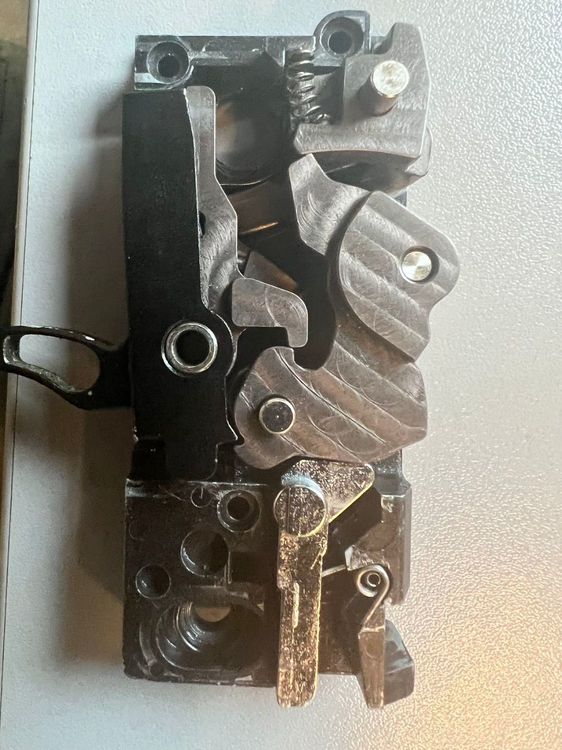

Koooo Posted May 19, 2023 Posted May 19, 2023 (edited) Hi everyone, facing a new problem during test fire my mws....The trigger can't always resset during fire (but can alwalys reset using hand), don't know it that because I lost the Trigger Shaft C Ring or other reason....大家好,我的 mws 在试射过程中遇到了一个新问题……跳跳虎在射击过程中不能总是复位,不知道是因为我丢失了扳机轴 C 环或其他原因…… 48a714e10e0af0c23c110342e8639f81.mp4 Edited May 19, 2023 by Koooo
SSPKali Posted May 20, 2023 Posted May 20, 2023 Trigger not resetting can be down to a few things: Lubrication - it needs lube but not too much or too thick. It will slow things down and attract dirt. I find locksmiths graphite spray ideal, very slick but not gloopy like oil or grease. The trigger spring puts a twisting force on the trigger that can cause it to rub the trigger box on opposite sides (front right, back left for example) I used some fine grade abrasive paper to polish these sides of the trigger to help reduce this. It is a while since I had the trigger apart so I can’t remember where the c clip goes!

Koooo Posted June 10, 2023 Posted June 10, 2023 Anyone have good condition spare complete lower for sale ? Also accept trigger box set. I believe my trigger sear is heavily damged even change different trigger can't reset well in the semi function
rj1986 Posted June 12, 2023 Posted June 12, 2023 On 10/06/2023 at 09:11, Koooo said: Anyone have good condition spare complete lower for sale ? Also accept trigger box set. I believe my trigger sear is heavily damged even change different trigger can't reset well in the semi function I have a virtually complete mk18 - only needs a new bolt body and nozzle clip
