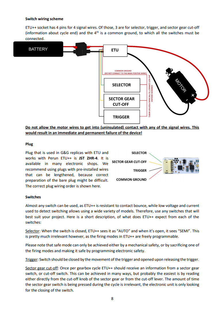

The original ETU - and by that I mean the Electronic Trigger Unit inside box
has one power/supply that is sent to all 3 original switches trigger, selector position & Cut Off Lever
so in the end the mosfet unit receives back 3 signals on/off from the 3 switches
which the mosfet/control unit then processes accordingly
the mag empty switch would I think basically kill or break/open the trigger circuit so it no longer fires
(or no longer sends a signal back to unit even if trigger is pulled coz mag switch has "opened" the circuit)
The selector plate in ETU guns are semi only - meaning the COL is always popping each cycle
or the selector plate has the extra material removed for a DMR mod
if you go back to old school then an ETU selector will need replacing for old school full auto to function

What you propose sounds like a lot of work when the Perun++ unit would be the easiest & sensible option
and be about same space as Nano-Hard
https://www.airsoftworld.net/perun-g-g-etu-upgrade-kit-programmable-drop-in-mosfet-deans.html
somewhere there is a 5% discount code too - lot easier solution
