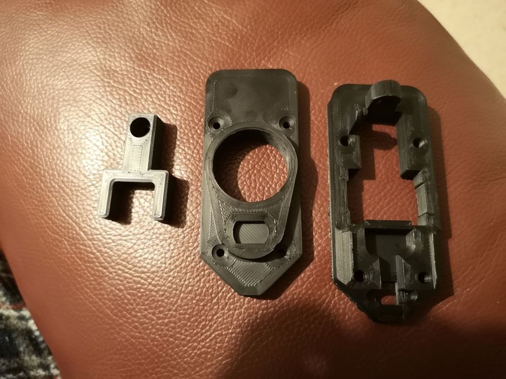

Speedbird_666 Posted July 27, 2021 Posted July 27, 2021 I see someone is flogging G&G Drop stock adapters for £25 a pop. Decided to design my own for my son's gun (he wears a paintball mask). Not quite as slick as their design, but an hour or so of CAD work gives me this. Prototype is on the printer now. Tackle and Enid_Puceflange 2

Speedbird_666 Posted July 28, 2021 Posted July 28, 2021 Job done. Perfect, tight fit first time (wasn't expecting that, hence the Red filament as I'm running low on black). Will print a black one shortly now I know the tolerances and fitment work. PopRocket123, GothicGhost and Rogerborg 1 2

Guest Mr. No_Face Posted July 29, 2021 Posted July 29, 2021 21 hours ago, Speedbird_666 said: Job done. Perfect, tight fit first time (wasn't expecting that, hence the Red filament as I'm running low on black). Will print a black one shortly now I know the tolerances and fitment work. The more I see this kind of stuff, the more I'm sold on the idea of getting a 3D printer. A few questions though. - Do you model and prep the parts yourself? - is the plastic sturdy or brittle? -what kind of printer are you using and how much does it retail.

Speedbird_666 Posted July 29, 2021 Posted July 29, 2021 1 hour ago, Mr. No_Face said: The more I see this kind of stuff, the more I'm sold on the idea of getting a 3D printer. A few questions though. - Do you model and prep the parts yourself? - is the plastic sturdy or brittle? -what kind of printer are you using and how much does it retail. To answer your questions: - Yes, I like to model the parts myself wherever possible, although you can find a fair bit of stuff on Thingiverse. I use Fusion 360 as my modelling software and Cura for slicing the model for print. If you want to design more 'organic' (such as your skull masks) I know people use software such as Z-brush and blender to produce the models, but I have no experience with these. - That's a difficult question to answer, as there are several main types of printable plastic (PLA, PETG and ABS), and numerous sub-variations with additives and special properties. I'm using PLA+, which is less brittle than normal PLA, but at the cost of some mechanical strength. Normal PLA will catastrophically fail (i.e. snap or shear) , PLA+ is more likely to bend and stretch. In the example of my drop-stock adapter, it's been printed in the least-optimal way for strength (the receiver extension for the buffer tube could potentially fail under enough force) due to the way that a printer lays down plastic layers on top of each other, but it was easiest to print it that way. In reality, the adapter feels more solid that the plastic G&G receiver it's attached to and there is zero flex, but time will tell. I have an idea for the next version to make it a 2-piece design that means that the receiver stub will be printed in a different orientation to the rest of the adapter. Current design print layer direction vs 2-piece design: - I'm using a Creality Ender 3 V2 bought directly from the Creality UK warehouse. It was on sale for £168 with free postage, but I think the price is back up to around £200 now. I'm running it pretty much stock with no upgrades other than a quieter fan for the PSU and yellow bed springs. I plan to add BLtouch (self leveling sensor) and some new bowden tubing at some point soon though.
PopRocket123 Posted July 29, 2021 Posted July 29, 2021 2 hours ago, Speedbird_666 said: To answer your questions: - Yes, I like to model the parts myself wherever possible, although you can find a fair bit of stuff on Thingiverse. I use Fusion 360 as my modelling software and Cura for slicing the model for print. If you want to design more 'organic' (such as your skull masks) I know people use software such as Z-brush and blender to produce the models, but I have no experience with these. - That's a difficult question to answer, as there are several main types of printable plastic (PLA, PETG and ABS), and numerous sub-variations with additives and special properties. I'm using PLA+, which is less brittle than normal PLA, but at the cost of some mechanical strength. Normal PLA will catastrophically fail (i.e. snap or shear) , PLA+ is more likely to bend and stretch. In the example of my drop-stock adapter, it's been printed in the least-optimal way for strength (the receiver extension for the buffer tube could potentially fail under enough force) due to the way that a printer lays down plastic layers on top of each other, but it was easiest to print it that way. In reality, the adapter feels more solid that the plastic G&G receiver it's attached to and there is zero flex, but time will tell. I have an idea for the next version to make it a 2-piece design that means that the receiver stub will be printed in a different orientation to the rest of the adapter. Current design print layer direction vs 2-piece design: - I'm using a Creality Ender 3 V2 bought directly from the Creality UK warehouse. It was on sale for £168 with free postage, but I think the price is back up to around £200 now. I'm running it pretty much stock with no upgrades other than a quieter fan for the PSU and yellow bed springs. I plan to add BLtouch (self leveling sensor) and some new bowden tubing at some point soon though. I use real steel buffer tubes threaded into my printed components instead of AEG buffer tubes. That way you can print it all flat and not have to worry about that fracture point. It does make things a little bulkier though. Speedbird_666 1
Speedbird_666 Posted July 29, 2021 Posted July 29, 2021 1 hour ago, PopRocket123 said: I use real steel buffer tubes threaded into my printed components instead of AEG buffer tubes. That way you can print it all flat and not have to worry about that fracture point. It does make things a little bulkier though. That's a really good idea! Do you print the threading or tap it after printing? What thread is the buffer tube?
PopRocket123 Posted July 29, 2021 Posted July 29, 2021 39 minutes ago, Speedbird_666 said: That's a really good idea! Do you print the threading or tap it after printing? What thread is the buffer tube? It's all printed. I can't remember the thread exactly, I think it's something like 13/16th of an inch but you can find it online. You can get real steel buffer tubes for about a tenner off of AliExpress, cheapest place I found. When you draw it up you need to scale the threads up ever so slightly so that they don't bind up Speedbird_666 1

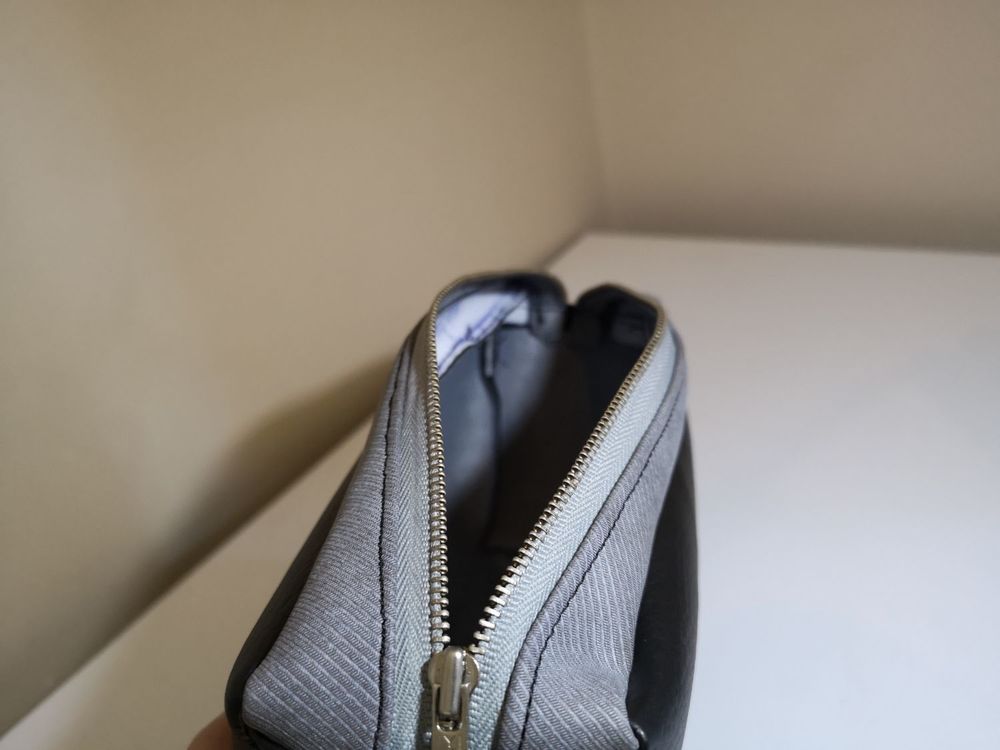

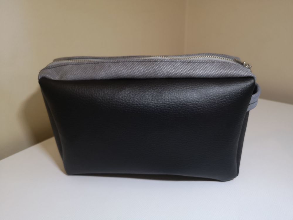

PopRocket123 Posted July 30, 2021 Posted July 30, 2021 Not exactly airsoft related but doing this little project I think has given me the confidence I need to try some of the Airsoft sewing projects I've put off. It helped that I've finally found a sewing machine that doesn't fill me with frustration and hate. Lozart 1

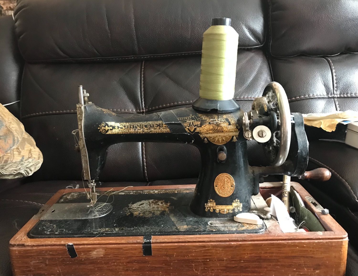

Supporters Druid799 Posted July 30, 2021 Supporters Posted July 30, 2021 8 hours ago, PopRocket123 said: Not exactly airsoft related but doing this little project I think has given me the confidence I need to try some of the Airsoft sewing projects I've put off. It helped that I've finally found a sewing machine that doesn't fill me with frustration and hate. I do all my sewing with this 134yr old antique . BigStew, PopRocket123 and Tackle 3
