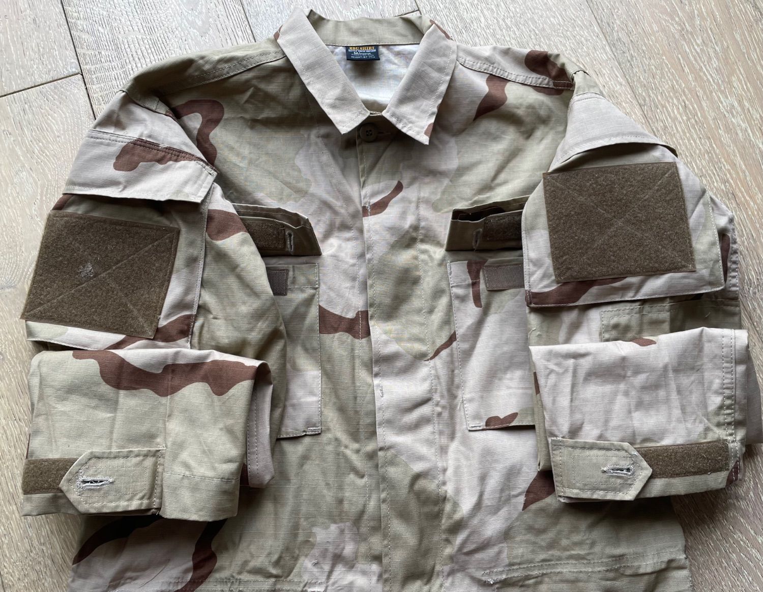

Popular Post SSPKali Posted August 14, 2022 Popular Post Posted August 14, 2022 Raid modded my Helikon BDU shirt. Wrist adjuster and chest pocket buttons replaced with velcro. Lower pockets removed and large loop velcro patches added. These were then attached to the upper arms. Also bar tacked over a small rip. Quite a productive afternoon given how bleedin’ hot it was! Coyote brown velcro from ContactLeft (Ebay) and Gutterman thread (colour 208 - from Amazon) Wavey_Gravey, Tactical Pith Helmet, Jacob Wright and 3 others 2 1 3

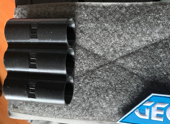

Popular Post Speedbird_666 Posted August 17, 2022 Popular Post Posted August 17, 2022 Mk5 Thunderflash holder to go on the front of my chest rig. Velcro backed - it'll have a loop of shock cord to provide tension. TheFull9, Clanktank, PopRocket123 and 3 others 6

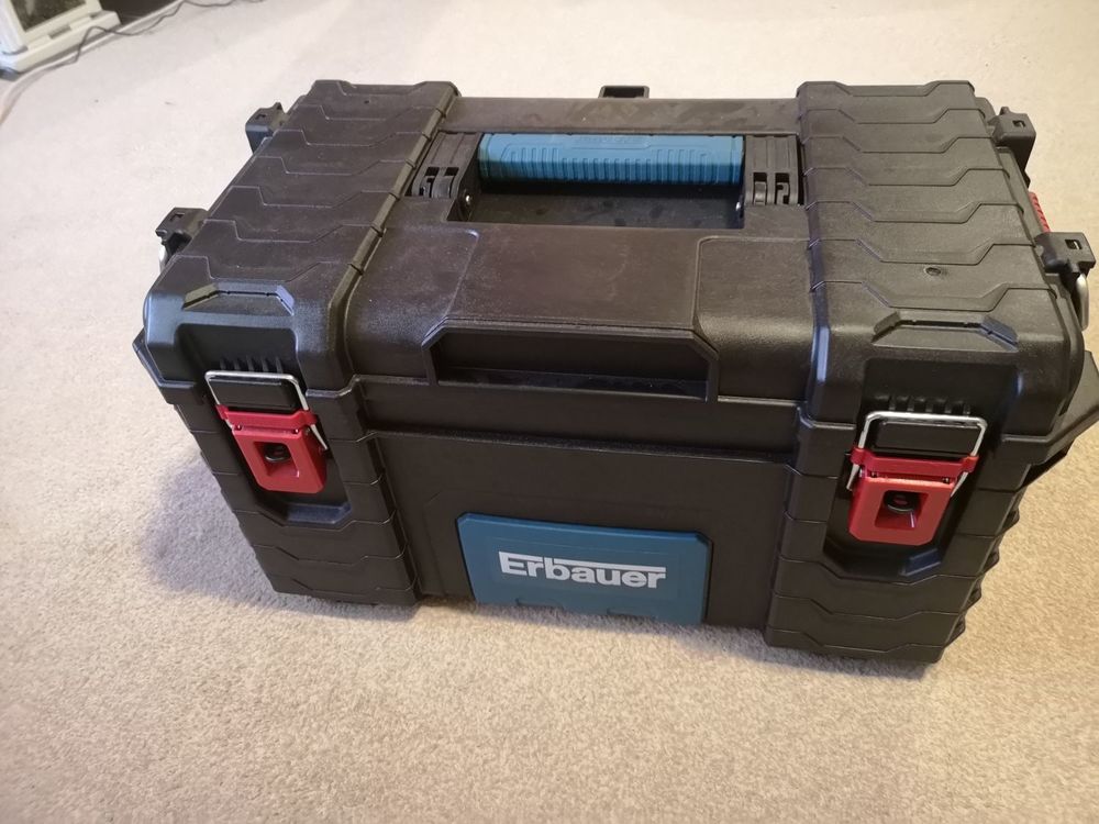

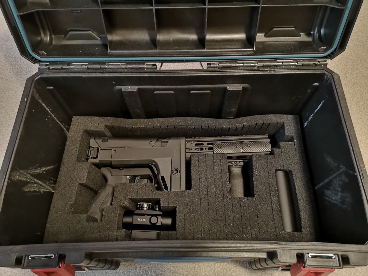

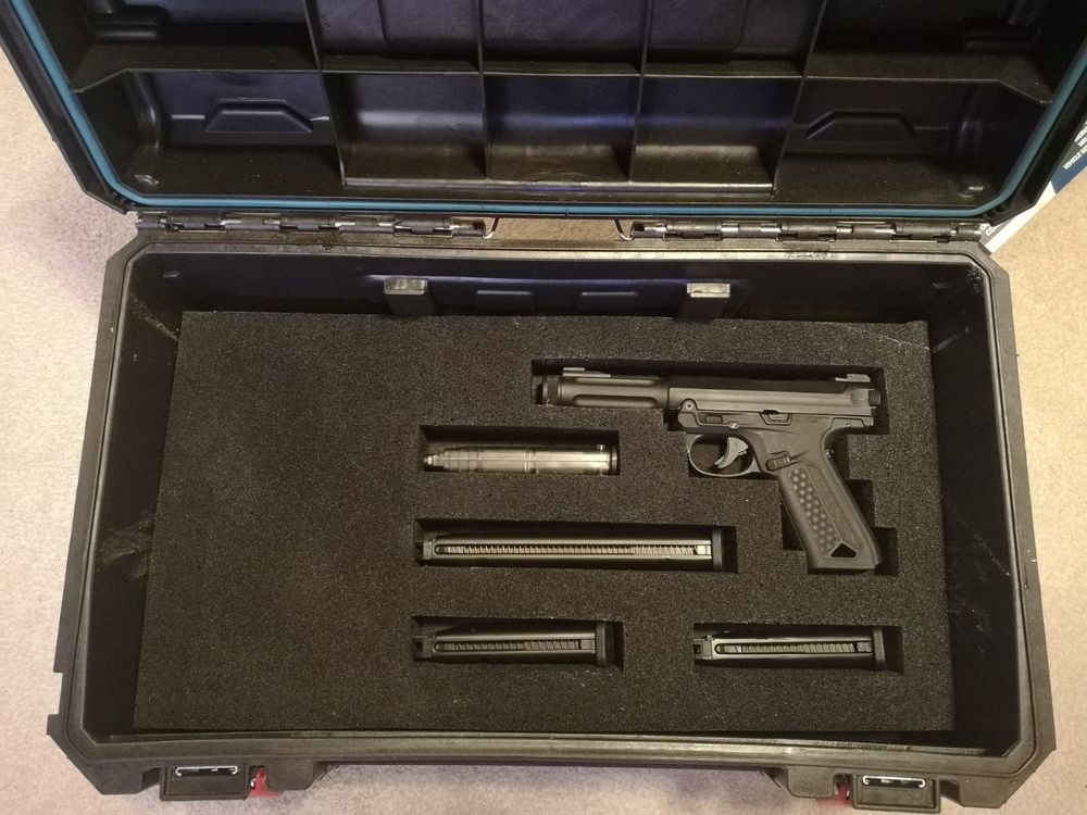

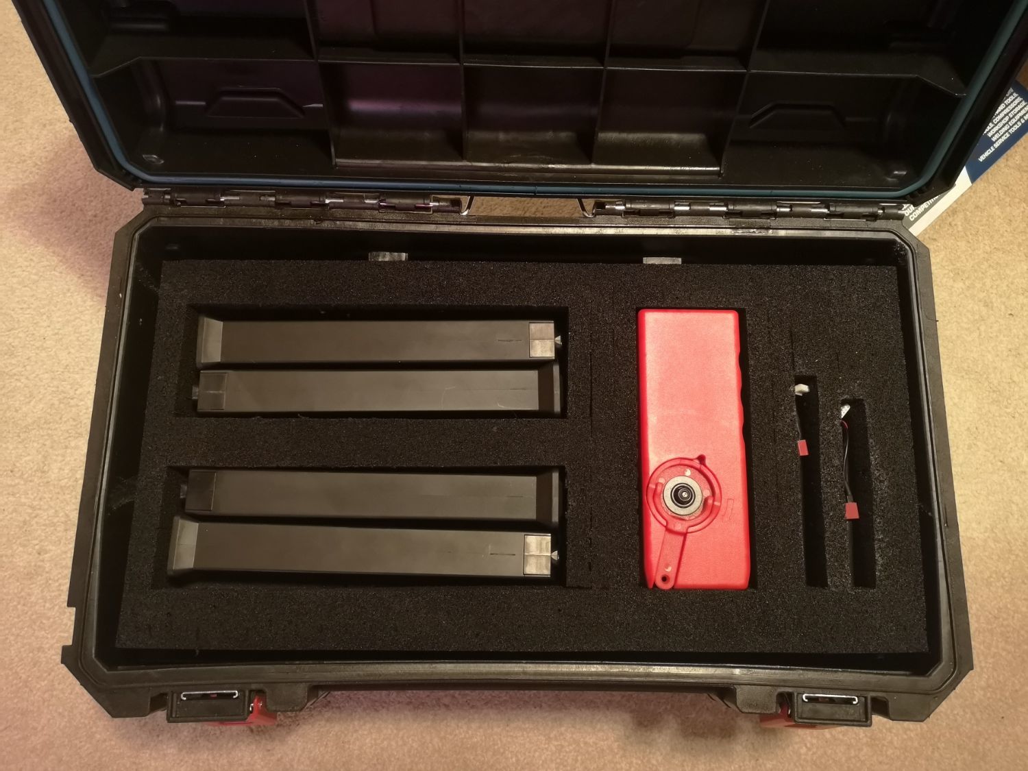

Popular Post Stevobeavo Posted August 22, 2022 Popular Post Posted August 22, 2022 decided to make my own gun case. It's not the neatest but it works. Bought a tool box from b&q, hardboard, pick and pluck foam and a few cans of plasti dip. I made it three layers with the bottom one glued to the base of the box. With the pistol layer I can pick the foam out for other attachments if needed and just plasti dip that section again to firm it up. All the layers also have foam under each piece of equipment. Madhouse, Akuma121, GothicGhost and 7 others 5 5

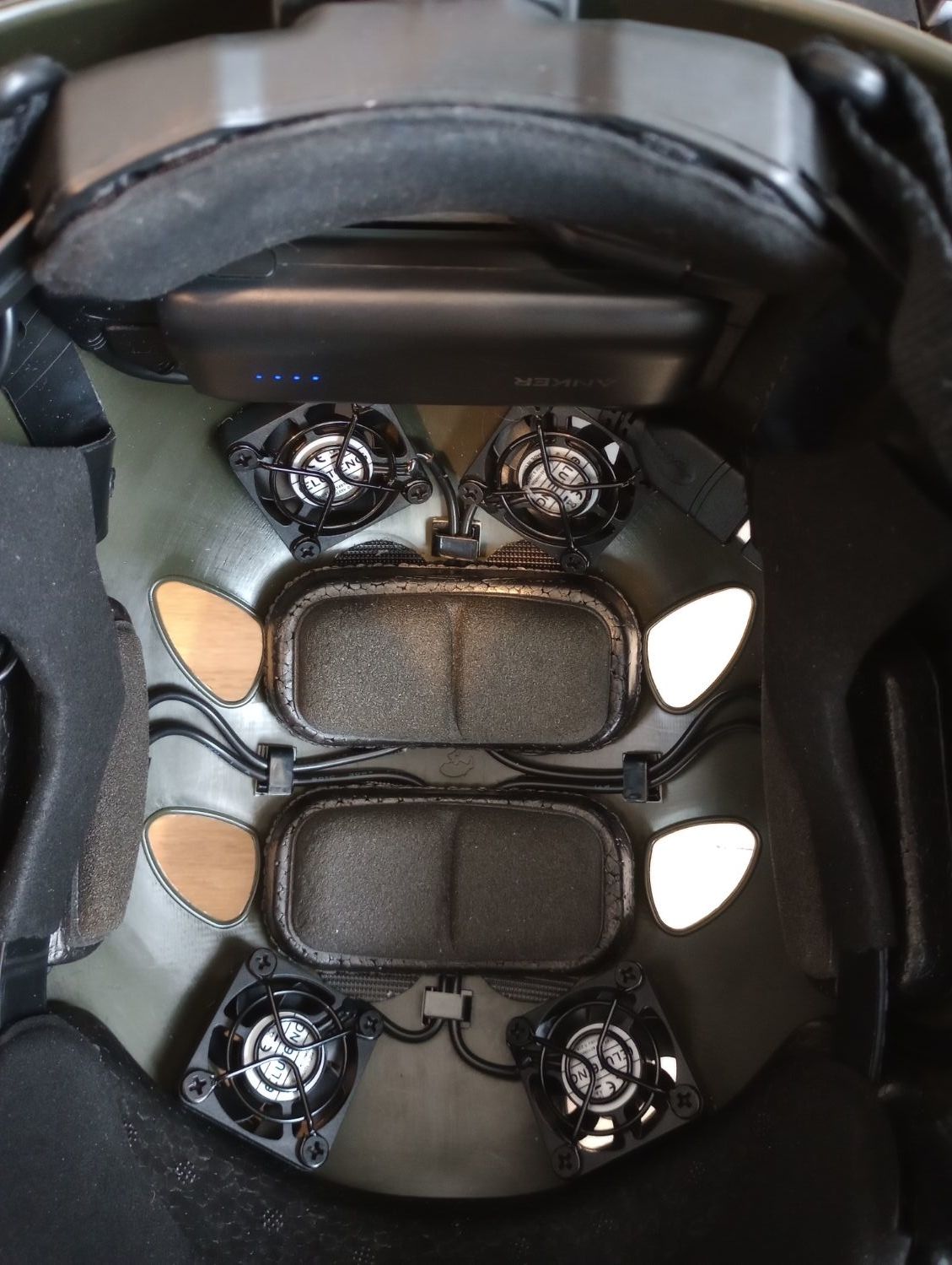

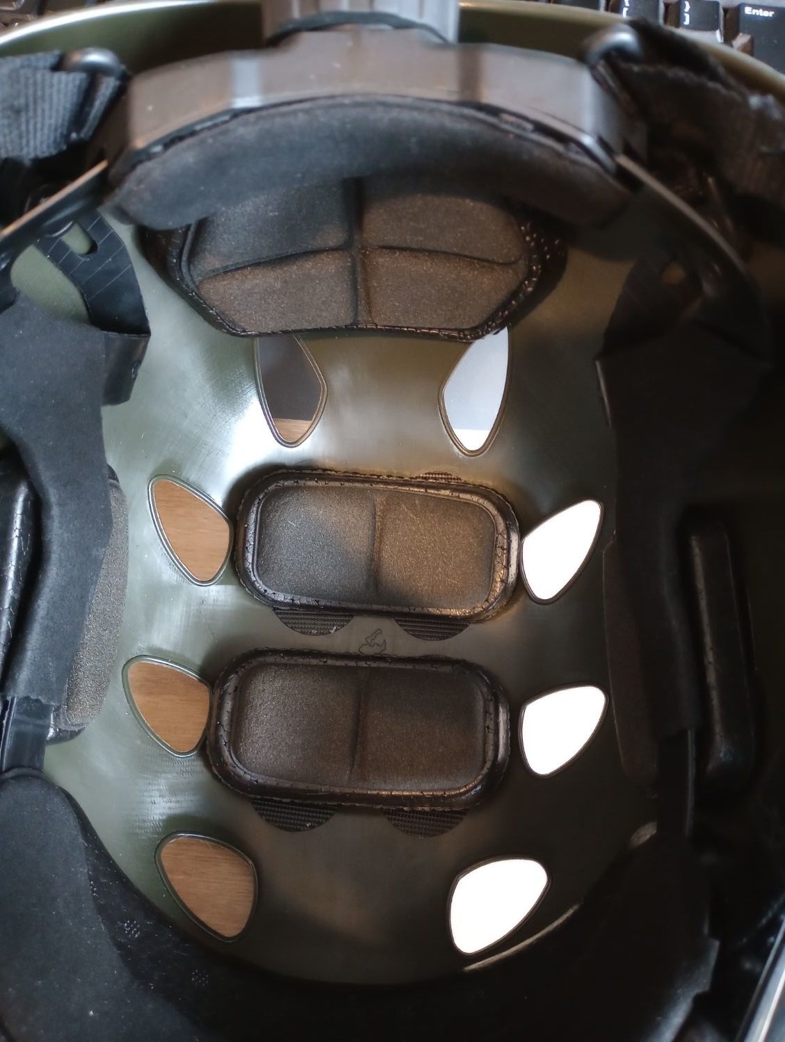

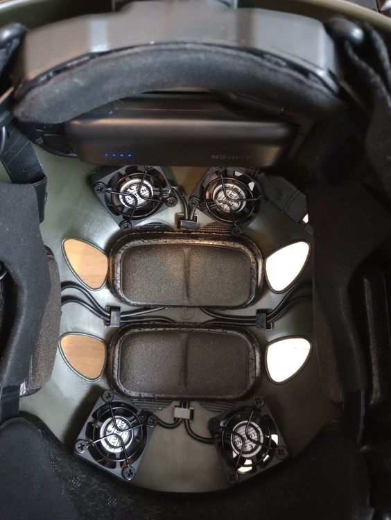

Popular Post Alvin Posted September 9, 2022 Popular Post Posted September 9, 2022 Added some fans to my helmet. Beep boop. Will see how it goes. GothicGhost, PopRocket123, Tackle and 3 others 5 1
Supporters Rogerborg Posted September 10, 2022 Supporters Posted September 10, 2022 21 hours ago, Alvin said: Added some fans to my helmet Ooh, noise! I mean, nice!

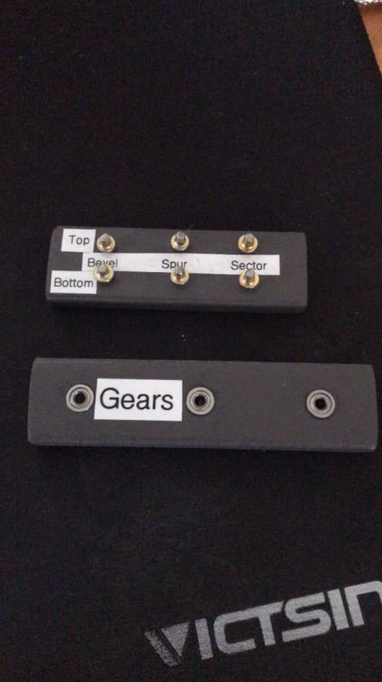

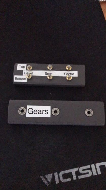

Popular Post Clanktank Posted September 11, 2022 Popular Post Posted September 11, 2022 Some gear and shim holders for when the gearbox is in bits. Made from old bearings, brass hook stubs, and some wood offcuts. Can't have them lying around and getting mixed up. ? Akuma121, Khyber, RostokMcSpoons and 2 others 5

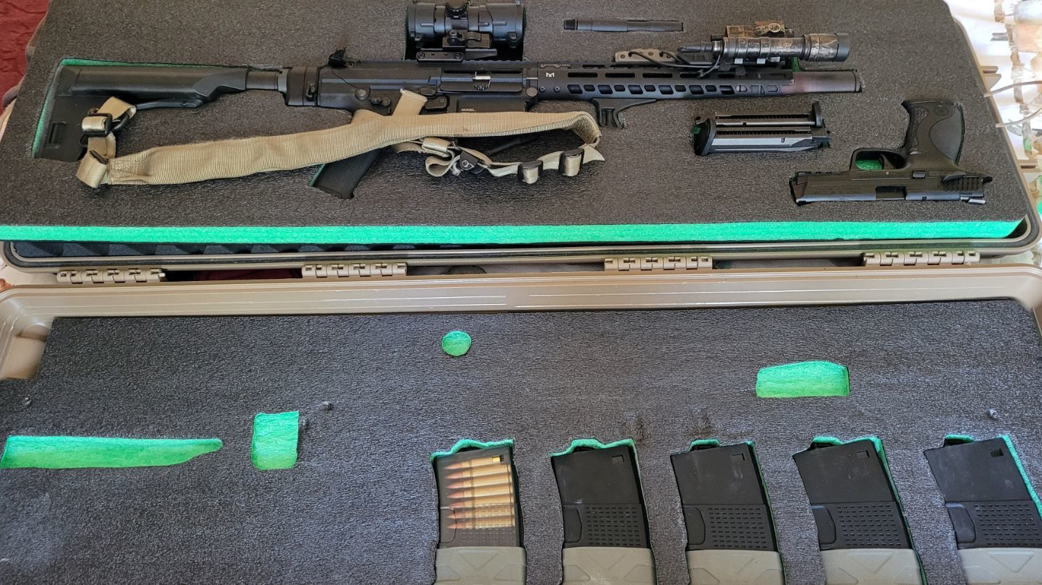

Popular Post Skullchewer Posted October 2, 2022 Popular Post Posted October 2, 2022 Got some Shadow Foam from Airsoft Anonymous. For the top layer of the extra large case I bought some velcro straps from Amazon, cut slots for them then glued the whole thing into the lid with a strong foam adhesive. I have a foam layer that sits in the middle when the case is shut. Decided to try something fancy for the other lid. The triskelion came out a bit wonky, but overall I'm very happy. Lozart, RostokMcSpoons, JimFromHorsham and 2 others 5

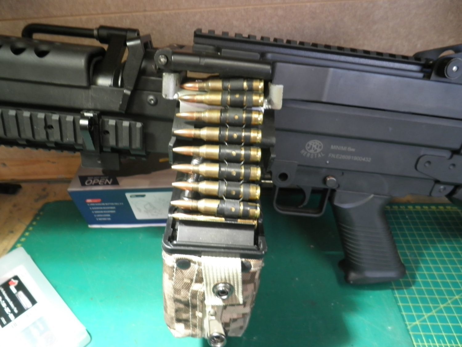

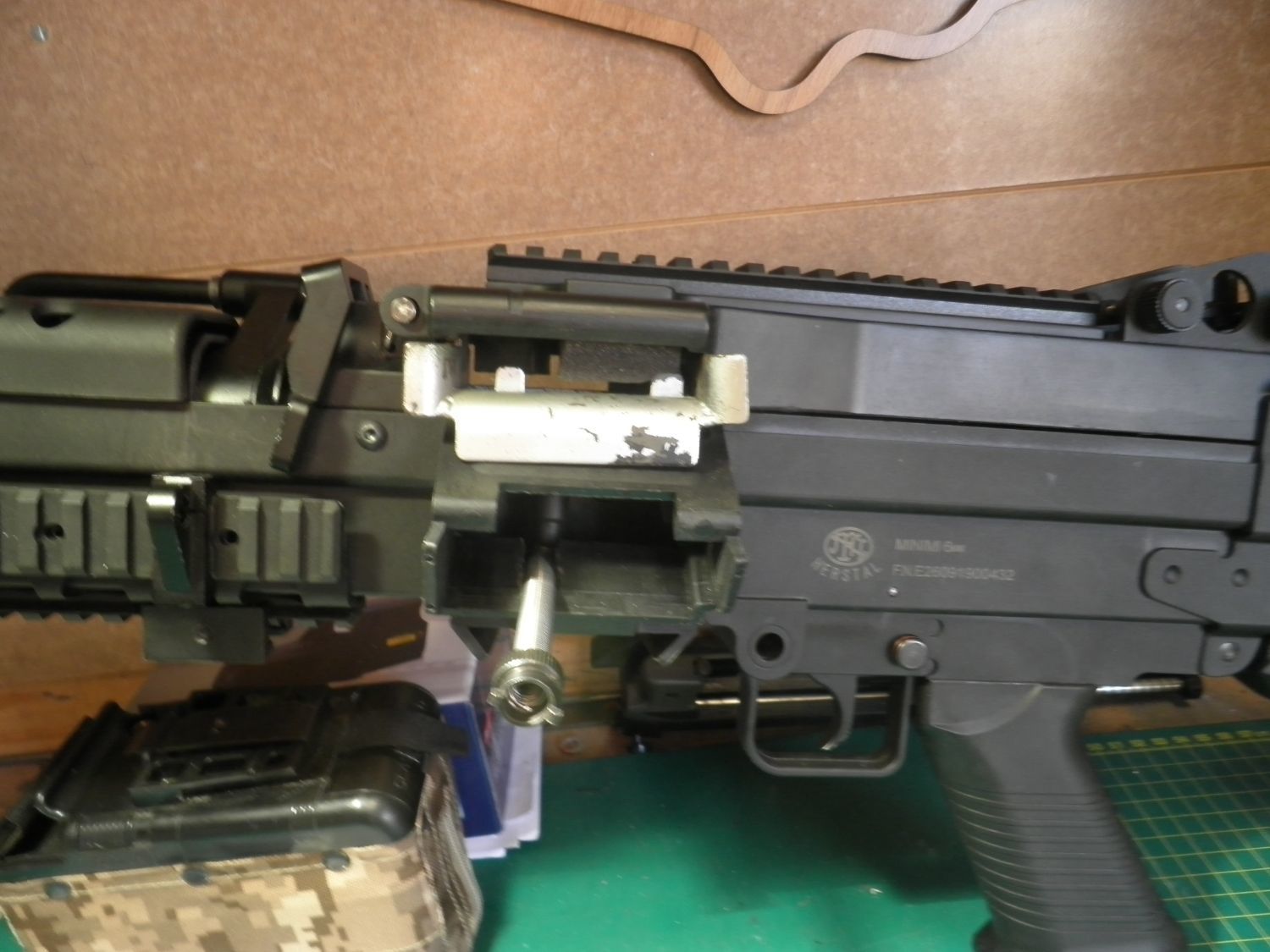

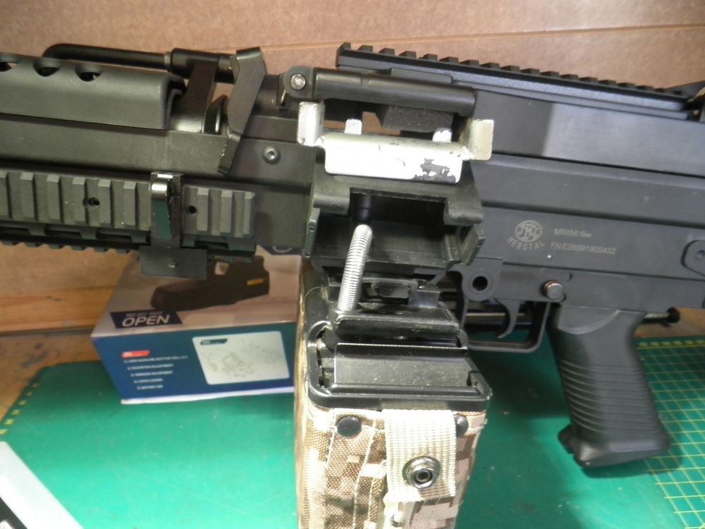

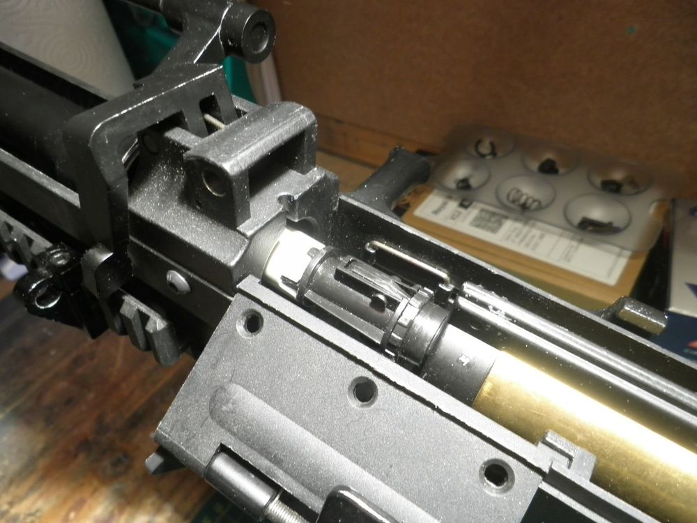

Nick G Posted October 16, 2022 Posted October 16, 2022 (edited) A build in progress. Transplanting an AUG hop unit into my S&T M249. I've had feeding issues and low power in it right from day one so decided to try this before I retire and replace it. More work to do yet, but as of today I've got it feeding and the power level is up. I fitted an adjustable nozzle which I'll need to dial in fully yet. Planning to give it a shake down at the next game day to see how it performs. Edited October 16, 2022 by Nick G Tactical Pith Helmet and Tackle 2

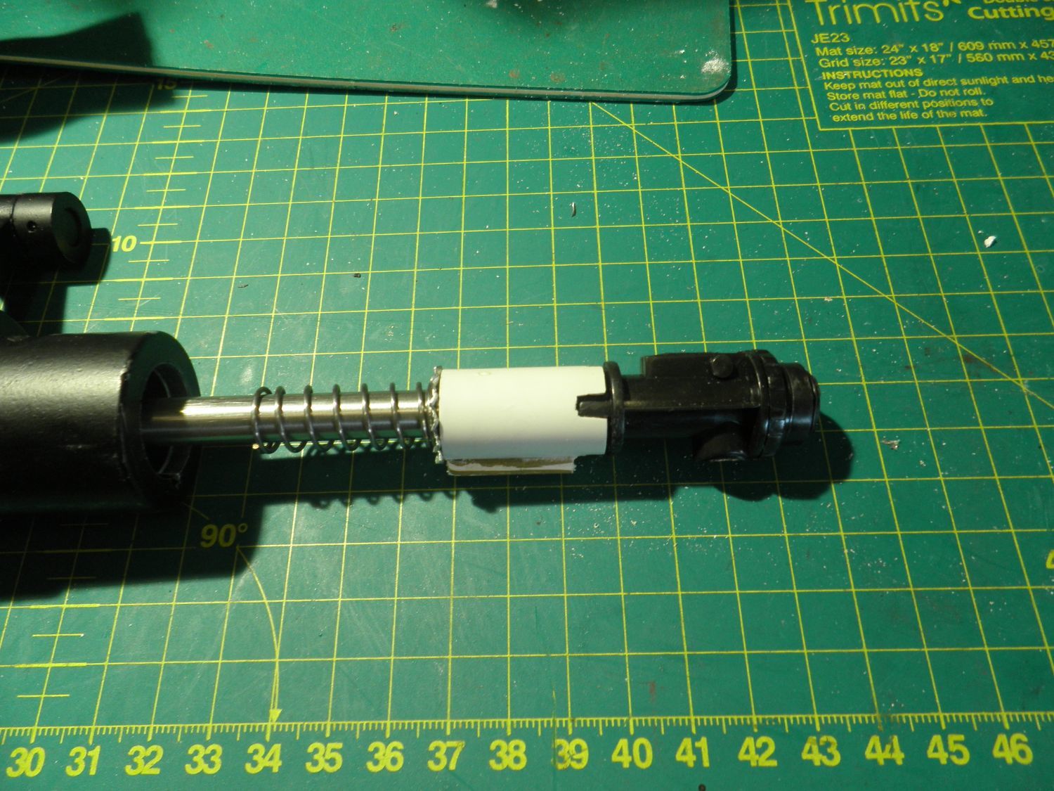

Nick G Posted October 17, 2022 Posted October 17, 2022 BB feed now in place, by opting for a side feed I can use my existing Classic Army box mag, which handily has a quick release for the feed. Sits behind the bullet belt nicely. Tried it today in a mate's orchard and it feeds fine and was hopping .25's with plenty of adjustment stil available. Now it's feeding I'll play with the nozzle and find the longest length that will still feed. At the moment it's set at a conservative length. It's getting there.
