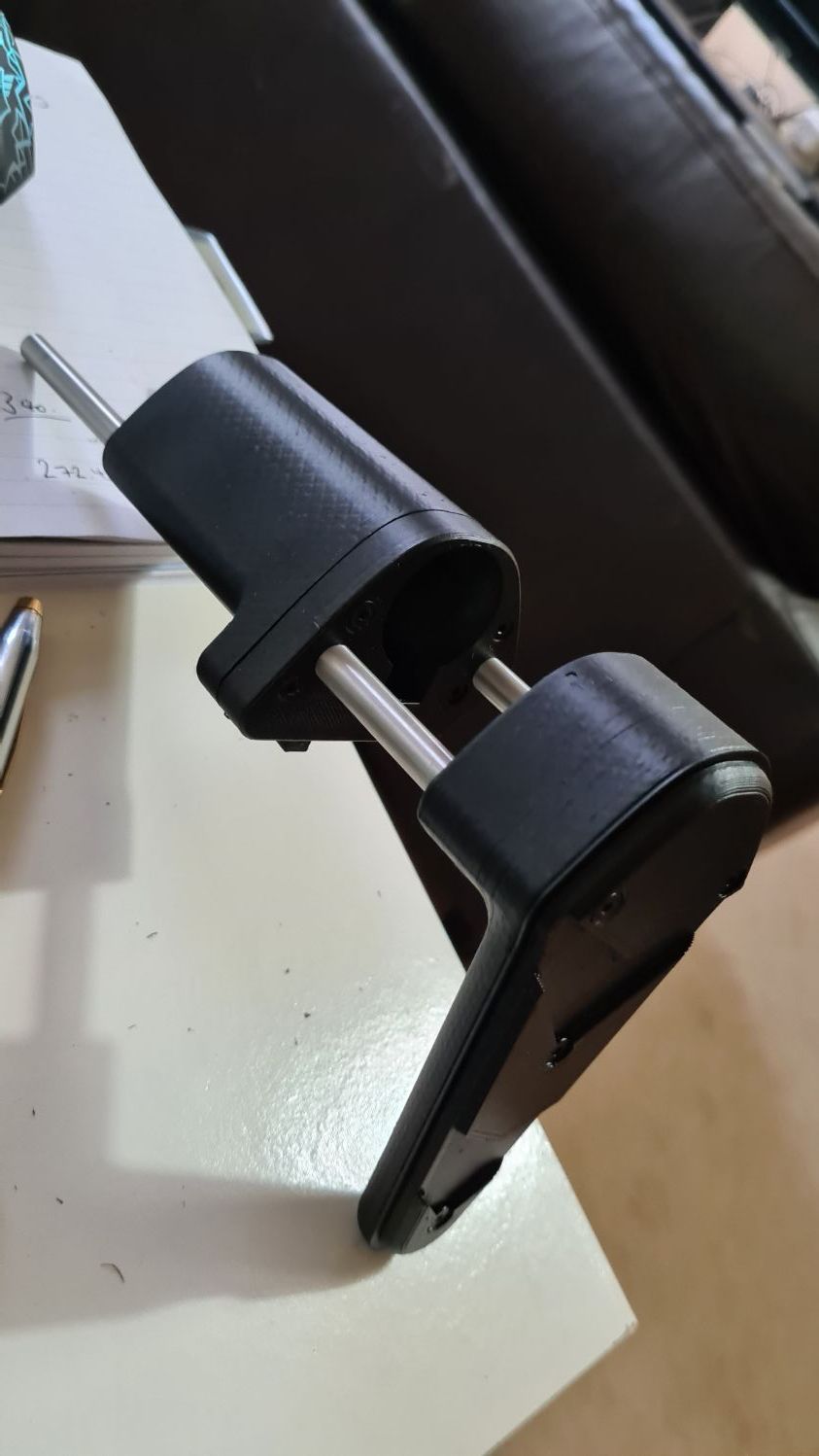

Guest Justjay1986 Posted January 14, 2021 Posted January 14, 2021 Work in progress pdw stock for my ghk g5.... Still a bit to go.

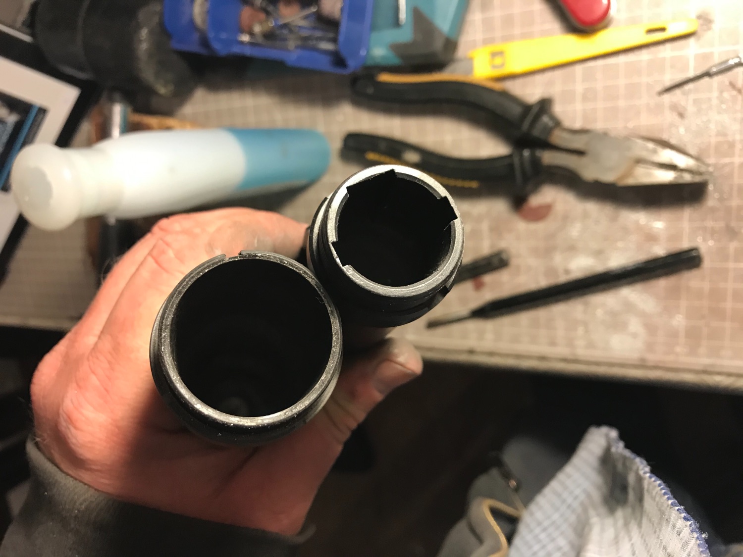

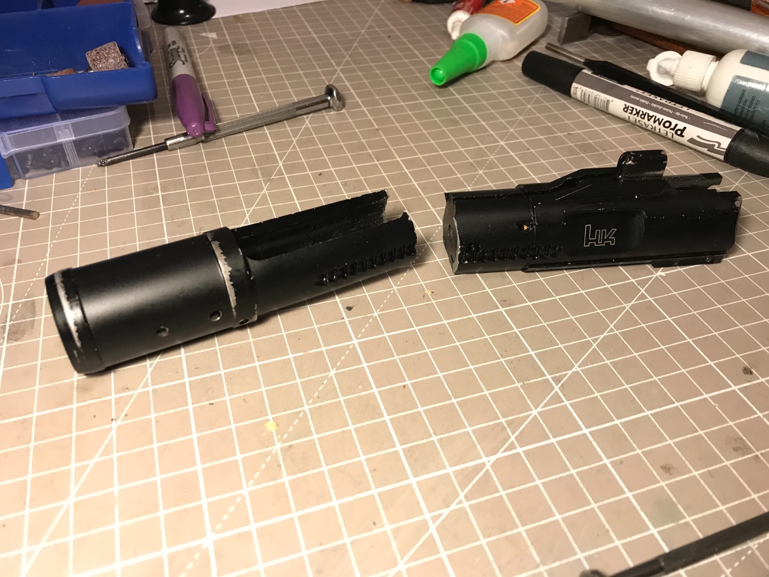

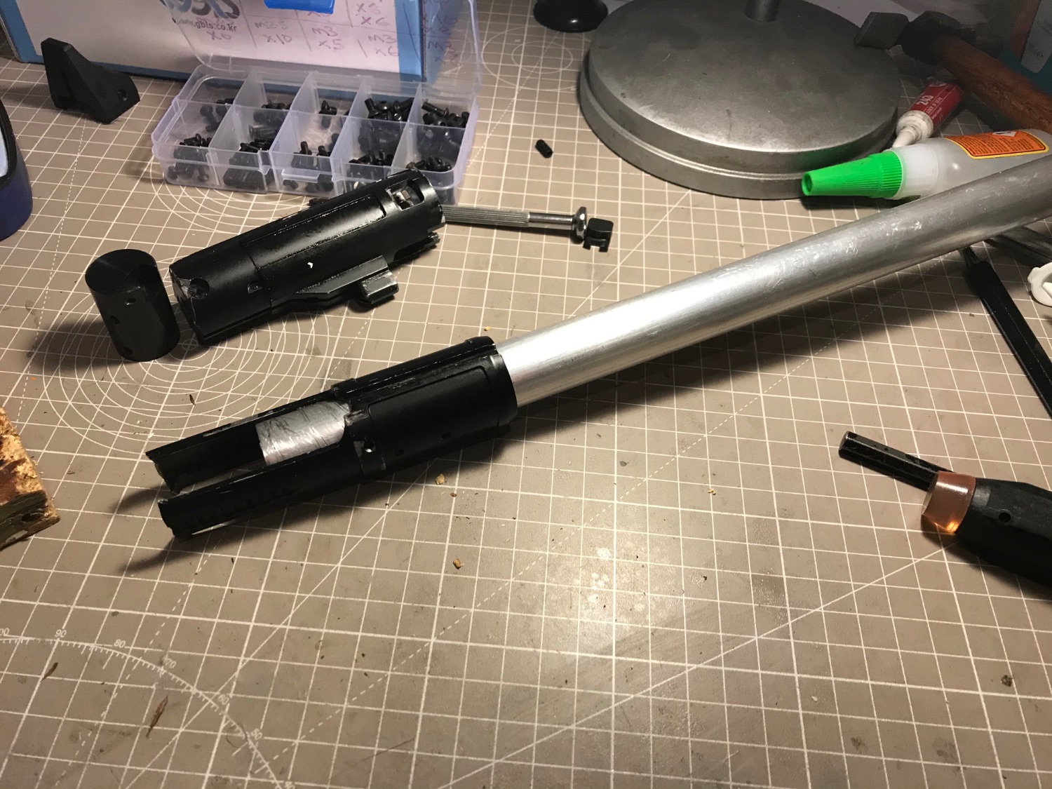

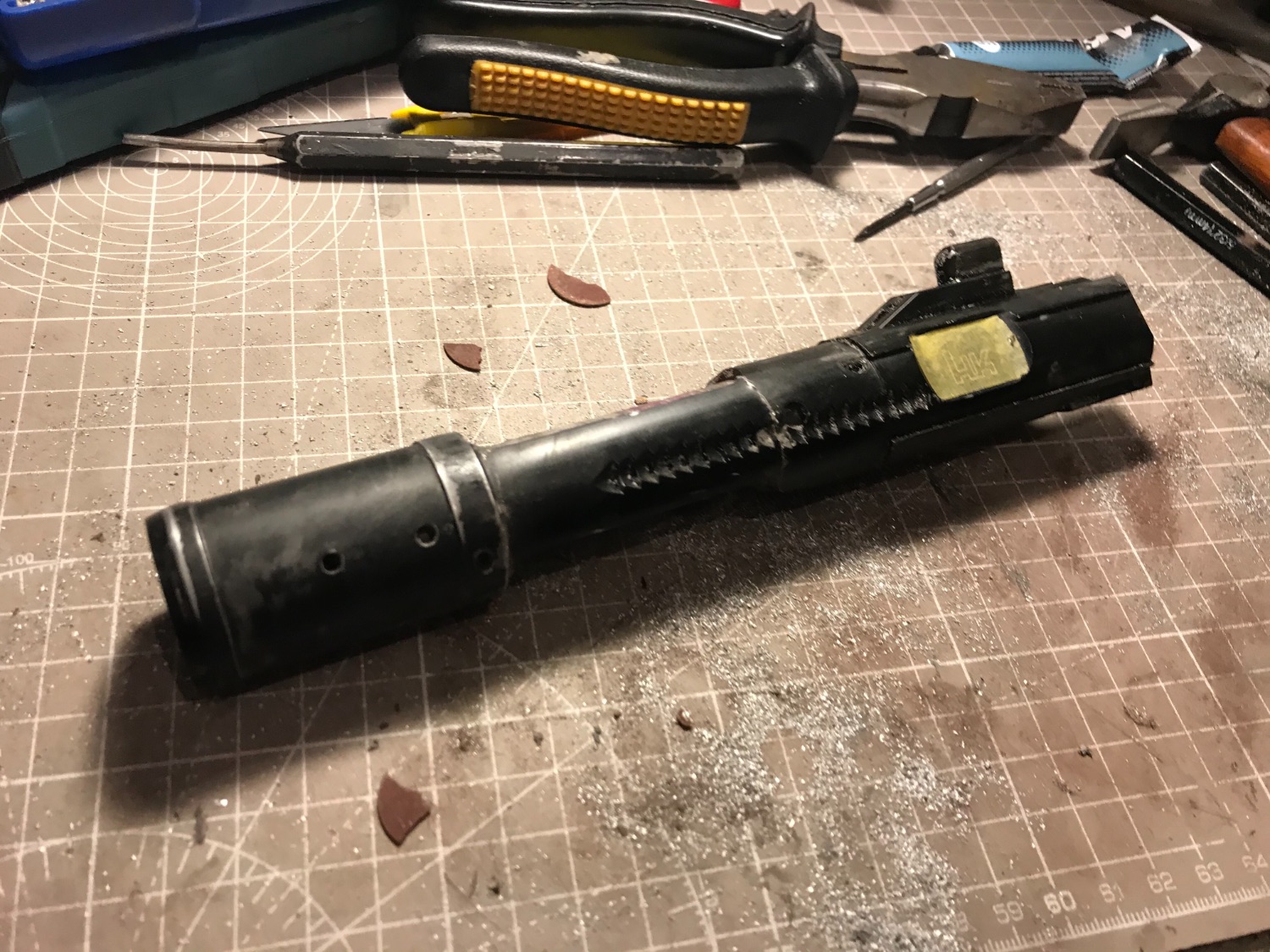

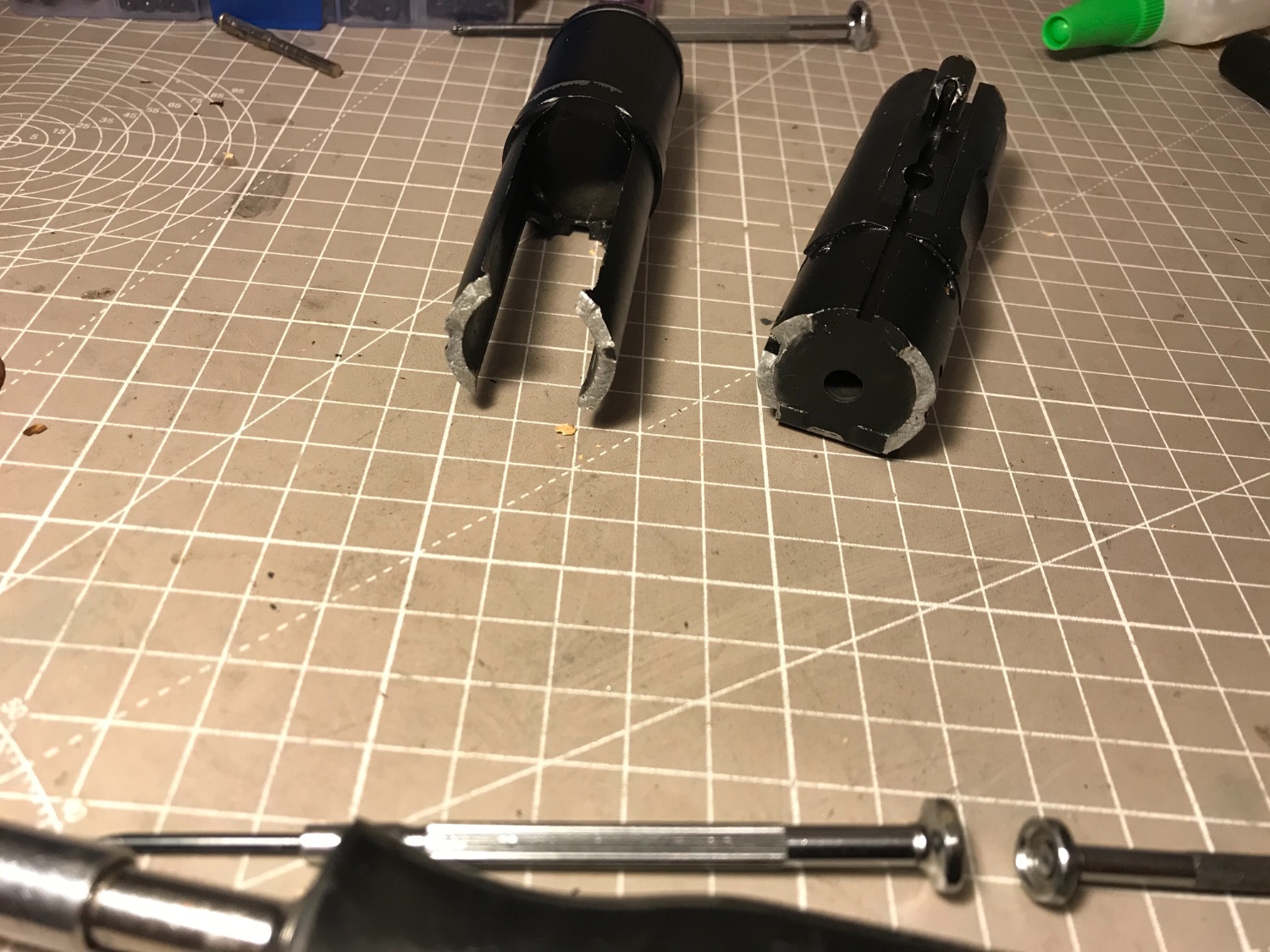

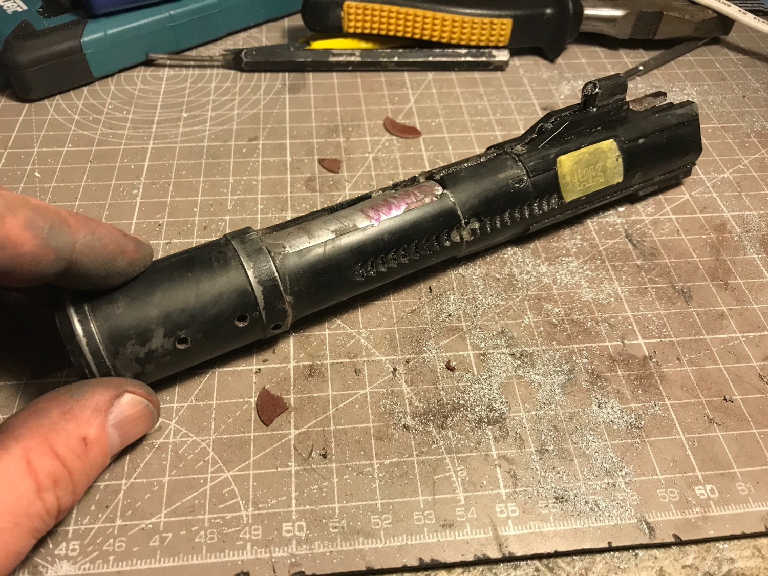

Guest Posted January 14, 2021 Posted January 14, 2021 Tonight, I’m part way through repairing a KWA HK 417 GBB BCG. Have you seen the size of a 417 buffer tube ?? FullSizeRender.mov
GenuineGerman Posted January 14, 2021 Posted January 14, 2021 7 minutes ago, rocketdogbert said: Tonight, I’m part way through repairing a KWA HK 417 GBB BCG. Have you seen the size of a 417 buffer tube ?? FullSizeRender.mov How did you repair the bolt?
Guest Posted January 14, 2021 Posted January 14, 2021 1 minute ago, GenuineGerman said: How did you repair the bolt? Not finished yet, I need to finesse it tomorrow, but essentially put a machined aluminium tube inside it, Dremel’d out some slots to get the tube to site square. Grub screws to properly secure it tomorrow, it’s currently epoxied.
GenuineGerman Posted January 14, 2021 Posted January 14, 2021 Just now, rocketdogbert said: Not finished yet, I need to finesse it tomorrow, but essentially put a machined aluminium tube inside it, Dremel’d out some slots to get the tube to site square. Grub screws to properly secure it tomorrow, it’s currently epoxied. That is a great idea ?. I would have been thinking about getting the welder on it or profiling a new one. But that is a much better/easier way of doing it. Thanks for sharing
Guest Posted January 14, 2021 Posted January 14, 2021 2 minutes ago, GenuineGerman said: That is a great idea ?. I would have been thinking about getting the welder on it or profiling a new one. But that is a much better/easier way of doing it. Thanks for sharing NP, should hold up better than the original pot metal lol

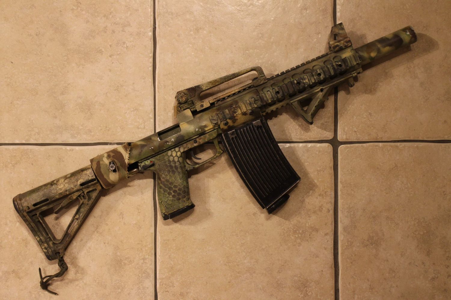

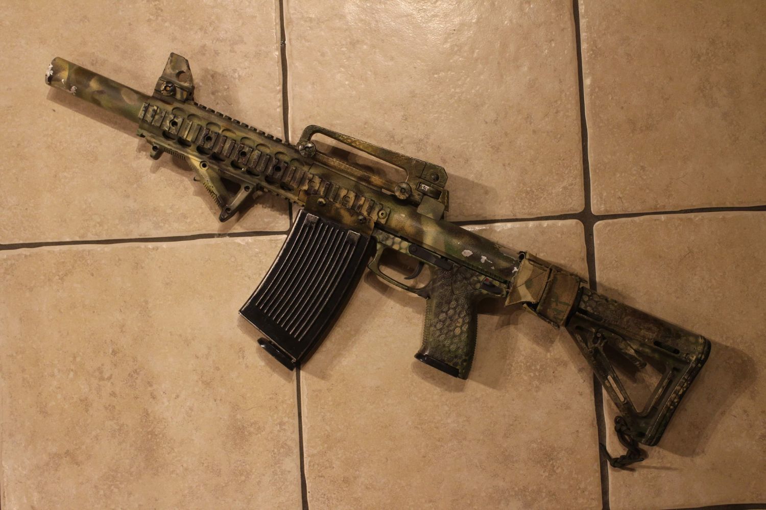

heroshark Posted January 14, 2021 Posted January 14, 2021 Not a recent project but revisiting and perfecting. Ghost_86 and Druid799 2
Supporters Adolf Hamster Posted January 14, 2021 Supporters Posted January 14, 2021 Thats a, umm, what is it exactly? I can see a mk23, some m4 bits and i a magazine i feel i should recognise but dont.
Guest DrAlexanderTobacco Posted January 14, 2021 Posted January 14, 2021 14 minutes ago, Adolf Hamster said: Thats a, umm, what is it exactly? I can see a mk23, some m4 bits and i a magazine i feel i should recognise but dont. 25 round MG.13 magazine, looks like it can also fit Gewehr 41s
Supporters Adolf Hamster Posted January 14, 2021 Supporters Posted January 14, 2021 7 minutes ago, DrAlexanderTobacco said: 25 round MG.13 magazine, looks like it can also fit Gewehr 41s Damnit, that was one that i thought it was but was like "nahh cant be an mg13 mag"
heroshark Posted January 15, 2021 Posted January 15, 2021 Mag is just bolted on it quite nicely holds an mk23 mag. It's mainly aluminium tube. Afg works as a cocking handle.

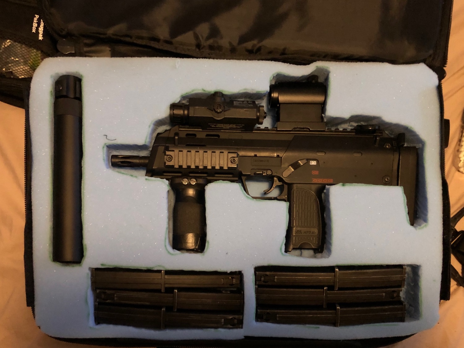

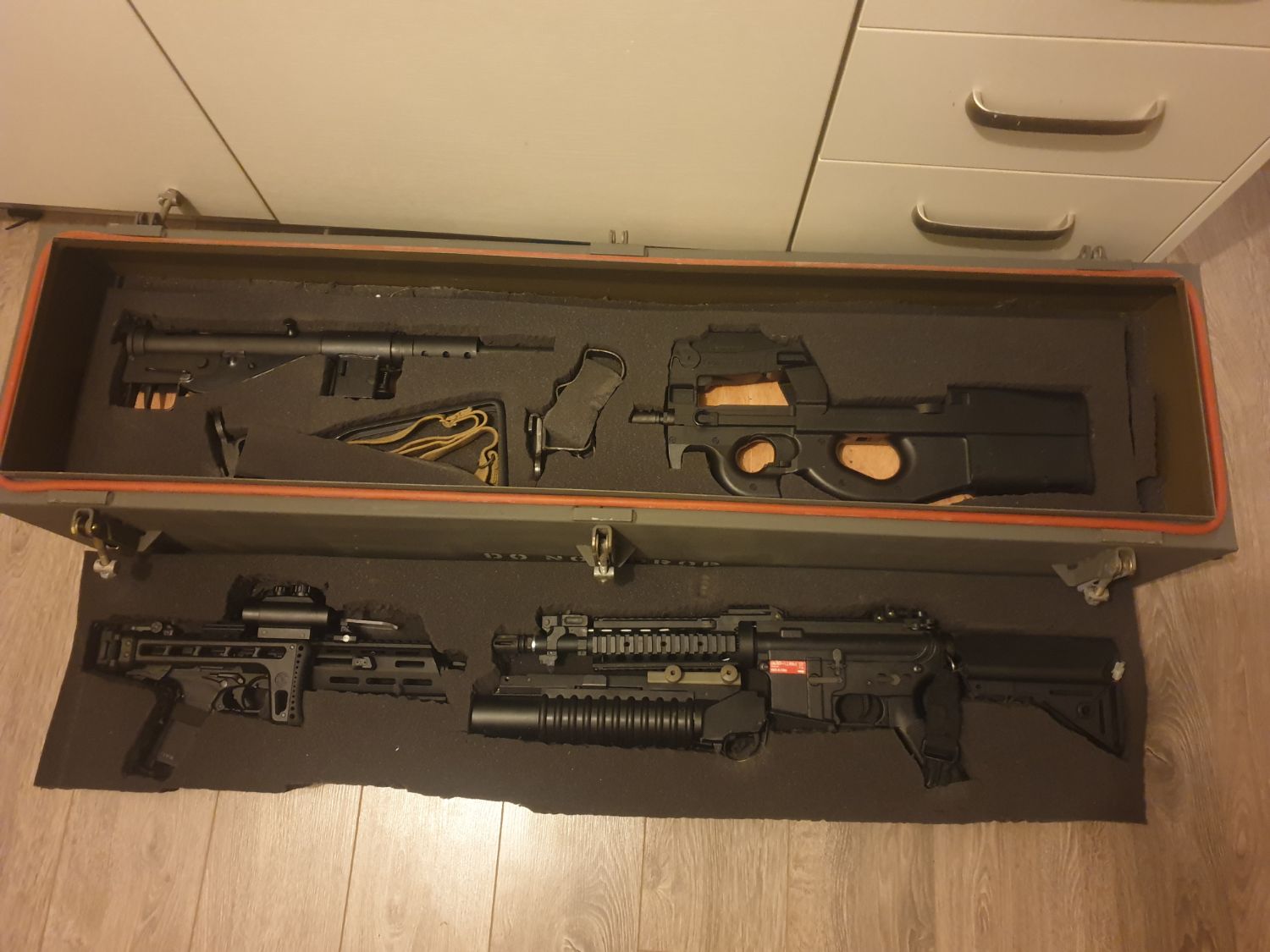

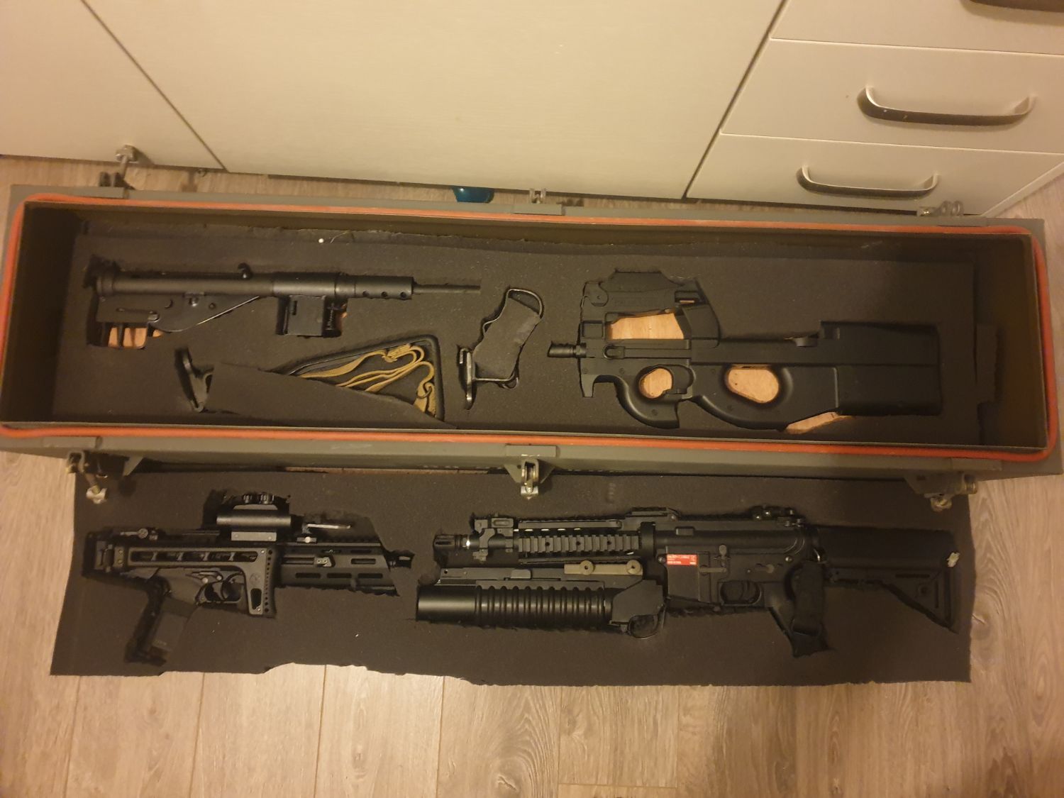

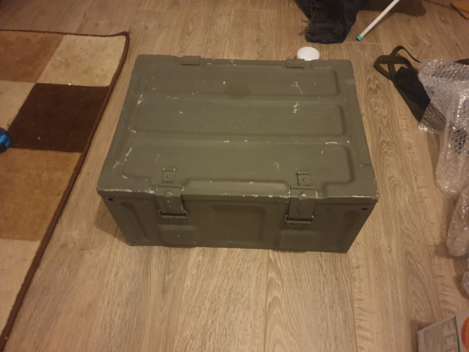

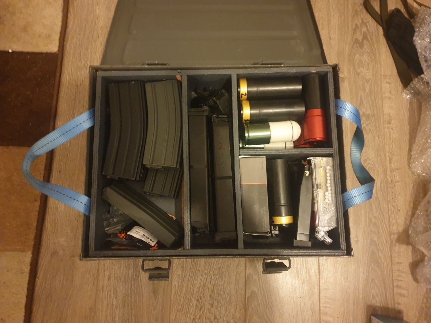

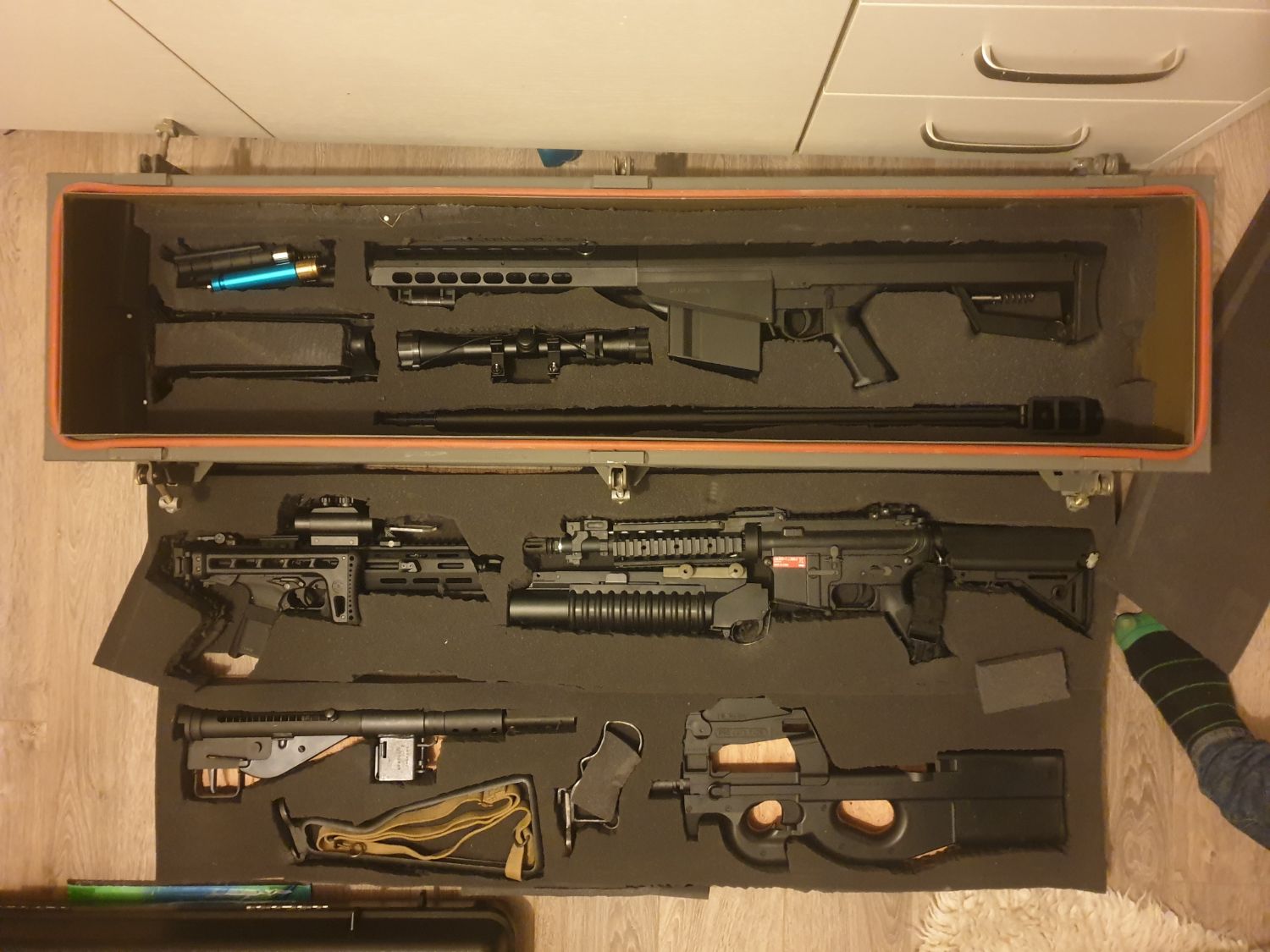

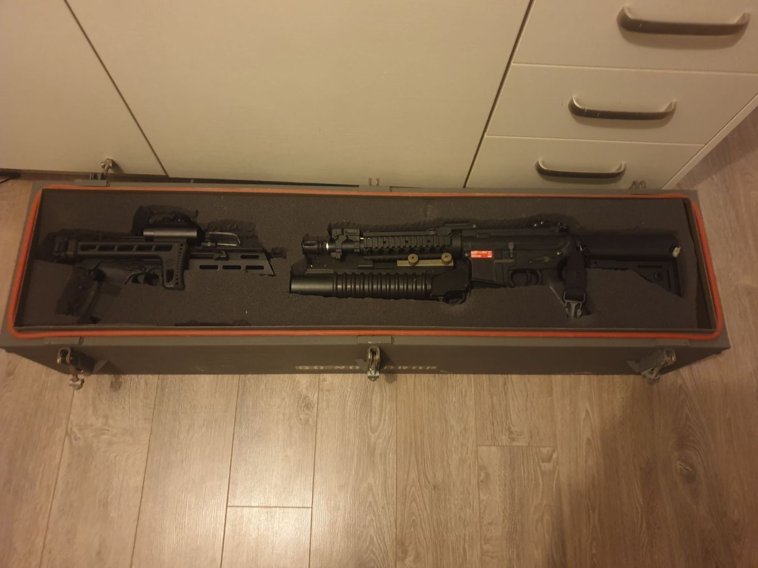

Spartan09 Posted January 17, 2021 Posted January 17, 2021 On 17/09/2020 at 20:15, Smiling-Dutchman said: Cranking handle on my speedloader changed its mind about being a cranking handle for a speedloader. So I made a new one on the lathe out of some spare brass stock. Annoyingly I did find some pre-made metric screws, but I couldn't find the metric tap and die set. So I made both a new screw as well as the handle using BA thread. Added some superglue on the thread for good measure. that reminds me, i need to do something similar to make a new handle for my nuprol speedloader.. damn handle came apart second time i used it.... =/ On 18/09/2020 at 20:20, Albiscuit said: i see the foam inserts you made for your bag, and i have done some similar things with an ex-military missile case (for my RIFs) and a large ammo case (for magazines etc). i think i posted somewhere on the forum that thats what i was planning, but i dont think i posted the final results...

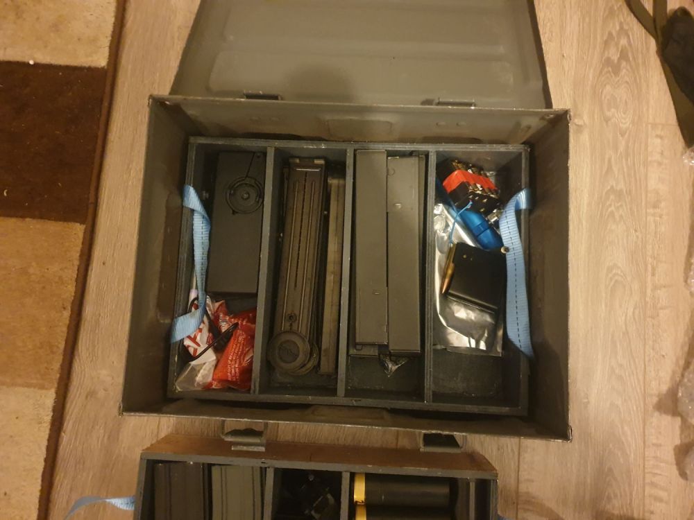

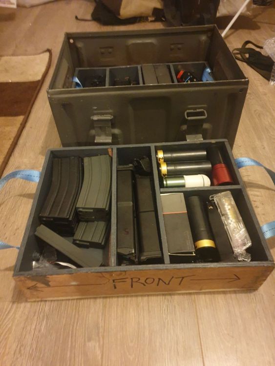

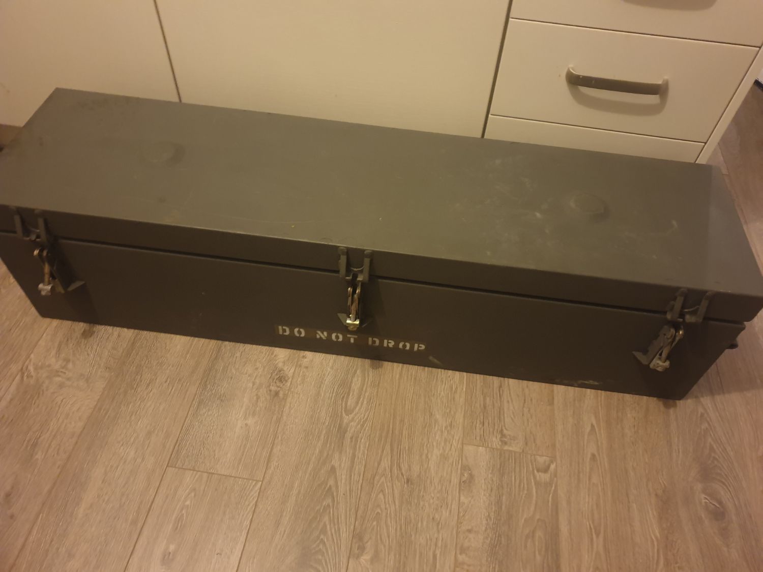

Spartan09 Posted January 17, 2021 Posted January 17, 2021 here are the pics: first the missile case turned gun case: and the ammo case turned magazine case: Butcher0666 and Spartan873 2
Albiscuit Posted January 17, 2021 Posted January 17, 2021 Looks great, I will find some better foam in the future and tidy it up, it looks gash but functional for now.

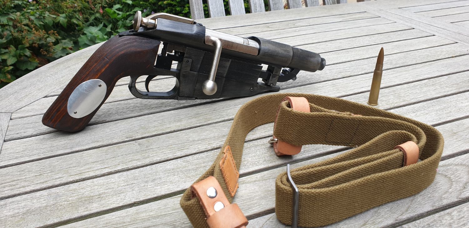

HELIflipper03 Posted January 18, 2021 Posted January 18, 2021 had to bring back my fav gun from my collection, all custom made from a donor pps mosin Butcher0666 and heroshark 2
