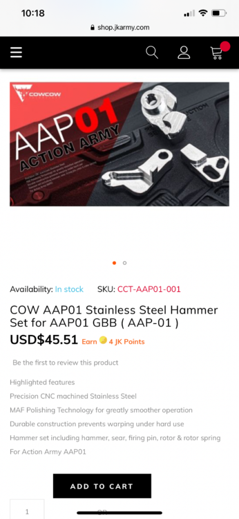

AlphaBear Posted July 28, 2021 Posted July 28, 2021 So is this what everyone is using once their hammers break? Is anything else needed as I may as well stick in extras if I’m ordering from JK?

Steveocee Posted July 28, 2021 Posted July 28, 2021 @AlphaBear looks like a gen2 hammer. So stock and still just as chocolatey. Get one of the CNC ones in there and the problems go away. AlphaBear 1

Steveocee Posted July 28, 2021 Posted July 28, 2021 12 minutes ago, AlphaBear said: I was watching your AAP-01 video on the tube last night. Very nicely done all 18 odd mins of it So other than the hammer set are there any other internal upgrades which are needed. I saw make a rotary hop too. Is that needed or is the stock hop unit good enough. Thank you, yeah that thing was a really nice build, never did get to use it in anger. I would say the only thing needed is the hammer, the AA one is better for a "perfect" fit, the CowCow one is a touch cheaper but has fitment issues with the Mamba uppers if you ever strayed that way. Other that that, nothing is needed on these pistols. They'll happily hop up to 0.4's out the box with no mods. Sure you can upgrade the barrel for small % improvements in grouping at range and you can stick H plates under the hop arm to hop heavier ammo and you can short stroke for a mega ROF. None of it is really needed, they are a fantastic pistol......kinda makes me want to buy one again. Fatboy40 and AlphaBear 2
Shaydee Posted July 28, 2021 Posted July 28, 2021 Judging by the majority of things I've read on the Facebook owners group and the like, the main part of the hammer that breaks is the tab preventing the triangular style hammer from fully rotating. So when it does break you can clean it up, pop a 9mm roller bearing and file a bit off the rear of the hammer housing to ensure semi and full auto work. This is what I'll be giving a go when mine inevitably dies using it as an SMG. Worst case I'll just grab a CowCow or AA one, not a massive expense in comparison the most of the stuff in this hobby ?

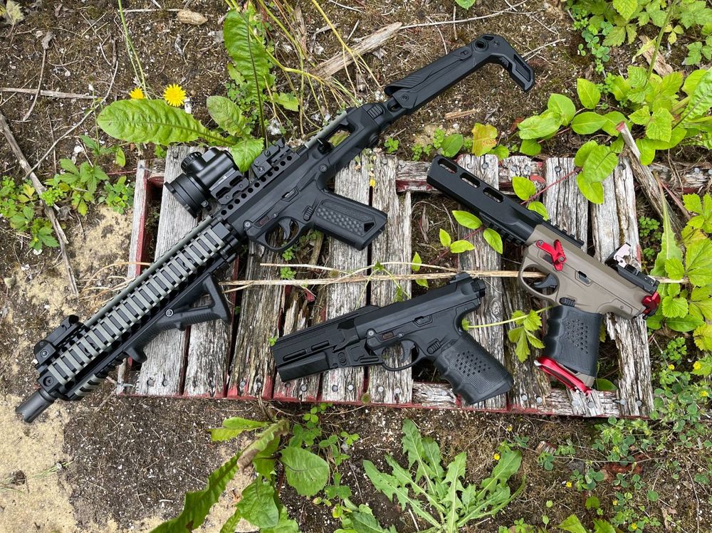

Supporters sp00n Posted July 29, 2021 Supporters Posted July 29, 2021 Ok so I may be an AAP-01 addict (and I have bits on the way to build another one ?) remus, leadly, PopRocket123 and 1 other 4
AlphaBear Posted July 29, 2021 Posted July 29, 2021 6 hours ago, sp00n said: Ok so I may be an AAP-01 addict (and I have bits on the way to build another one ?) How on earth did you manage to add a MK18 type rail onto an AAP? That’s incredible!! Me likes!!!

Supporters sp00n Posted July 29, 2021 Supporters Posted July 29, 2021 41 minutes ago, AlphaBear said: How on earth did you manage to add a MK18 type rail onto an AAP? That’s incredible!! Me likes!!! i 3d printed the adapter, and also a front barrel stabiliser (I snapped one, 70% infil petg) FYI I have the armour works drum mag and it fits all mine … I did have to file down the AA flailed mag well mind

PopRocket123 Posted July 31, 2021 Posted July 31, 2021 On 29/07/2021 at 15:56, sp00n said: Ok so I may be an AAP-01 addict (and I have bits on the way to build another one ?) I recognize that middle one ? sp00n 1
