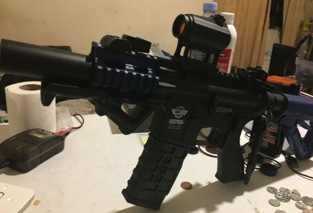

Hi there, first post in this forum. I'm a paintballer who recently converted to Airsoft and am enjoying the perks of the sport including Indoor plinking.  Just wondering how you guys go about mitigating some of the noise the IFs make. Since I'm new to the sport I was recommended by friends to go for an affordable and reliable AEG, platform such as the ARP-9 or the Firehawk M4 ( Both are extremely loud guns).  I removed the flash hider from my firehawk and replace it with a foam filled suppressor which has reduced the noise a lot but has anyone here used soundproofing material such as foam panels on walls to create a nice noise cancelling, shooting area?

lol about the housemates. I decided to just plink with the TV up. The gun with the suppressor on is also not as loud as I thought apparently so everyone is cool with me plinking indoors. My room is pretty hollow so the sound echoes making it seem a lot louder than it actually is.
