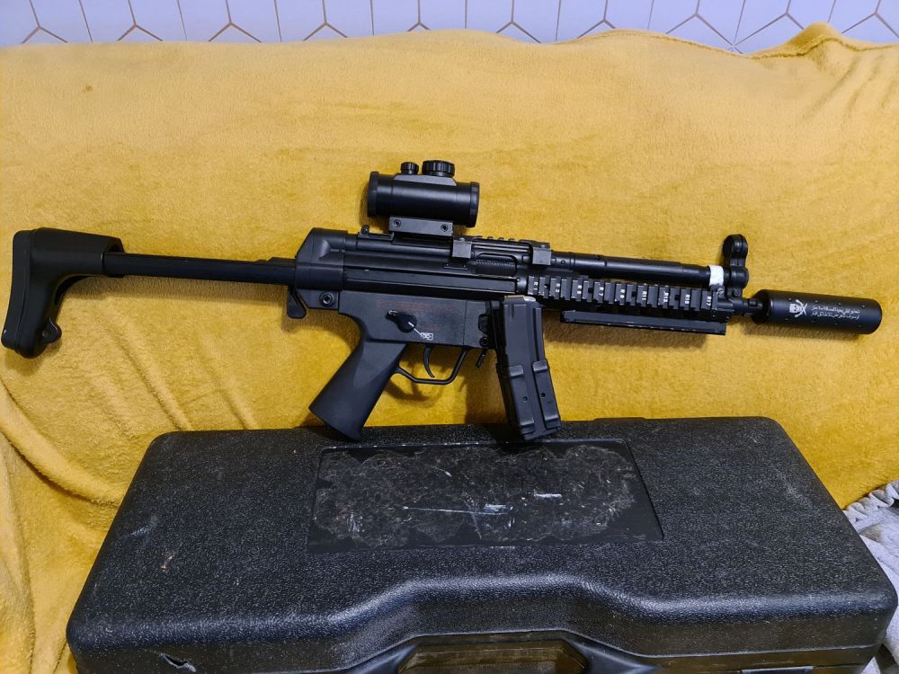

Roscoc Posted January 13, 2021 Posted January 13, 2021 Hello, This will be my first post as I am looking for a bit of assistance.. So I used to airsoft about 6 years ago.. I had a G&G M4.. long story short I ended up swapping someone who I feel shafted me and ultimately stopped. So.. I swapped for a full metal mp5 blow back AEG. I presume its a CYMA as I cant recall the box it got delivered in as it was pretty trash anyway... I have long lost the forum I used to go and refer to. I have a few issues, one was a gearbox cycling issue where the gearbox motor wasn't connecting to the actual gearbox... this was sent back to the guy then "repaired" from some shop showing proof of the gearbox actually cycling... FINE that's acceptable. It was returned to me then when I got it back I built the gun back up and the blowback stopped kind of working... possibly me rebuilding it up but its not that hard? my actual thought was the gearbox was switched out causing the blowback to not properly work? - the blow back does work but its like half open and when cycled its opening and closing the half... If I build the gun with the metal closure bit closed the way its meant to look the blowback doesn't work at all. My other issue was that the gun wouldn't select a fire mode... you would select full then it would slip out of fire mode causing the gun to do nothing then you would have to wiggle the selector to get it to work so I would stand like a moron and end up being shot or step off the match to try fix. I did inspect it and think the body of where the gun selects is screwed? I don't know if this is the selector module thing that could be causing this? does anyone know where would I find either a new body for my gun to try eliminate the body issue or a new selector for the gun? This is ultimately which disheartened me from airsoft and completely stopped for this length of time as the M4 I had and loved was gone and now I am stuck with a sh*t box that doesn't do squat and I want to fix this issue. I'm looking to redeem the gun back in shooting condition to go back and start all over (when it comes possible) Should anyone request pictures of any part's I can do so, the only reason I haven't put any pictures up is because I wouldn't know where to start. Some one please help

Skara Posted January 18, 2021 Posted January 18, 2021 If it has blowback I don't think it's a Cyma. Also to my knowledge, Cyma doesn't make metal MP5s. G&G makes blowblack MP5s and they are shit. If I'm right and the thing is G&G, the blowback is pneumatic, not mechanical: this means that there is a small port in the cylinder where some of the air is pushed into a small chamber on top of the gearbox, that chamber has a small piston (spring loaded I believe) that gets pushed backwards by the incoming air, cycling the fake bolt. Maybe when reassembling you (or the twat) didn't align the hole in the cylinder with the useless blowback thing. If you would be kind enough to send us pictures of the gearbox, we can confirm/deny my theory. I'd return it or sell as broken and use those monies to fund a better gun. Doesn't have to be fancy, a Cyma (a real Cyma, not a G&G POS) would suffice

Supporters Shizbazki Posted January 19, 2021 Supporters Posted January 19, 2021 18 hours ago, Skara said: If it has blowback I don't think it's a Cyma. Also to my knowledge, Cyma doesn't make metal MP5s. G&G makes blowblack MP5s and they are shit. If I'm right and the thing is G&G, the blowback is pneumatic, not mechanical: this means that there is a small port in the cylinder where some of the air is pushed into a small chamber on top of the gearbox, that chamber has a small piston (spring loaded I believe) that gets pushed backwards by the incoming air, cycling the fake bolt. Maybe when reassembling you (or the twat) didn't align the hole in the cylinder with the useless blowback thing. If you would be kind enough to send us pictures of the gearbox, we can confirm/deny my theory. I'd return it or sell as broken and use those monies to fund a better gun. Doesn't have to be fancy, a Cyma (a real Cyma, not a G&G POS) would suffice I was thinking the same. Im quite firmiliar with the G&G TGM series of guns and this seemed like their Pneumatic Blowback ones. The ones with the weakened gearbox for the blowback to work.
