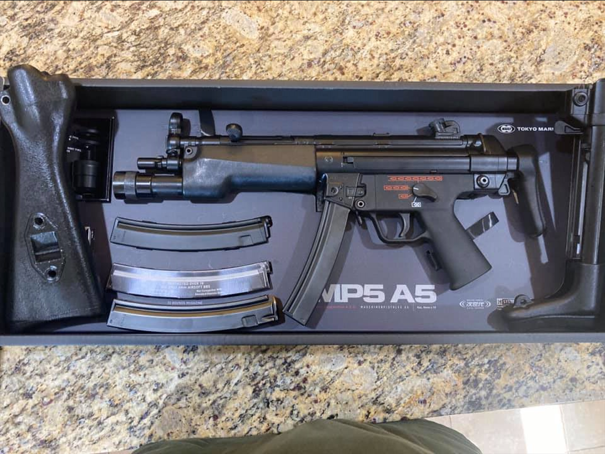

JamesWills Posted August 31, 2021 Posted August 31, 2021 With MP5's now starting to be delivered into the UK I thought it would be good to start of thread of people who have got or are wanting to buy the Tokyo Marui MP5 NGRS. Something I saw on Facebook today was that RS handguards fit perfect onto the gun without any modification. RS stocks however will not fit however without modification. Below is a link to the Facebook post for people wanting more information https://www.facebook.com/groups/TMInfoGroup/permalink/1218857961950989/ Louish118 and Monkman 1 1
AlphaBear Posted August 31, 2021 Posted August 31, 2021 1 hour ago, JamesWills said: With MP5's now starting to be delivered into the UK I thought it would be good to start of thread of people who have got or are wanting to buy the Tokyo Marui MP5 NGRS. Something I saw on Facebook today was that RS handguards fit perfect onto the gun without any modification. RS stocks however will not fit however without modification. Below is a link to the Facebook post for people wanting more information https://www.facebook.com/groups/TMInfoGroup/permalink/1218857961950989/ I saw that too. It sure looks great with the RS hand guard. I couldn’t tell which rear stock was which from the pics. I’m sure the RS one could be modified to fit somehow. A Dremel and so metal epoxy may do it perhaps?
Hatchet Posted August 31, 2021 Posted August 31, 2021 (edited) I don't have Faceache, but the picture above is interesting. The picture from earlier in the other thread seemed to indicate they wouldn't (the locking tab looked a different size and shape). Any indication if they can fit a battery too, because the Marui handguard looks bigger and that's apparently a tight fit? The Surefire grip is such a classic look, although it does mean you can't run a suppressor at the same time. I am in two minds about running out to get a B&T one, or just doing the sensible thing of waiting for the inevitable aftermarket parts (or using a railed foregrip and just mounting a regular torch)... Edited August 31, 2021 by Hatchet More rambling

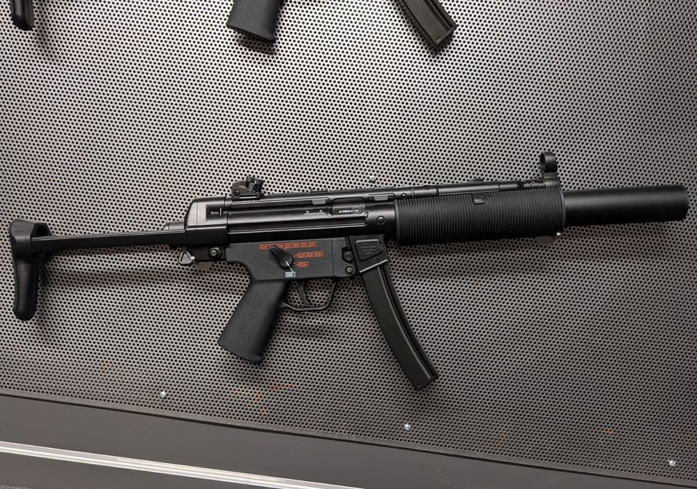

JamesWills Posted September 10, 2021 Author Posted September 10, 2021 (edited) Just seen on Facebook that someone has created an SD6 and I think it belongs to @SonnyMP5 I will let him share the photos ? Edited September 10, 2021 by JamesWills Jacob Wright and SonnyMP5 1 1

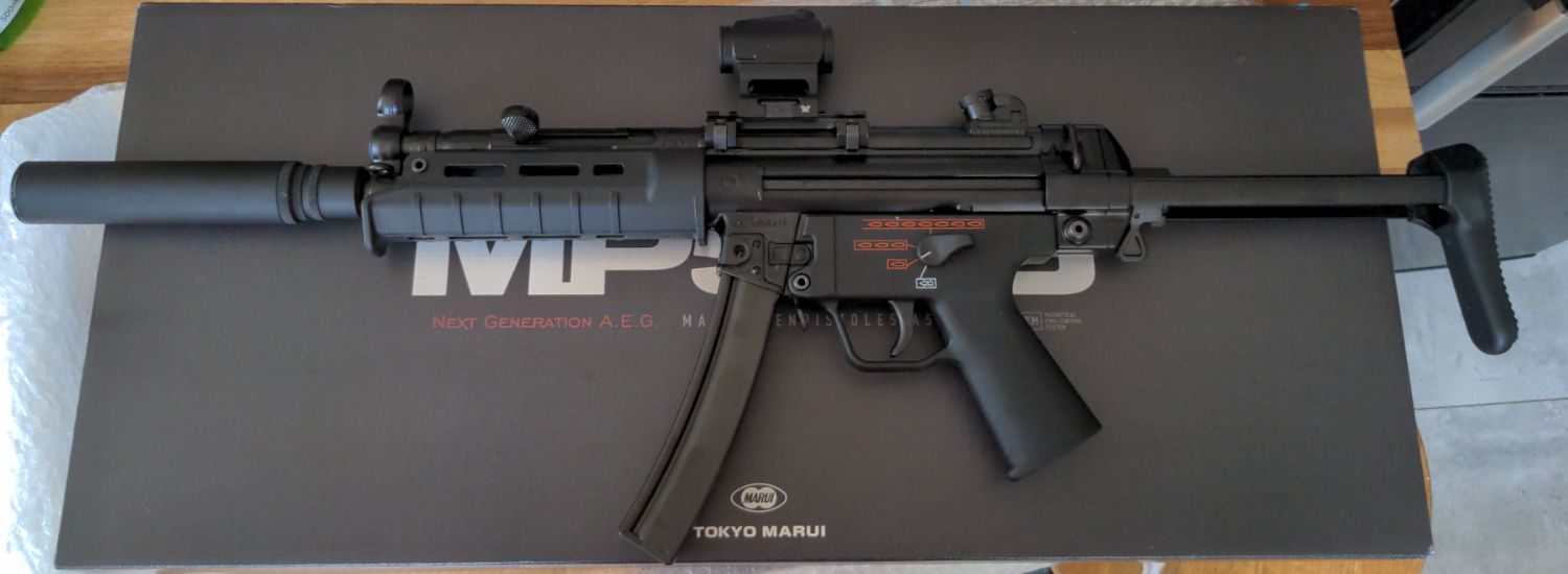

Popular Post SonnyMP5 Posted September 11, 2021 Popular Post Posted September 11, 2021 Yes did build up a SD6. Finished it last night came out lovely. Wasn't too hard to build if you can get original ICS parts and have access to a lathe to build an adapter. Longer barrel and new spring bumped my FPS up too 340 so looking forward to using it tomorrow for its first outing. Also fitted my magpul guard and gemtech QD suppressor from my other ngrs mp5 I built myself to see what fitted and they went straight on. I have a real steel sliding stock that I wanna try out but I think only the rails of the stock will fit with some milling so I might stick with the original as it's way more solid than any sliding stock on Rif. Monkman, Akuma121, SgtTalbert and 7 others 3 7
Hatchet Posted September 11, 2021 Posted September 11, 2021 Looks great. I don't have access to a lathe. Then again, I still have both arms, which I probably wouldn't if I had access to a lathe. I can't be trusted with power tools. Does it make much odds to battery space or is it much the same? Also, bold choice just jumping straight in there with the spring swap. Like it. Any word on the compatibility of existing AEG stocks? I have a B&T side folder I wouldn't mind having the option putting on. Jacob Wright 1
JamesWills Posted September 12, 2021 Author Posted September 12, 2021 On 11/09/2021 at 10:02, SonnyMP5 said: Yes did build up a SD6. Finished it last night came out lovely. Wasn't too hard to build if you can get original ICS parts and have access to a lathe to build an adapter. Longer barrel and new spring bumped my FPS up too 340 so looking forward to using it tomorrow for its first outing. Also fitted my magpul guard and gemtech QD suppressor from my other ngrs mp5 I built myself to see what fitted and they went straight on. I have a real steel sliding stock that I wanna try out but I think only the rails of the stock will fit with some milling so I might stick with the original as it's way more solid than any sliding stock on Rif. Looks great, who did the custom work for you if you dont mind sharing?
