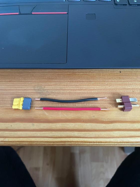

Jacob Wright Posted November 15, 2023 Posted November 15, 2023 Before I utterly f*ck the ECU in my MP5, does this layout for the connectors look correct? Singled out pin on the MR30 for positive to the vertical pin on the deans? I'm like 99.9% sure but want to check ?
EDcase Posted November 15, 2023 Posted November 15, 2023 Duno about the MR30 side but the Deans is correct Jacob Wright 1
Jacob Wright Posted November 15, 2023 Posted November 15, 2023 It’s the MR30 side I’m not sure on either, can’t find any wiring diagrams online.
BigStew Posted November 15, 2023 Posted November 15, 2023 14 minutes ago, Jacob Wright said: Before I utterly f*ck the ECU in my MP5, does this layout for the connectors look correct? Singled out pin on the MR30 for positive to the vertical pin on the deans? I'm like 99.9% sure but want to check ? Following with interest.
Jacob Wright Posted November 15, 2023 Posted November 15, 2023 Someone I trust to tech my NGRSs has confirmed the above, will post results or delete my forum account later ? lokkers 1
Jacob Wright Posted November 15, 2023 Posted November 15, 2023 Never soldering anything again. Made the connector, connected a battery, got a single shot off before nothing and the red LED. Switched batteries, emptied the rest of the magazine (3 round burst is my new favourite thing), then as I've disconnected it the MR30 has come off my connector and got itself stuck inside the one on the MP5. Dug it out with a pair of pliers, ordered one off Eagle 6. Link below. Also burnt myself with the soldering iron and dropped a scalpel onto my leg ? https://eagle6.co.uk/shop/catalog/product/view/id/7874/s/eaglesix-female-mr30-to-male-deans-adaptor-8cm/ gavinkempsell and BigStew 1 1

Jacob Wright Posted November 15, 2023 Posted November 15, 2023 I should add though, it did actually work for a short period and only failed due to my shoddy soldering. Not sure if I quite trust myself to put an MR30 onto a battery yet following this disastrous attempt ? Shamal 1
Shamal Posted November 15, 2023 Posted November 15, 2023 12 minutes ago, Jacob Wright said: I should add though, it did actually work for a short period and only failed due to my shoddy soldering. Not sure if I quite trust myself to put an MR30 onto a battery yet following this disastrous attempt ? You can only get better ? My first attempt at soldering a deans connector onto a lipo saw me attaching the male half of the connector to the battery. I only realised as I took it out of the helping hands jig. Sparks and smoke prevailed. Oh how we laughed!☹️ Jacob Wright 1
PigDoggy Posted November 15, 2023 Posted November 15, 2023 2 hours ago, Jacob Wright said: Never soldering anything again. Made the connector, connected a battery, got a single shot off before nothing and the red LED. Switched batteries, emptied the rest of the magazine (3 round burst is my new favourite thing), then as I've disconnected it the MR30 has come off my connector and got itself stuck inside the one on the MP5. Dug it out with a pair of pliers, ordered one off Eagle 6. Link below. Also burnt myself with the soldering iron and dropped a scalpel onto my leg ? https://eagle6.co.uk/shop/catalog/product/view/id/7874/s/eaglesix-female-mr30-to-male-deans-adaptor-8cm/ I just soldered deans plugs off of the marui adapter to tamiya. Black/Box....Round/Red and Red is Positive. That's how I remember which one is which. That said, having the proper soldering iron/solder makes a huge difference. 7.4v 1300mah 20c lipo and I've never had issues with all the TM MP5 NGRS' that I had ran with. IIRC, the marui lipo battery is 7.4v 1500mah 35C.... Even with an FPS upgrade to +10-15%, one battery lasts me all day. Jacob Wright 1
