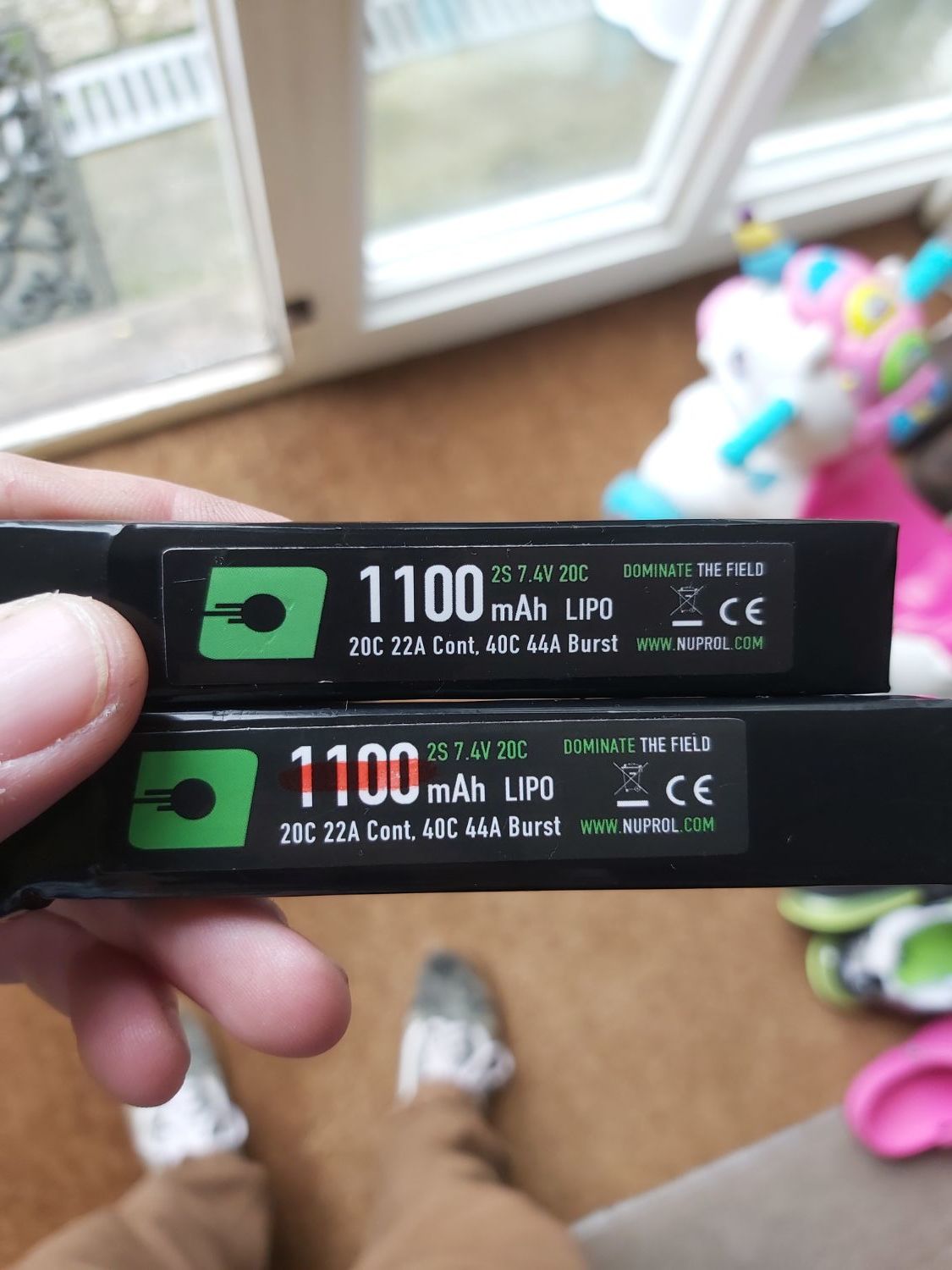

Sketchyetchy Posted October 9, 2021 Posted October 9, 2021 (edited) So ran mine for the first time last. Guns insane. However I played one 15 min round on a fully charged LiPo 7.4v 1100 mAh next game, red light flashing nothing happening. Put fresh battery in no issue continued like a dream. Put that same battery in from first game just now and working no issues with dry fire mode. Same with the second battery. No red light flash. Popped them both on and switched still no issue on dry fire Is this something to worry about? I ask because this is my second MP5 as my first came with a rattle and wouldn't take any batteries properly despite fully charged with both of them would constantly get red light and I guess go into its safe mode. Edited October 9, 2021 by Sketchyetchy
mightyjebus Posted October 9, 2021 Posted October 9, 2021 it could be the C rating of the battery. everyone on here who has posted battery pictures are all C30+. it would be interesting to know the C rating of your battery. Some batteries list the C rating but its actually the B rating, for example a B rating of 60 amps would mean it had an actual C rating of 30., but some labels will say 30C but actually mean 30B and this really means 15C. If you are running a battery with a C25 rating then it actually might only be 12.5C and you would have issues with prolonged longish bursts and the battery would drop output and the marui mosfet unit might sense it as a low battery.
Sketchyetchy Posted October 9, 2021 Posted October 9, 2021 1 hour ago, mightyjebus said: it could be the C rating of the battery. everyone on here who has posted battery pictures are all C30+. it would be interesting to know the C rating of your battery. Some batteries list the C rating but its actually the B rating, for example a B rating of 60 amps would mean it had an actual C rating of 30., but some labels will say 30C but actually mean 30B and this really means 15C. If you are running a battery with a C25 rating then it actually might only be 12.5C and you would have issues with prolonged longish bursts and the battery would drop output and the marui mosfet unit might sense it as a low battery. So these are the two I have and used fully charged (but from the night before). The one with the red line cut out after 15 mins and the other worked well for rest of the night. But both work fine today. So with your info I'm guessing I need a better battery.
mightyjebus Posted October 9, 2021 Posted October 9, 2021 don't want you running off ands spending your hard earned cash on a new battery but here's something to consider: you could buy one of those cheap Lipo checkers. you plug it into the balance lead and it tells you the voltage of each cell. each cell should be the same, for example 4.3v but if it comes back as 4.3v and 4.1v then 1 of the cells might be on the way out. 4.3v would be on a fully charged battery but you can test on a partly charged battery but the results should still be the same on both cells. 36.v & 3.6V for example.
Sketchyetchy Posted October 9, 2021 Posted October 9, 2021 Oh so the rating on my batteries is okay? It does say 20c though? But the short burst 40c? (I'm new to airsoft so this is new to me). The picture is of two separate batteries so would this just be one cell ? If the majority are running 30c plus I might just play it safe and get one so I don't have the issue I did yesterday. If yourself or anyone recommend a LiPo that they are using that would be great in their MP5. I am going to get, when it comes out the new battery they are producing for this and future models. Well I've been told there is a new one.
