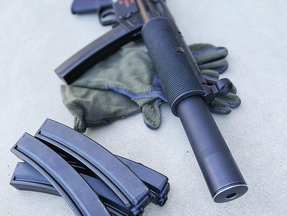

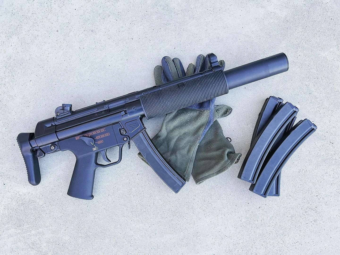

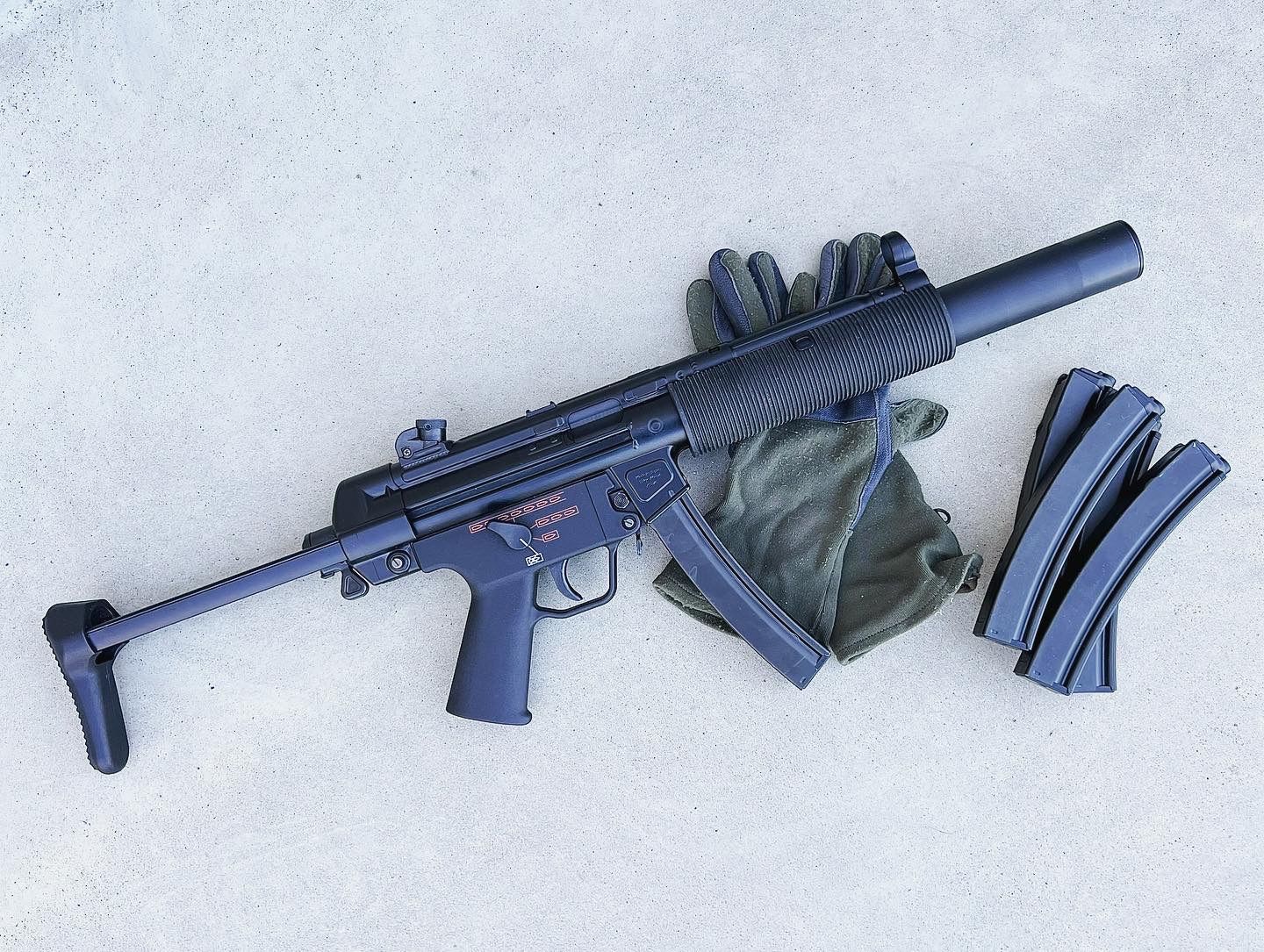

Popular Post johanlovberg Posted April 17, 2022 Popular Post Posted April 17, 2022 Baaam! Got inspired by SonnyMP5 (?) and got old SD parts from ICS which after a lot of work finally fit like a glove on my TM Mp5 Nextgen ? Came out amazing! FullSizeRender.MOV Sneaky, JamesWills, timski and 3 others 1 5
JamesWills Posted April 18, 2022 Author Posted April 18, 2022 8 hours ago, johanlovberg said: Baaam! Got inspired by SonnyMP5 (?) and got old SD parts from ICS which after a lot of work finally fit like a glove on my TM Mp5 Nextgen ? Came out amazing! FullSizeRender.MOV Would be good to see a guide / tutorial of how this is done I heard it requires a lathe which is hard to get hold of for most people
johanlovberg Posted April 18, 2022 Posted April 18, 2022 It was a bit of a improvisation so i did not documented the process, but I did it without a lathe. The electrical tools I was using was basically a dremel and a drilling machine. And the parts I used from ICS was the handguard ”base” and grip, front sight, silencer and the silencer adapter that was originally mounted on the ics outer barrel. Added a very short barrel extension because the placement of the adapter was adjusted slightly.
