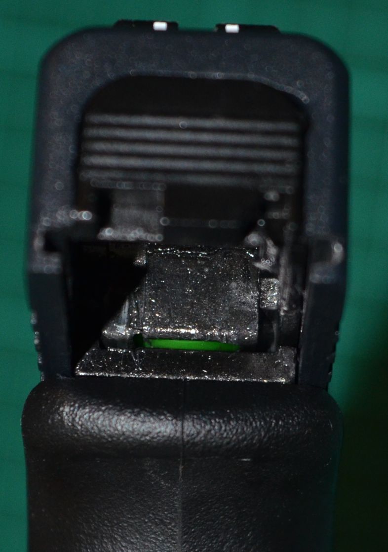

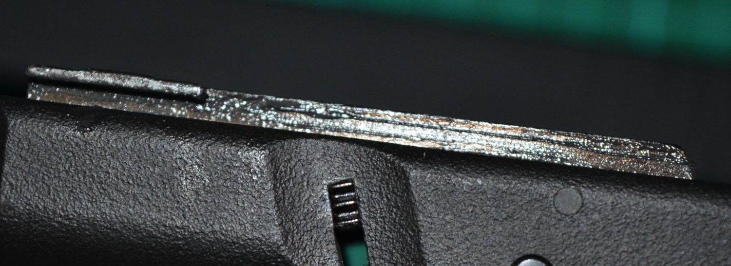

Not impressed with their final response. It was claimed that the action is normal when I know that it is not as I had been using it for a week prior to giving my son the item and it worked just fine all through NAF and then suddenly, the moment I get an EU17 holster, the pistol starts malfunctioning.

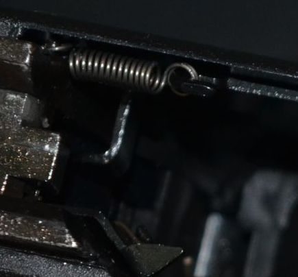

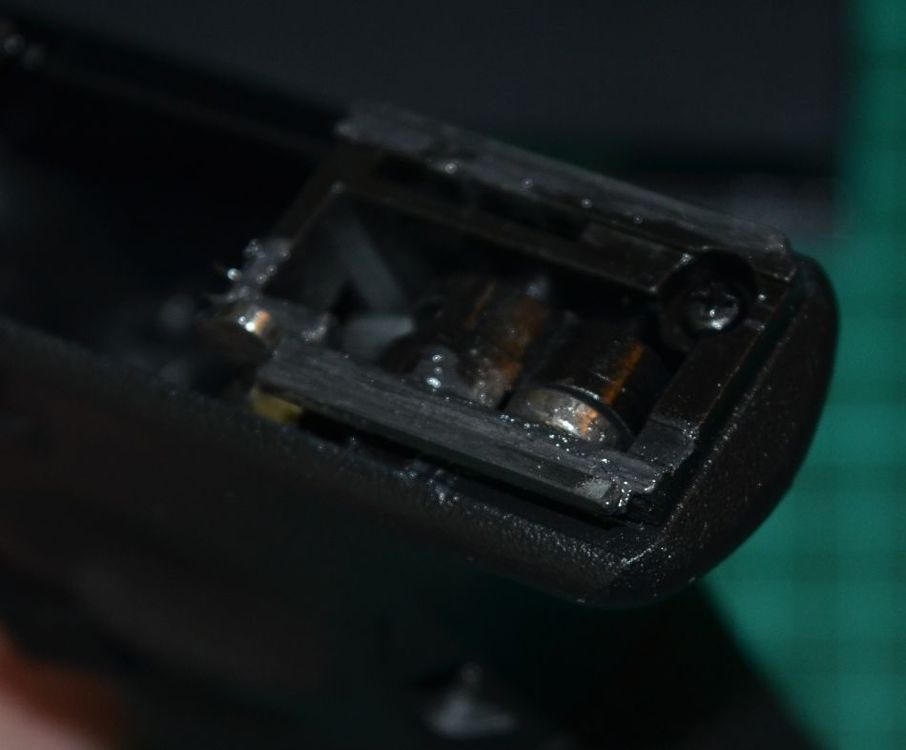

What the shop tried to say is that #pic 1 is normal when #pic 2 is normal IF your magazine is empty, what is not normal is the position of #pic 1 when its the result of the slider snagging on part of the body.

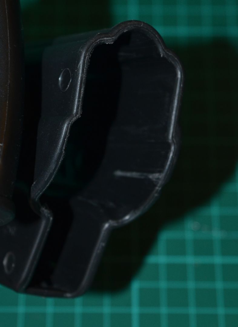

The holster images are the Amomax EU17 (as it was sold to me as) for the EU17 and as you can see, the small size variance is causing the holster to come in contact with the main body of the top slide and the top sight.

Have you taken the slide off to see if there is any obvious damage?
The WE G17 is well known for doing exactly what you are showing, and typically it’s the hammer wheel hanging on the blow back unit.
Does the slide go back into normal position when you give it a little nudge?
The best fix is to replace the hammer wheel with a roller bearing type, or replace the gun for a TM

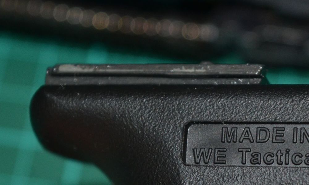

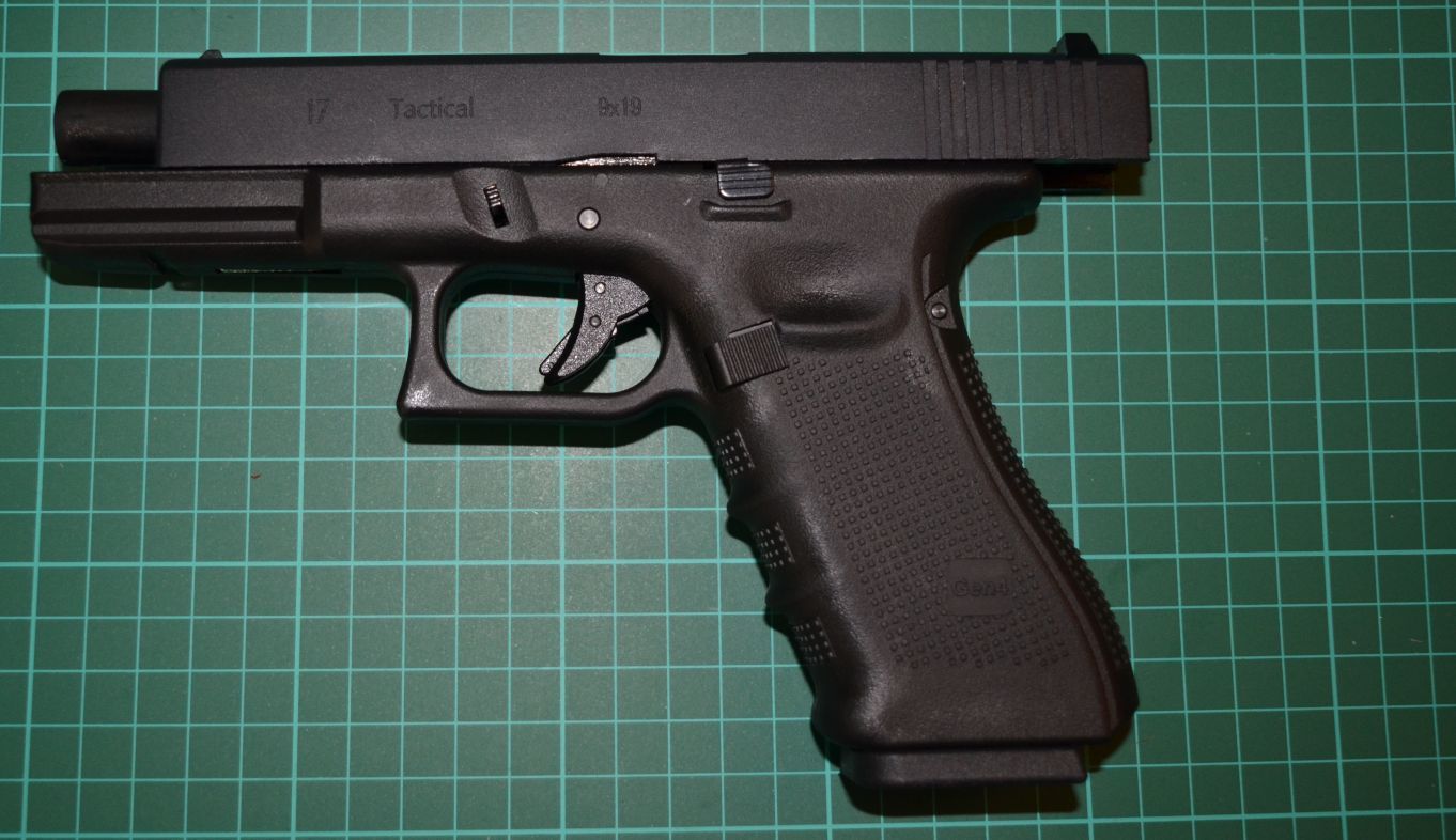

Pictures show where the slide is rubbing and also catching when it locks open.

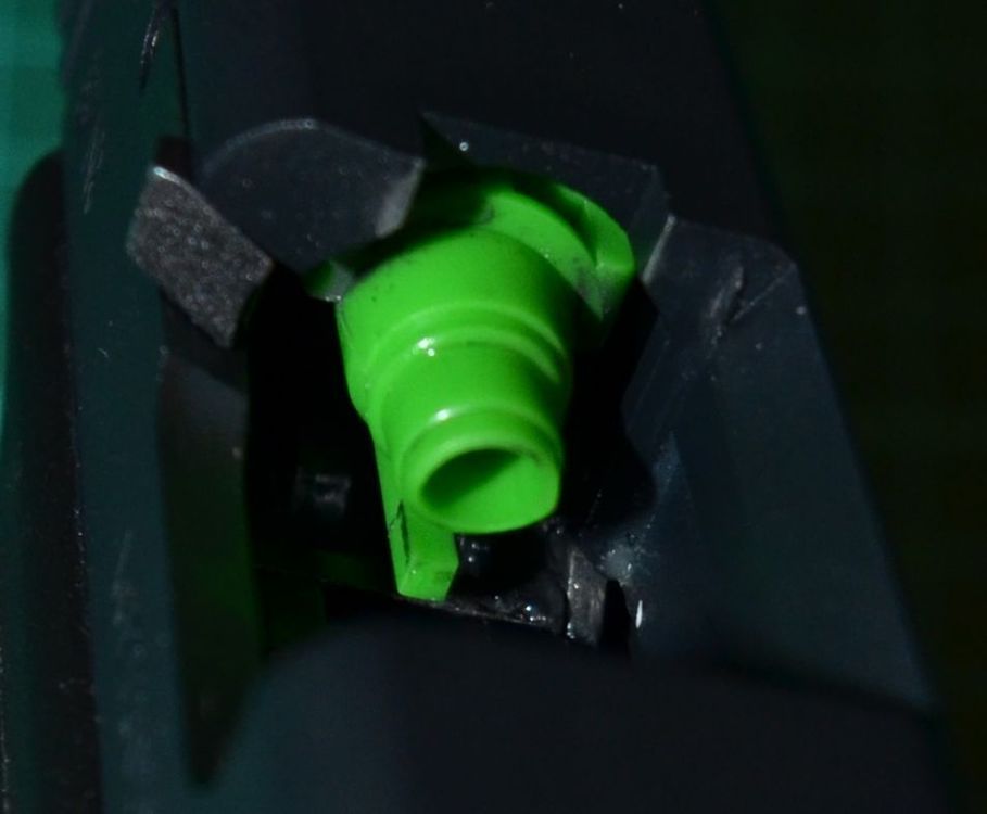

The BB is there in one shot to show the position I find BB's in when its playing up.
I don't have a macro lens for close up, this is the best I could do with what I have.
No undue  wear, but in all the glocks ive owned and repaired I’ve never seen a bb get into the hammer mechanism!
Looks like the slide is being lifted, very odd

Yeah, my bad there.. I was at to see where it is rubbing, its an old engineers trick that is cheap and quick when you run out or the engineers blue or permanent similar product. I'd use a sharpie if I could get the tip in but its one of those big ones.
When its been cycles a few more times, I will see what the grease situation is like, where there is definite bare metal should tell me where the top slide is warped.

As you can see from some of those images that the slides have grease on them and no bare metal, the bare metal had grease on them...
I expect some of that to be normal wear, however, some of it doesn't seem to me to be what you would consider normal and IMHO is the result of the slide being warped.
All of the slides of any airsoft pistol are warped to some degree, they’re just cast zinc alloy.

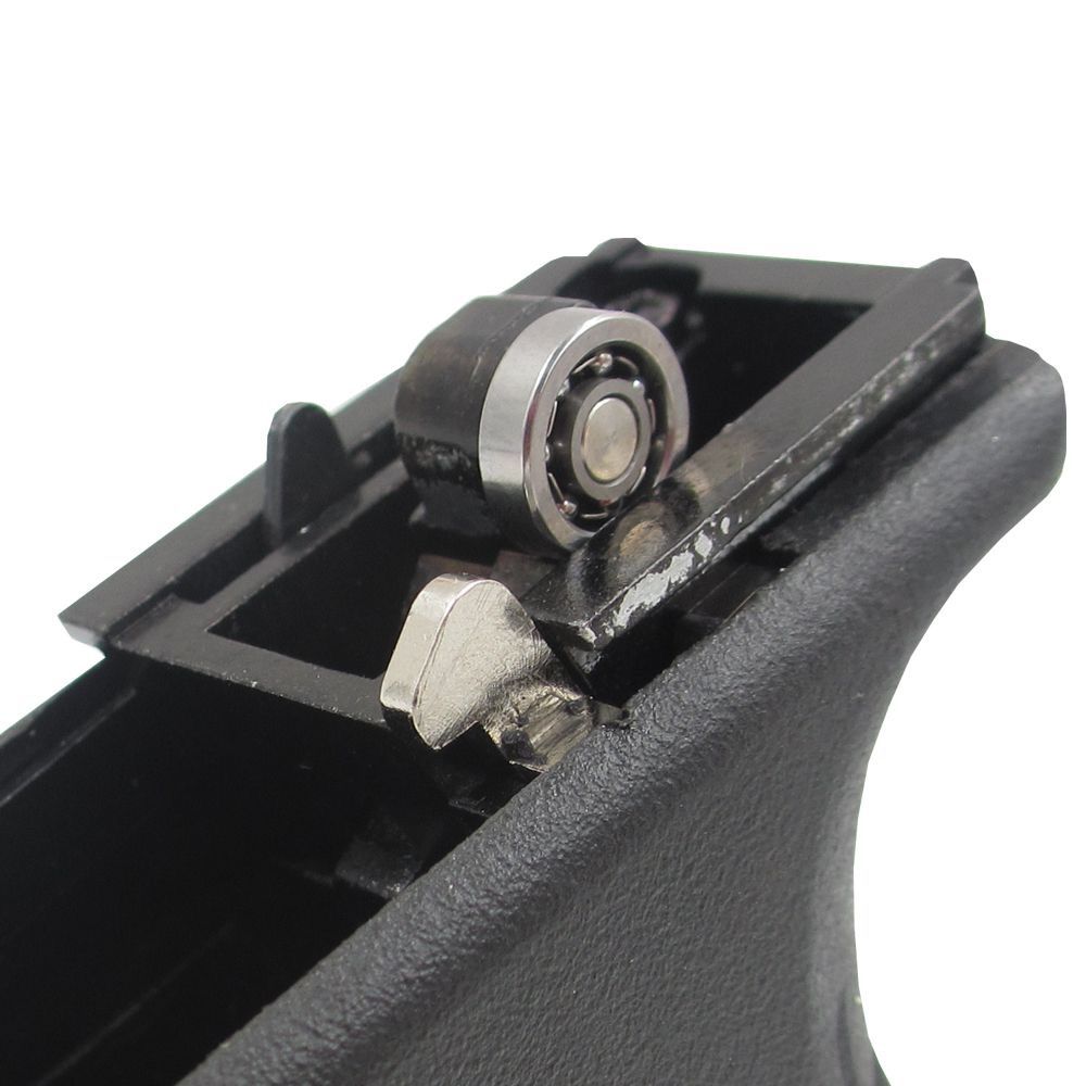

It looks like it already has a roller on the hammer.
The top slide is also rubbing on this spring, which can't be good.
... also, just to test a theory, there is more than enough room in the breech for a BB to make its way in to the hammer action.
I am wondering next, how multiple BB's were being fed in a single shot pistol.
I just can not fathom that bit out.
That’s not a roller bearing, it’s just a metal wheel
What does one look like?
