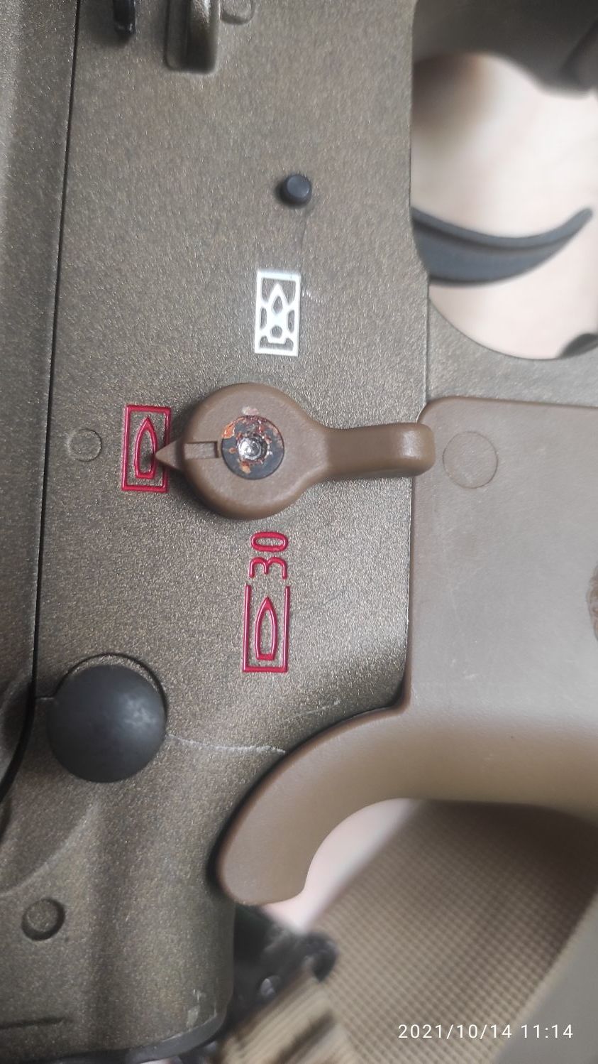

MarkusIL Posted October 14, 2021 Posted October 14, 2021 Hello my saviors, Trying to get to the gearbox for the first time {+first gun, vfc hk416}, I rounded the selector bolts which are extremely small, maybe 1 to 3 millimeters. I was looking up solutions in Google but people seemed to have way easier problems {big screws}, does anybody have a suggestion for this problem case?

concretesnail Posted October 14, 2021 Posted October 14, 2021 Looking at the picture I'd suggest cutting a groove into it and using a flat screw driver. If that doesnt work then you have enough head left to try the larger torx bit wedged in it.

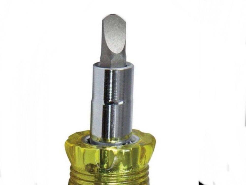

Supporters Druid799 Posted October 15, 2021 Supporters Posted October 15, 2021 I’ve got a small flat head screwdriver just for this job if I have to cut a slot , basically all I did was round out the ‘blade’ and re-profile it so the bevel follows the curve of the tip for max grip , I find it works quite well . ? this is roughly what I mean .
