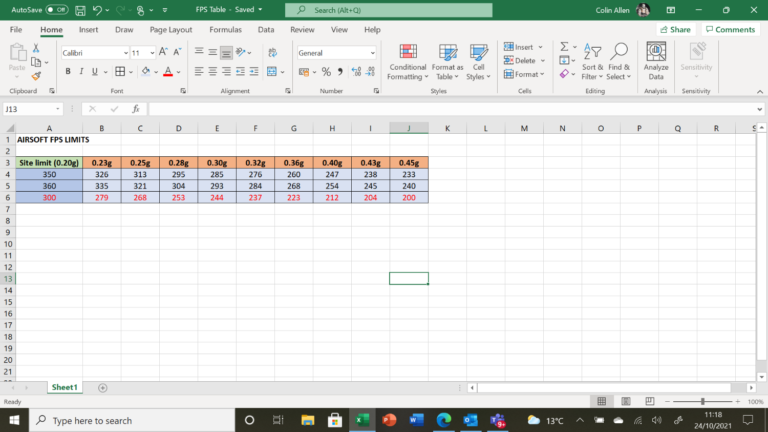

colinjallen Posted October 24, 2021 Posted October 24, 2021 A simple table showing the equivalent FPS at different BB weights for sites that have limits of 350FPS and 360FPS on a 0.20g BB; numbers are rounded down. 20 minutes ago, Rogerborg said: Honestly, I don't blame you. It's up to sites to explain what they mean, and far too many don't bother. They're stuck still thinking in terms of everyone using 0.2g BBs, to the point of not even specifying that, when essentially nobody is using BBs that light in woodland any more. At least they had a Joules figure up there, which is still better than some places. But it makes the fps irrelevant, because what they really mean is 1.14J with whatever ammo you're using, and that happens to be 350fps if you're using 0.2g (but you almost certainly won't be, so it's a pointless number). There's an argument that it's simpler to communicate one big round number than one small one, but it's facile since you have to convert the big number to the small one for it to be any use. Then they'll argue that it's quicker to chrono with site 0.2g BBs (if they bother chronoing, or checking for it), which is great until you see just how much even AEGs can Joule creep with heavier ammo. I had a bit of a surprise yesterday when my AEG jumped from 1.1J up to 1.2J just by going from 0.25g to 0.32g with no other changes. Fortunately that was bang on the site limit. And I honestly couldn't tell you what fps it was seeing with either weight, because it's an irrelevant number. You set the chrono to the BB mass, and you look at the Joules figure, done. Alternatively you can use a chart to convert from fps to Joules, but why bother when it's a few presses on the chrono for most common ammo weights? And credit to this site (Area-66), they even announced that if anyone changed BB weight during the day that they should get re-chronoed. That's the way that sites should be thinking and communicating now. The issue is that sites just want to get chronoing done as quickly as possible so do not want to spend time changing the BB weight setting on the chrono; in addition, most marshals that I worked with or have seen do not know how to.

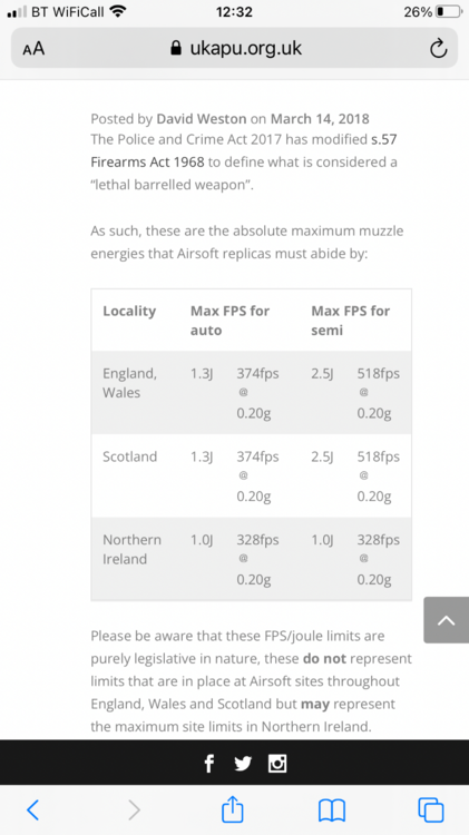

colinjallen Posted October 24, 2021 Posted October 24, 2021 7 minutes ago, SBoardley said: I’m sorry but I tend to slightly disagree with your assumption. as I understand it , the law states the joule rating based on 0.2g bb. So if any of my auto capable rifs shoot under 1.14 joules, they meet the legal bench mark, irrespective of whether I use .12g or .36g bbs. edit. Well it’s actually 1.3 joules I believe but most sites like the 350 fps thing. The law does not mention weight, only energy: The permitted kinetic energy level is— (a)in the case of a weapon which is capable of discharging two or more missiles successively without repeated pressure on the trigger, 1.3 joules; (b)in any other case, 2.5 joules.” 1 minute ago, Adolf Hamster said: not to mention the number of sites that'll set the chrono to the correct weight, then read the fps value instead of the joule value anyway..... Indeed; I just put it down to...humans.
SBoardley Posted October 24, 2021 Posted October 24, 2021 3 minutes ago, Adolf Hamster said: 2 minutes ago, colinjallen said: The law does not mention weight, only energy: The permitted kinetic energy level is— (a)in the case of a weapon which is capable of discharging two or more missiles successively without repeated pressure on the trigger, 1.3 joules; (b)in any other case, 2.5 joules.” Dunno about that mate

colinjallen Posted October 24, 2021 Posted October 24, 2021 21 minutes ago, SBoardley said: Dunno about that mate That is UKAPU's statement, not the law; what I quoted IS the law. 18 minutes ago, snuff said: The issue then becomes which chrono?My ICS will chrono on my Xcortech @310 fps but at a site I visit their Nuprol shows @ 285 fps. Nuprol...

SBoardley Posted October 24, 2021 Posted October 24, 2021 12 minutes ago, colinjallen said: That is UKAPU's statement, not the law; what I quoted IS the law. I see what you are saying. I was talking in terms of joules creep; so the ukapu statement is actually slightly misleading? I’m slightly confused as this seems up to date?
