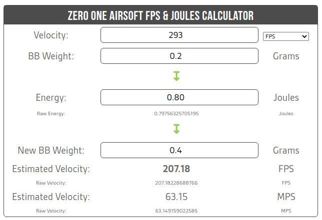

AirSniper Posted November 3, 2021 Author Posted November 3, 2021 (edited) One final one, this shows that a 0.2 g BB that is swapped for a 0.4g BB has this effect on the FPS, losing about 86 feet per second in velocity. Edited November 3, 2021 by AirSniper

AirSniper Posted November 3, 2021 Author Posted November 3, 2021 No its not, its thsame conversation but the data you get depends on where you start. Back to the beginning... The op of another thread was complaining that his 200fps on a 0.8 joule rif with a 0.4g BB was not giving them the speed that they wanted. The reality was that a 0.4g BB on an 0.8 Joule rif is 207 feet per second, allow for variance, they were already there... Then the conversation went off on a tangent with ballistics in this thread because it was an attempt to demonstrate the relationship of BB weight to FPS from a fixed energy input, which shows exactly waht I am trying to rteiterate time and time again... You can not get out more energy than you put in, there are only losses, these can be sound, heat, light, velocity and energy depending on what you do. As the Joules is fixed, you have to decide where you want your joules to go, do you want velocity so you get the distance in the shortest time, hit your mark and bugger the energy dump OR run with heavier BB's to run slower FPS and longer flight time but hit your mark and dump the energy in the BB in to the target. Only way you are really going to get down with this is to get a chrono, different weight BB's, start throwing them and chronoing the speeds and record the joules and fps per BB weight. I did just that with some pistols and I will be repeating the experiment again but in a more controlled environment wherte I can record things like humidity, temperature, gas type, etc and chart it in a spread sheet and then I plan on posting it here as its pretty interesting to see how fps and joules vary from the BB weight. Early data, my M&P 9 does better on 0.25 and 0.3g BB's than 0.2g or 0.28g, which was surprising. The M92F favours 0.28g than anything else. So each weapon, cannon or airsoft RIF will have its own characteristics and losses, these are the things that I believe people are chasing because they see the figures on the tin and expect that to be the minimum. Unfortunately, reality is ae a box of surprises and disappointments as shown here.

AirSniper Posted November 3, 2021 Author Posted November 3, 2021 Here is some early data from a quick chrono test. If you plug in the data in to the Zero one calculator and do the convertion, you see that variances exist and its pretty close to the change you expect with higher withg BB's on a fixed power input that affects the velocity. Thus showing that you want to speed up your BB's you have to go light weight. The video demonstrates (for the umpteenth time) that the fixed point is the slug weight and the variables were the pressure input of power in joules and the resulting FPS. Which as demonstrated, the sweet spot was 3700 ish PSI (from memory) which if you calculate it is 4880.8799 Joules that was put in to generating the higher velocity than the higher psi of 4500psi or lower psi than the sweet spot. It demonstrates the same thing with BB only your fixed source is your power rating in Joules. Do you not recall how you moved equations around in school to work out things from a couple of known elements, only the data you have needed the equation changing to fit your needs, like V = I/R in electrical engineering, you can find Amps ( I ) from the Voltage and the load resistance in watts. It similar process, you move the element until the desired parts are the answer. I have suggested people play with the Zero One calculator as it shows exactly what I am saying and I don't understand why people don't get this fact, its based in real life physics. Same pistol, same Joules, different BB weights.

Supporters ImTriggerHappy Posted November 3, 2021 Supporters Posted November 3, 2021 35 minutes ago, AirSniper said: I have suggested people play with the Zero One calculator as it shows exactly what I am saying and I don't understand why people don't get this fact Because you are looking at it too narrowly. Your results are based on a chrono which is a couple of inches from the end of the barrel. A bb is very light and that low mass is hugely affected by air resistance. All this has been done and proved ages ago and it was proved that a heavier bb bleeds off energy at a slower rate and after about 30ft if everything is set properly the heavier bb is equal to the lighter bb and after that is usually travelling faster. Set your chrono about 35ft away and then test but make sure you use a real one not some £40 hobbyist one.

AirSniper Posted November 3, 2021 Author Posted November 3, 2021 3 hours ago, ImTriggerHappy said: Because you are looking at it too narrowly. Your results are based on a chrono which is a couple of inches from the end of the barrel. A bb is very light and that low mass is hugely affected by air resistance. All this has been done and proved ages ago and it was proved that a heavier bb bleeds off energy at a slower rate and after about 30ft if everything is set properly the heavier bb is equal to the lighter bb and after that is usually travelling faster. Set your chrono about 35ft away and then test but make sure you use a real one not some £40 hobbyist one. But thats where all balllistics calculations start, the MUZZLE VELOCITY... You have to know how fast it left the barrel to get the rate of velocity, which is calculated over time, because to get that velocity, the chrono takes two reading entry and exit and then your FPS and Joules pops up. From that you can use that information to then calculate the range you get or there about. Range / Distance is just a function of air resistance, time and gravity for this. The same laws of physics and thermodynamics applies to all objects that are thrown with a force that imparts energy on them... as I have demonstrated time and time again that the same rules apply no matter what the scale you are at or where you are in the universe. If things didn't work like that, we would have broken the light speed in air with craft able to warp time and space and the laws of physics.... We don't do we, have that ability and why? Thermodynamics. Lets agree that something heavier is harder to throw and lets say you had your throw limited in energy, now a heavy rock is going to fall in front of you, a light stone will travel far... why? Mass. What are BB's ? they're little balls of mass. It doesn't matter which way people try to wrangle this, you are ignoring the facts of physics and thermodynamics, the two things that rule your life our existence and the way the universe works. They know this because when they went to the moon, they had pistols, why? Not for taking out space aliens but if they were in deep do-do, they could use the pistols and the recoil from them to lift off and get out of things like crater if they fell in to one. How would they know this would work? BALLISTICS. I learnt that one from school when a condensed version of the NASA entry test had been made available, its an aptitude test where you have an inventory and you have to order things in a list of priority. We failed that exercise in thinking outside the box but it was fun, the one thing that stuck out for me was the reason for pistols sin space. Again, examples of how energy operates, even in space, on the moon and so on.
