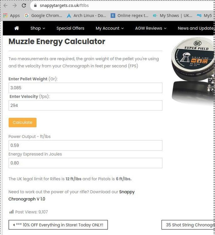

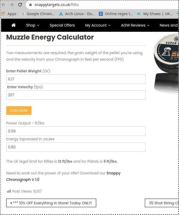

AirSniper Posted November 5, 2021 Author Posted November 5, 2021 SO... a 0.2g BB is a 3.08 grain BB and a 0.4g BB is a 6.17 grain BB Assuming that there is a fixed 0.8 Joule limit on the power of the RIF in this example, you will get the following results for the muzzle velocity. From that you can calculate the range over time and the known act of gravity and air resistance and so on, get an accurate range and flight path. On this Airgun site, the data about the RIF that a comment in a thread was referring to, this again, shows that the very same ballistics calculators work for airsoft as they will for live round shooters. I have shown that to go faster you need a lighter BB, this speed affect the flight time because its is also a measure of distance over time, per second, so if you have a BB with a 4 second flight time before it drops out, its chrono was 200 fps, then you know its travelled 800 feet. or 243 meters. If you could throw a stone through a chrono and time it, you would be able to work out the amount of KE you put in to that projectile. So I don't see why people are finding it hard to believe that the same math for ballistics applies no matter the scale or where you are.
