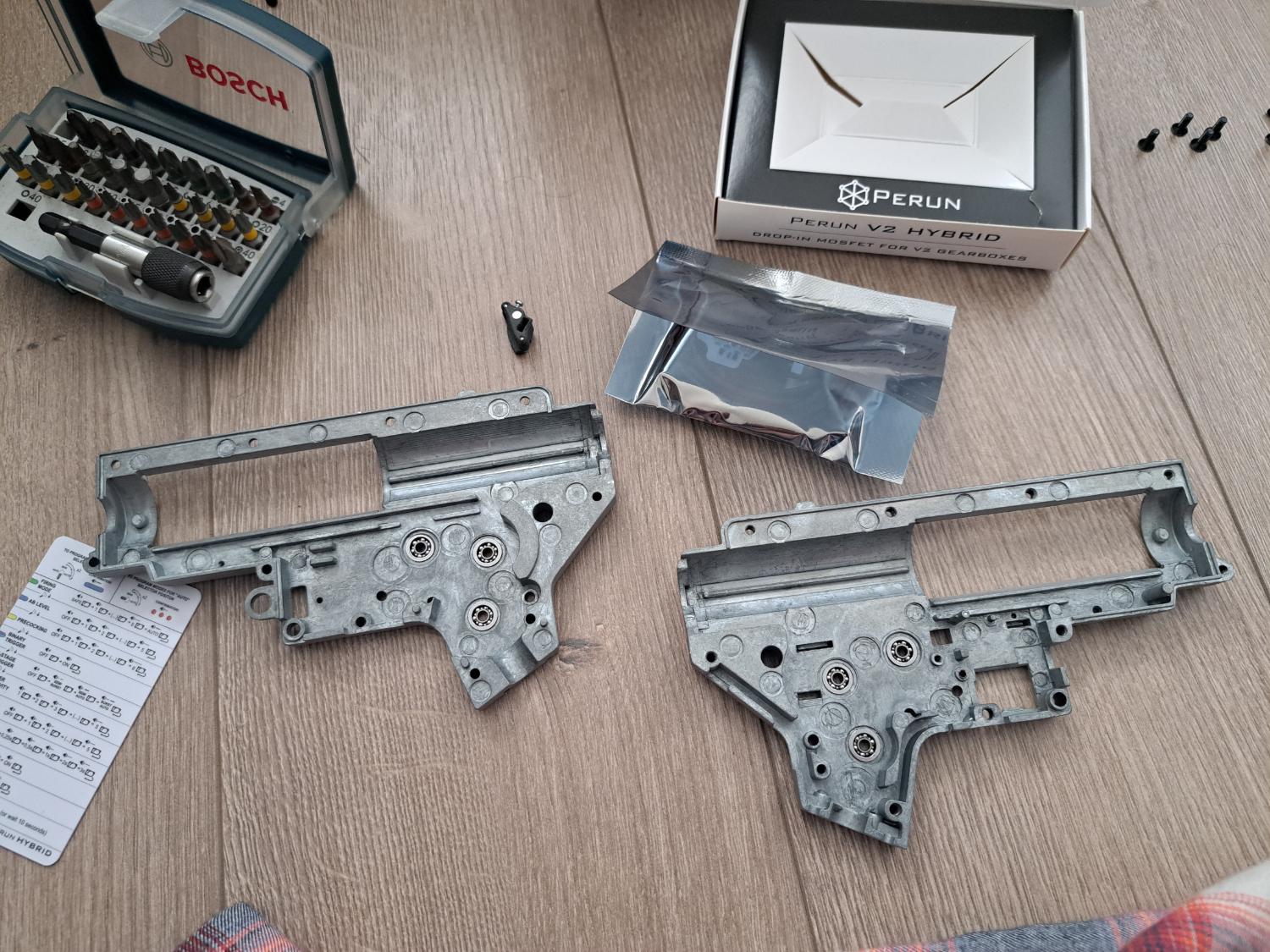

Herrgh Posted April 19 Posted April 19 Happy Easter all. Apologies for the necro, but there is no better thread for me to run in a panic to when I inevitably balls this up. My beloved completely stock M906C gave up the ghost earlier this year, and after cracking it open I (rightly or wrongly) determined that the Falcon ETU was just broken, refusing to turn the motor (and only beeping after a lot of coaxing from me. Its been a while and I foolishly didn't write down what exactly it was doing). All other parts appeared to be in good working order, nothing stuck or caught. So I'm sticking a Perun from @ak2m4into it, new bearings (cos why not), new XT 6.02mm stainless barrel (cos I like the colour and I had a new G&G hop up unit that I wanted to pair with it) and a new m105 spring. Motor I'll sort out later. Please pray for me. Galvatron and ak2m4 2
Herrgh Posted April 20 Posted April 20 I've already run into my first problem: The Perun won't sit flat against the side of the gearbox case because of the "bump" circled below. The Perun magnet holder that is affixed to the trigger is making contact with the horizontal post indicated with the arrow. As far as I can tell the "bump" doesn't appear to do anything. I'll have to file these down to make everything fit. What tool do I need to obtain to do this?
mightyjebus Posted April 20 Posted April 20 it's pot metal, either snap it off with a pair. of pliers or use a dremel Herrgh 1
Colin Allen Posted April 20 Posted April 20 Do not remove the post; the magnet holder should rest against it. You will need to dremel off the raised screw hole that you have circled. The manual is here: https://perunairsoft.pl/hybridv2.pdf Herrgh 1
Herrgh Posted April 21 Posted April 21 19 hours ago, Colin Allen said: Do not remove the post; the magnet holder should rest against it. You will need to dremel off the raised screw hole that you have circled. The manual is here: https://perunairsoft.pl/hybridv2.pdf Yes, apologies, I misread the instructions as saying that the magnet holder shouldn't be in contact with that post (it should!) I don't have a dremel to hand but some hand files have done the trick. Have done the sensor tests and it's all working! Now to reassemble it without too much cursing (ambi controls and working ambi bolt catches make for a poor first timer attempt at this sort of thing...) Colin Allen 1
Colin Allen Posted April 21 Posted April 21 1 hour ago, Herrgh said: Yes, apologies, I misread the instructions as saying that the magnet holder shouldn't be in contact with that post (it should!) I don't have a dremel to hand but some hand files have done the trick. Have done the sensor tests and it's all working! Now to reassemble it without too much cursing (ambi controls and working ambi bolt catches make for a poor first timer attempt at this sort of thing...) Excellent! Well done! I tend to disable the ambidextrous mag catches as they are a pain and I am not bothered by them. I sometimes do the same with the ambidextrous selectors as well. ak2m4 and Herrgh 2
