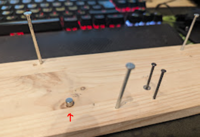

RostokMcSpoons Posted December 27, 2021 Author Posted December 27, 2021 I went off, had a bite and a beer and came back to it. Decided to build a jig to hold things (especially the trigger) in place as I'm closing the shell... "Ta-da" Yup, just a block of wood with some appropriately placed nails... Worked a treat, put the shell back on and wiggled things into place on my second attempt! Connected up to the motor, bound up on the first shot. I didn't check the gear positions before I closed it (bound to miss something). Problem is, when I opened it up again, with the spring half-cocked, the spring released and *something* went flying over my shoulder, probably lost for a month or two. I think it's just one of the shims. All the springs are present and correct.
RostokMcSpoons Posted December 27, 2021 Author Posted December 27, 2021 (edited) Blimey. Still not got it back together. Made one change to the jig - drilled a hole under the anti-rev latch's position, stuffed a couple of neo magnets in there, stacked a couple more on top - latch held in place My main spring finds new and exciting ways to escape before everything lines up. I know it's just a matter of strong fingers in the right places, plus perhaps a little bit of luck, but it's not happening. Even if I keep the spring inside the shell, if it 'jumps' then it dislodges the bracket the trigger contact slider sits in, and I have to remove the tappet plate to reposition it. Arrggggh. But anyway... I've rehearsed lining up the shell without the main spring. I can get all the pins to locate and the shell to snap shut nicely. The problem is the gears are wobbling around. I don't think it's the fact I've probably lost 2 or 3 shims with the the spring flying about, the sector is moving perhaps a full 1mm sideways. Perhaps that thing that flew by my ear was important after all I certainly can't put it back together without a bunch of shims at least, and I don't have any. Can I get them from Screwfix? edit: looks like screwfix is a 'no'. Looks like I'll be making an order before I can continue. Might as well get some proper parts too! Edited December 27, 2021 by RostokMcSpoons Nick G 1
Supporters Adolf Hamster Posted December 28, 2021 Supporters Posted December 28, 2021 oh dear..... to start off with the main spring- you can shove a screwdriver (or similarly sized pokey thing) through the back of the spring guide and use that to help hold it in position. some v3 casings might not have a hole in the back of them to accomodate (usually for v2 boxes they do as that's a stock attachment point) but you can file a hole in the casing. usually, if you seat the spring guide nicely then hold pressure on the cylinder it shouldn't jump out too far- you can see the way he has his fingers through the window on the upper half when placing it in position. the sector moving side to side defo sounds like you've lost a few shims. i'd say get a pack of @ak2m4's 0.1mm shims as they always come in handy: https://www.ak2m4.co.uk/internal-parts/bushings-shims/xt-shims-01mm-100-pack you can also get clips that help hold things into place, never used them myself but mostly because i've never got around to getting any: https://www.ak2m4.co.uk/gearbox-helping-hands-kit RostokMcSpoons, ak2m4 and Paul72 3

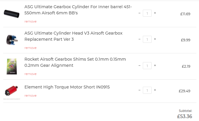

RostokMcSpoons Posted December 28, 2021 Author Posted December 28, 2021 Cheers, I definitely need a big bag of shims. My jig is actually doing a pretty good job for me so the helping hands clips aren't necessary. While the thing is in bits though, it seems sensible to upgrade any more parts at the same time. The cylinder and piston seen to be prime candidates, anything special I need to look for? I saw this https://www.patrolbase.co.uk/master-mods-full-steel-teeth-reinforced-upgrade-piston-set It's out of stock but is that a sensible upgrade?
Supporters Adolf Hamster Posted December 28, 2021 Supporters Posted December 28, 2021 kinda depends on your goals as to what parts you might want to change out. certainly for outdoor use i'd be thinking about air seal related components, particularly the nozzle, cylinder head & piston head. piston teeth is one that's debatable, there are good arguments for having plastic teeth as a failure point and steel racks aren't immune from failure (having the racks ripped out of them assuming the gears don't eat themselves first). that port cut is confusing me, looks kinda far for the barrel length of an f2000. where's @Sitting Duck when you need him he's better at this than me RostokMcSpoons 1

RostokMcSpoons Posted December 29, 2021 Author Posted December 29, 2021 (edited) @Asomodai thanks for that useful info! I'm looking at 15-20rps as my target. Current motor has 10 teeth Bevel gear has 30 teeth Spur gear has 39 teeth Sector gear has 30 teeth If I've counted correctly and used this: http://airsofttech.dk/Calculator.cshtml correctly, that is 17.55:1 (If the spur has 40 that would make it a round 18:1 ratio, so it seems likely I miscounted there!) So looking at your recommendations I'd need quite a high speed motor to turn those rapidly, with commensurate high battery drain, and perhaps a a higher wear rate... those don't worry me toooooo much... I just watched the Airsoft Tech explain about volume ratios... https://www.youtube.com/watch?v=LT0ptGQMc5g&t=628&ab_channel=TheAirsoftTech The preferred cylinder to barrel ratio for my preferred 0.28g BB's should be 1.5-1.8, according to him. I measured the internal length of the cylinder from port to back of the cylinder head as 22.3mm, with a cylinder radius of 11.7mm giving a total cylinder volume of 9,590mm3 With the barrel length as 420mm with an internal radius of 3mm giving a total barrel volume of 11,875mm3 That gives a cylinder / barrel ratio of 0.8075 Oh dear...? I'm off to look for a possible set of parts. Edited December 29, 2021 by RostokMcSpoons Added actual figures, cleaned up
Asomodai Posted December 29, 2021 Posted December 29, 2021 (edited) 2 hours ago, RostokMcSpoons said: @Asomodai thanks for that useful info! I'm looking at 15-20rps as my target. Current motor has 10 teeth Bevel gear has 30 teeth Spur gear has 39 teeth Sector gear has 30 teeth If I've counted correctly and used this: http://airsofttech.dk/Calculator.cshtml correctly, that is 17.55:1 (If the spur has 40 that would make it a round 18:1 ratio, so it seems likely I miscounted there!) So looking at your recommendations I'd need quite a high speed motor to turn those rapidly, with commensurate high battery drain, and perhaps a a higher wear rate... those don't worry me toooooo much... I just watched the Airsoft Tech explain about volume ratios... https://www.youtube.com/watch?v=LT0ptGQMc5g&t=628&ab_channel=TheAirsoftTech The preferred cylinder to barrel ratio for my preferred 0.28g BB's should be 1.5-1.8, according to him. I measured the internal length of the cylinder from port to back of the cylinder head as 22.3mm, with a cylinder radius of 11.7mm giving a total cylinder volume of 9,590mm3 With the barrel length as 420mm with an internal radius of 3mm giving a total barrel volume of 11,875mm3 That gives a cylinder / barrel ratio of 0.8075 Oh dear...? I'm off to look for a possible set of parts. You're over thinking it. Don't worry about the volume calculator, the cylinder types/volume matching for AEGs are well known. The calculator is more for oddball setups and sniper rifles, just get a full non windowed cylinder. The teeth on your gears and motors are all standard as it's a standard AEG so don't worry about counting them. If you do replace the piston I recommend going with a 14 1/2 tooth or a 14 tooth piston instead of a 15 tooth for better AOE. High speed motors also create alot of heat. Almost no one goes for high speed motors anymore because of the downsides, they only exist because high speed gears didn't exist a decade or so ago. And it was the easiest way to gain lots of RPS. We now have high speed gears and high torque motors readily available which when combined give better performance, better efficiency and lower heat. If your aim is the lowly RPS you mentioned and you want to keep the stock gears just get a 16tpa neo motor. Which gives a reasonable bump in trigger response and RPS without having to replace the gear ratio. Edited December 29, 2021 by Asomodai RostokMcSpoons 1
RostokMcSpoons Posted December 29, 2021 Author Posted December 29, 2021 Me, over-thinking things? Shurely shome mishtake Thank you so much for that. I'll amend my shopping list accordingly... back with that shortly.
RostokMcSpoons Posted December 29, 2021 Author Posted December 29, 2021 There's a full length un-ported cylinder, and I guess I need the new cylinder head too? The Element motor description doesn't have the TPA, but I'm thinking lower cost = lower TPA I'd like to keep the costs down (obviously) but there's only so many times my sanity and inexperienced tech skills will allow me to try to re-assemble this gearbox ... So is it stupid to carry on with the existing piston and piston head?
Asomodai Posted December 29, 2021 Posted December 29, 2021 (edited) I'd change the piston head too, keep everything to do with air seal the same brand. Obviously get some silicon oil to apply to the piston head and cylinder head whilst fitting. Edited December 29, 2021 by Asomodai RostokMcSpoons 1
RostokMcSpoons Posted December 29, 2021 Author Posted December 29, 2021 (edited) @Asomodai Right about now I'm finding it very disappointing we don't have an animated GIFs feature, in which I could search for things like "I love you and I want to have your babies" That goes for you too @Adolf Hamster Cheers guys, much appreciated! Order done! Edited December 29, 2021 by RostokMcSpoons
Supporters Adolf Hamster Posted December 29, 2021 Supporters Posted December 29, 2021 worth mentioning seeing as you're going for replacing the air seal components to think about the nozzle too, especially if the stock one doesn't have a sealing o ring. otherwise that's pretty close to what i'd be thinking of dropping in there, i always struggle to recommend specific parts because there's always that chance X part might be off and won't work (which i've had plenty of times, it's how you accumulate a parts box) those silent type piston heads can push the aoe back, which depending on the gun might mess things up although it looks in this case (using very rough judgement based off one picture) it looks like there's room for it to shift back anyway. RostokMcSpoons 1
Asomodai Posted December 29, 2021 Posted December 29, 2021 12 minutes ago, Adolf Hamster said: worth mentioning seeing as you're going for replacing the air seal components to think about the nozzle too, especially if the stock one doesn't have a sealing o ring. otherwise that's pretty close to what i'd be thinking of dropping in there, i always struggle to recommend specific parts because there's always that chance X part might be off and won't work (which i've had plenty of times, it's how you accumulate a parts box) those silent type piston heads can push the aoe back, which depending on the gun might mess things up although it looks in this case (using very rough judgement based off one picture) it looks like there's room for it to shift back anyway. AOE on mine needed alot of correcting hence why I recommended the silent piston head. Nozzle is going to be difficult because AUG style nozzles are different sizes and not easy to get. I'd stick with the current one and load it up with silicon oil. The stock Cyma ones really are not that bad despite how cheap it looks. RostokMcSpoons 1
