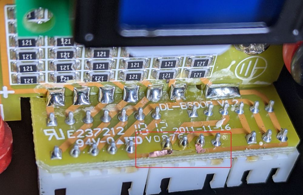

paradoxum Posted January 28, 2022 Posted January 28, 2022 (edited) Long story short I shorted the balance connector on my imax, took it apart and I've blown the trace on it. Is this how it should look? Or does it skip the middle one (by the looks of it?) If anyone has one and can help just take the screws off the side panels and slide it out, take a picture of that part for me? Any tips for fixing myself? Edited January 28, 2022 by paradoxum

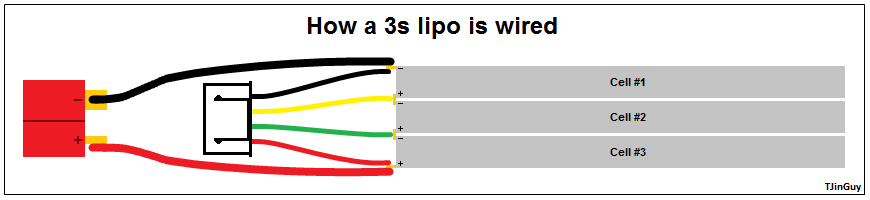

Iceni Posted January 29, 2022 Posted January 29, 2022 (edited) Because of the price of them I'd just buy a new one and throw that one in the bin. It's not worth the effort in attempting a repair that may cause other issues. An ebay clone is £20-25 delivered. Looking at the pins from left to right. (Red, Green, Yellow, BlacK) in that order. The common trace looks to be an earth. (K) Looks to me like the common trace does not connect to 1, 2, or 3, (left to right) (RGY) but does connect to 4. (K) That's backed up in this image of a JST pin out. So it you did want to attempt a repair I would Use a single bridge wire from the far right on the 5 pin (K), to the far right on the 4 pin (K), and remove all possible foil that could cause a short between pins 1-3 (RGY) on the 4 pin. Edited January 29, 2022 by Iceni Rogerborg 1

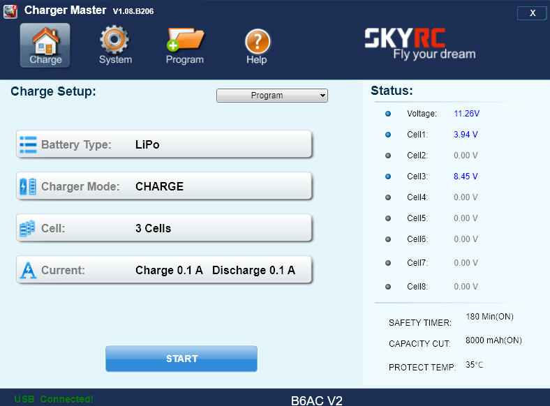

paradoxum Posted January 30, 2022 Author Posted January 30, 2022 (edited) Well I had a go. I soldered two of the points between the burnt trace, checked for continuity, all good. Still not working: https://streamable.com/s6r7nv Not sure what else to try. And cheap? They are like £60! Seems to be an issue detecting Cell2. Any ideas? I checked under the board and there's no blown things there. Edited January 30, 2022 by paradoxum
paradoxum Posted January 30, 2022 Author Posted January 30, 2022 Well I did as much as I could and the continuity all checks out but still can't see cell2. I just turned off balance in the settings now I can charge lipos for the time being. I found this thing: https://www.amazon.co.uk/Parallel-Charging-Board-Battery-Charger/dp/B07BSHN8T2 It seems to plug into a difference balance connector on the imax, perhaps this would get around the issue and work?

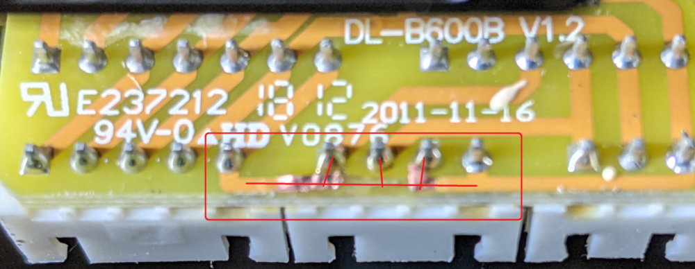

EDcase Posted January 30, 2022 Posted January 30, 2022 (edited) Got mine open: It does look the same as your jumper version so something else must have blown without showing any signs. As a replacement I would suggest to look at the SkyRC range. Something like this: https://www.modelsport.co.uk/product/skyrc-s65-ac-charger-65w-438918 Edited January 30, 2022 by EDcase Paul72, paradoxum and Rogerborg 3

paradoxum Posted January 31, 2022 Author Posted January 31, 2022 1 hour ago, EDcase said: If interested: It's genuine
EDcase Posted January 31, 2022 Posted January 31, 2022 Maybe worth sending to Big Clive then... paradoxum 1
Supporters Lozart Posted January 31, 2022 Supporters Posted January 31, 2022 19 hours ago, paradoxum said: Did you solder that with your eyes shut? Tackle, paradoxum and Rogerborg 3
