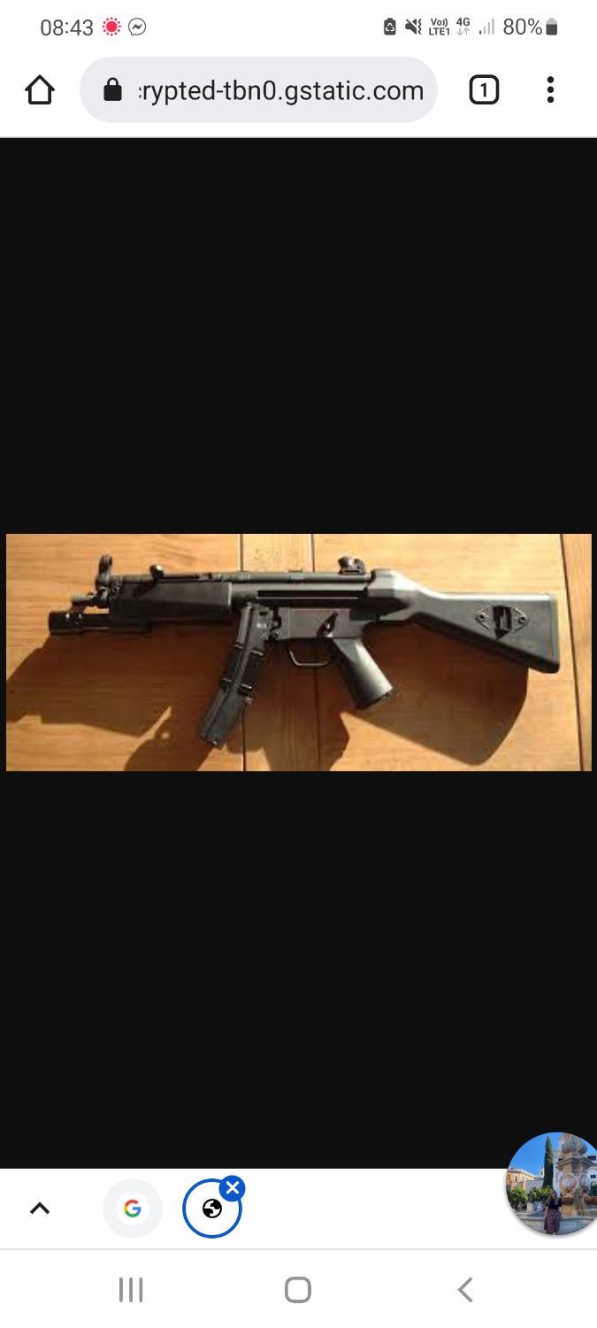

And I ordered the one I did thinking it would be straight forward to change out the stock switching between collapsed and fixed regularly. Hopefully I can take it to a local Airsoft shop if I really want to change it round. For now though I'm trying to replicate this as best I can so I'm happy with the fixed stock for now.
