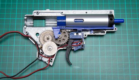

ModernTimes Posted March 31, 2022 Posted March 31, 2022 I currently have a Specna Arms SA-C08 CORE™ Carbine AEG and I have replaced the stock M90 spring with a M115 spring. I don't have a chronometer to test the improvement that was made but I was told by multiple people that this was a good quick way to upgrade the gun so I decided to go ahead and pick up a spring since it was cheap anyways. From this point on I have no clue as to what I should upgrade next or buy. I'm not overly interested in cosmetic stuff I just want to focus on getting together the upgrades necessary for the gun to be an absolute beast on the field and focus the specs into range, super fast semi-auto fire (since I am considering a DMR build) and reliability (so the gun doesn't end up breaking after a year due to wear and tear on the components). If anyone could give me some hints or pointers on what you think I should do next or how you think I should proceed it'd be greatly appreciated!

Popular Post ak2m4 Posted April 1, 2022 Popular Post Posted April 1, 2022 My advice is put the M90 back in and just play with it for a few games. Go and watch some upgrade video's on YT, so many great resources out there. Lot of people rush into upgrades but only end up breaking their only AEG. You say you want a DMR, would this be a 2nd AEG or are you planning on converting the CORE? Hudson, george1976, Nick G and 2 others 5

Supporters Adolf Hamster Posted April 1, 2022 Supporters Posted April 1, 2022 to echo above the first thing you're gonna want is a chrono if you're going to be messing around with springs etc. not only can it check the power is correct, but it's a good measurement for consistency and wether or not any remedial work done to the air seal has actually helped. on the subject of which for range/accuracy you're gonna want to look at the following (in order of difficulty-performance ratio): 1. clean the barrel, and get into the habit of cleaning it regularly. a good rule of thumb is before every game day although sometimes even during a game day might be necessary (especially with a tighter bore) 2. feed it good quality heavier ammo, even the best gun in the world will shoot like shit if you stuff some bulldog 0.12's in it. how heavy is a toss up between your usual round count and your bank balance but generally the 0.28-0.32g range tends to be a good compromise for assault style play. 3. tying into 2 is to look at the hop, doesn't need to be difficult just a drop-in setup like the maple leaf macaron+omega nub combo when installed properly will help spin up the heavies. the longer feedlips can occasionally cause feeding issues in some guns and for those i'm a fan of the pdi w-hop with standard nub (although that'll struggle with really heavy ammo). 4. consistency- you'll need a chrono for this. you want to be addressing any potential leak so that every last molecule in the cylinder is going nowhere but down the barrel propelling the bb. the way to check this is to chrono a few shots and semi and see what sort of range of values you get, the smaller this range the better. this involves cracking open the gearbox too so a big step up in the difficulty. 5. energy- this is where you've jumped ahead to already, but the reason to wait until you're sure the air seal is good is you want to be sure the spring your using is only as strong as it needs to be to get the energy you need. if you have a bad leak and compensate with an overpowered spring you're just loading the box unnecessarily and with less resistance the piston slapping home isn't going to be happy. you don't need to be too exact, being a few fps under the limit won't be a massive loss in range but it might make the difference if the battered to crap filled with shattered nuprol bb's and soaked in mildew from sitting in a shed site chrono doesn't read so precise any more. 6. barrel- at this point the rest of the system should be getting good enough to justify a better barrel, gains aren't likely to be massive here (we're getting to the steep bit of the diminishing returns curve) but something like the ZCI 6.02 stainless barrels are cracking value for money. length wise just stick with the same length as stock, extending the barrel length won't help performance and indeed can actually make things worse if it starts under-voluming the system. worth noting whilst i'm using the conventional "fps" terminology, that's actually "fps equivalent for a 0.2g bb", when using heavier ammo the raw fps number the chrono spits out will be lower, but don't be fooled into thinking that means less range, the energy (aka joules) is what matters (for site compliance) and even if it's travelling slower heavier ammo at the same energy does travel further (among other advantages). as for semi-auto response, these days that's easier than ever thanks to the abundance of mosfets with precocking. that'll take a lot of the perceived delay out of the equation without messing with rate of fire in auto (and the potential problems driving a gearbox too fast can have). pair that with a decent motor (warhead brushless being the current kings for pickup speed, although they're not exactly cheap) and you're pretty much there already. Nick G and ModernTimes 2
Supporters Rogerborg Posted April 1, 2022 Supporters Posted April 1, 2022 Do the CORE models have the Orion gearbox? If so, they're a poor choice for a DMR build, as they're notoriously prone to cracking. Well, I say that, but I'm using an Edge with an Orion as a 1.8J+ DMR and it hasn't let go yet. An M115 spring is notionally going to get you 377fps / 1.32J, so congratulations, you've just built a Section 5 prohibited firearm, go directly to jail. Really though, that's likely to be way too hot for any UK sites. Why on earth you'd put an M115 in it without a chrono boggles the mind. Do you know what it was shooting at with the M90? Either way, I'd get that back in there before you play next. 1 hour ago, Speedbird_666 said: The only thing I would change from the outset would be the stock motor, swapping it for an SHS/Rocket Hi-torque. I would leave everything else as-is, and give the barrel a good clean. And fucking around with springs without a chrono is a really bad idea. I echo all of the above. Or if you want to chisel a few £££ and aren't in a particular hurry, the Big Dragon M140 motors (or "mortors") from AliExpress can come in a bit cheaper and are pretty meaty. 33 minutes ago, Adolf Hamster said: maple leaf macaron+omega nub combo Yup. I'd take careful note of what's already in there as well, I'm pretty sure that my Edge came with an unannounced flat hop bucking and nub rather than the more usual mounded bucking and cylinder nub. Those work together as a pair and are unlikely to pay well with individual alternatives. The CORE may not have a flat hop though, and you're unlikely to go far wrong with a Maple Leaf bucking and nub combination. ModernTimes and Nick G 2

Speedbird_666 Posted April 1, 2022 Posted April 1, 2022 41 minutes ago, Rogerborg said: Do the CORE models have the Orion gearbox? No, they don't from what I've seen. Different OEMs. Black shell, looks a lot like an E&C. Nick G and Rogerborg 1 1
Supporters Rogerborg Posted April 1, 2022 Supporters Posted April 1, 2022 32 minutes ago, Speedbird_666 said: No, they don't from what I've seen. Different OEMs. Black shell, looks a lot like an E&C. Ah, right. Might actually be a better route to go then.
ak2m4 Posted April 1, 2022 Posted April 1, 2022 (edited) 3 hours ago, Speedbird_666 said: Black shell, looks a lot like an E&C. Not an E&C, can tell by the screws, could be one of the new ZCI though. Edited April 1, 2022 by ak2m4 Speedbird_666 1
Speedbird_666 Posted April 1, 2022 Posted April 1, 2022 48 minutes ago, ak2m4 said: Not an E&C, can tell by the screws, could be one of the new ZCI though. Either way, it looks like a decent enough GB for upgrades though. Not heard any major issues with the CORE series, I would have one over an Edge any day. Rogerborg 1
Supporters Rogerborg Posted April 1, 2022 Supporters Posted April 1, 2022 2 hours ago, Speedbird_666 said: Not heard any major issues with the CORE series, I would have one over an Edge any day. Agreed, the X-ASR mosfet in the Edge is largely pointless, and actually a problem with higher draw motors.
Speedbird_666 Posted April 1, 2022 Posted April 1, 2022 1 hour ago, Rogerborg said: Agreed, the X-ASR mosfet in the Edge is largely pointless, and actually a problem with higher draw motors. Yep, I had one shit itself with an SHS hi-torque. Kept shutting down in semi auto with an error light blinking. Pile’o’shite that thing, like the rest of the Orion Gearbox. I see Cores are coming with X-ASRs now. I would avoid those.
Supporters Rogerborg Posted April 1, 2022 Supporters Posted April 1, 2022 23 minutes ago, Speedbird_666 said: Yep, I had one shit itself with an SHS hi-torque. Kept shutting down in semi auto with an error light blinking. Snap, with a Big Dragon M160 on 7.4V pulling a 1.8J M130-ish spring. Fine with that battery and spring and the stock motor, fine with an M90 spring and a Big Dragon M140 (at 7.4V or 11.1V), but craps out at pulling anything harder and faster. A basic mosfet is great to allow more current flow, but only it if does allow more current flow. This is ticking a feature box while not really doing anything useful.
