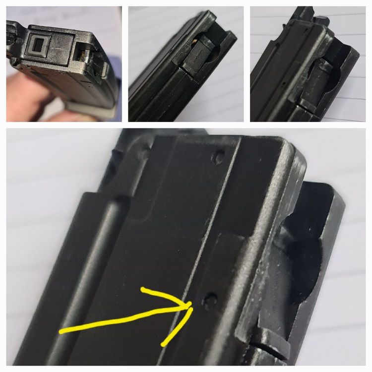

@rocketdogbert I'll post a pic or video when I take a look tomorrow, so you can see what the deal is.
@rocketdogbert this is what I'm facing:
my plan is to punch out the little pin highlighted, remove the flappy bit, then remove the valve, unless you think that's mental?
The mag just vents any gas you put in which would point to the knocker valve, as you said, being jammed.
looks about right, vents when you put gas in, or when you load the mag in the gun?

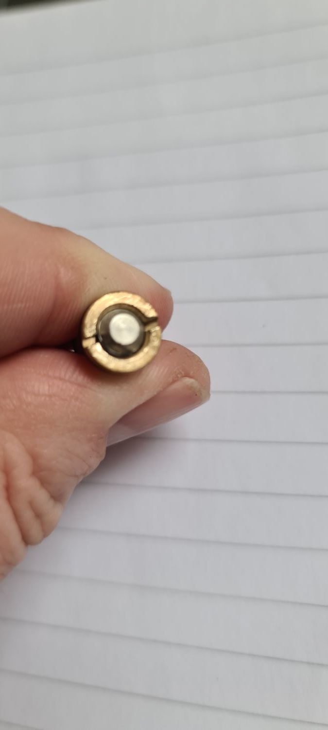

When I put gas in. I've just removed the valve and can see that the spring has ridden over the silver bullet bit. At least I know it's just a case of replacing that. Now to find a part that's in stock...16497782802942531470942095493035.thumb.jpg.41bebbdeda54872fea6284e3a3e56346.jpg
