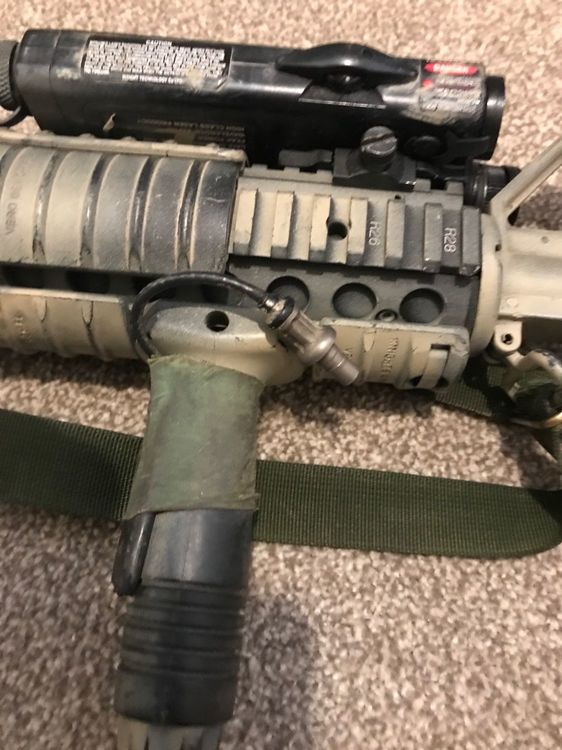

Khyber Posted May 12, 2022 Author Posted May 12, 2022 These ones.... They almost look like coaxial plugs. Have managed to salvage one from a switch as the wire is too short so can add my own length to it. But would be nice to be able to buy a few so i can make pressure switches the right length and hide wires inside handguard etc.. Rogerborg 1

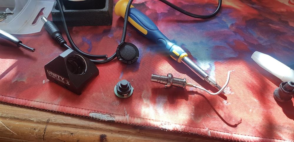

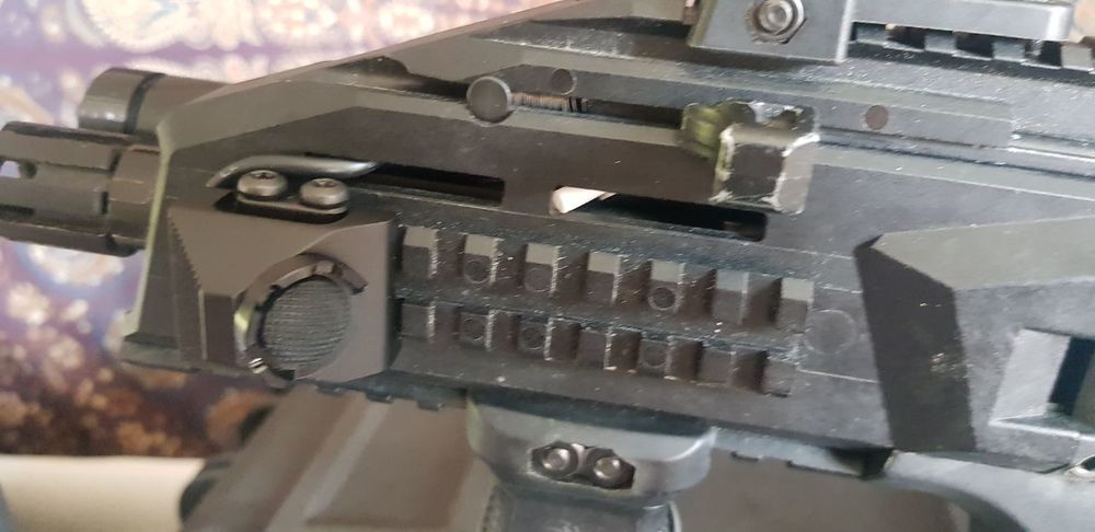

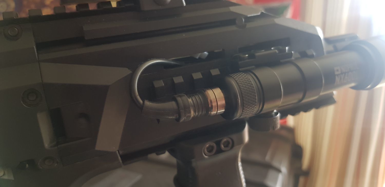

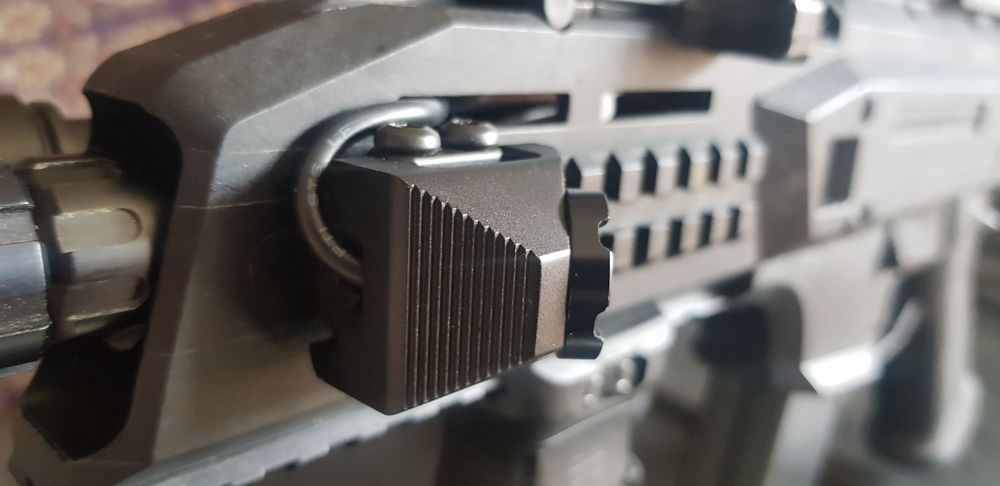

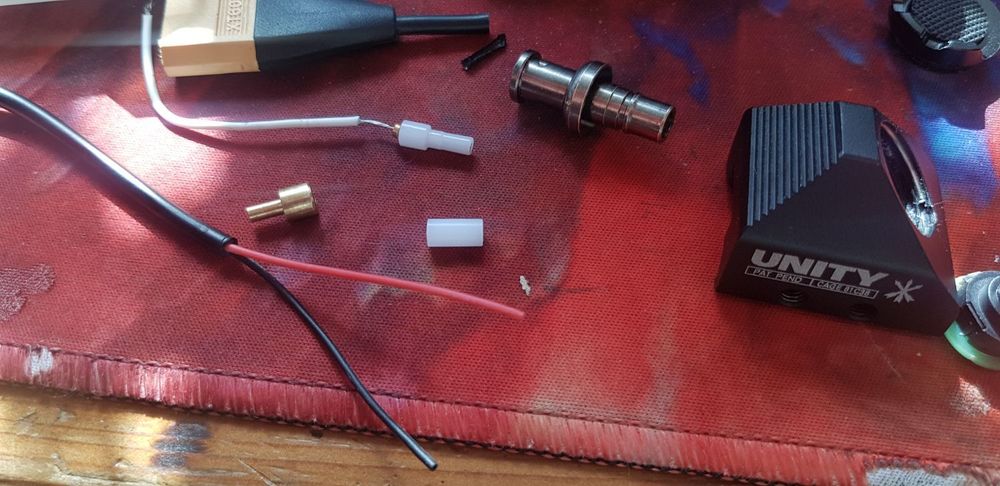

Khyber Posted May 13, 2022 Author Posted May 13, 2022 Managed to re use an old plug and solder a longer length of wire to it, whilst I was at it I threaded it through the handguard and also made my Unity button into a momentary switch as I prefer that to on/off. Had to disassemble the tiny button and basically super glued the 2 'clicky' parts together to remove the function and make it permanently momentary. If you ever wondered how clicky pens worked as a kid and took them apart to find out like me, It's the same mechanism. ? Floperator, Lozart, JimFromHorsham and 1 other 3 1
