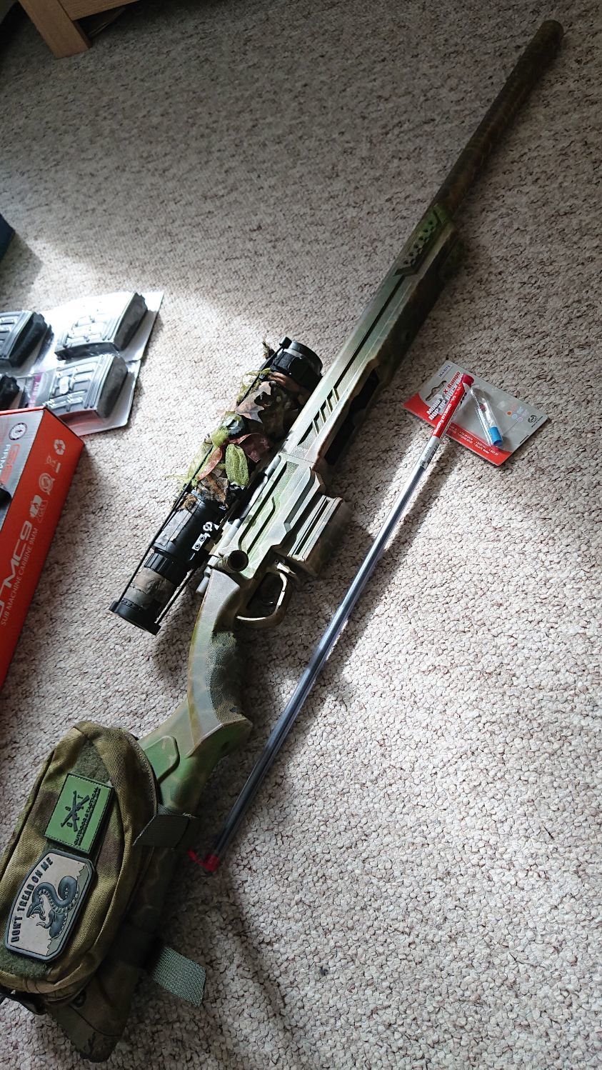

Supporters Rogerborg Posted May 28, 2022 Supporters Posted May 28, 2022 2 hours ago, Hudson said: It also comes with a 90º trigger as standard, so you'll save a lot of money when you come to upgrade. QFT. A new VSR 90 degree trigger box cost £100 just by itself. I thought I could get away with the stock Well box for a while, but the stopper wallered out really quickly with a 2.3J spring, as well as the trigger mechanism itself getting very shonky. While I'm generally a fan of buying cheap and twice, it's seems like a poor route to take with snipers. I did seriously consider the AAC T11 as a base for building a decent sniper, but went another way... 3 hours ago, Impulse said: [Evolution M40 parts list] All perfectly sensible, as are the base gun suggestions. But that's £100-£120 or so for those parts, then another £100 for a 90 degree trigger box, and now you're looking at SSG-10 money, shading towards Tac-41, plus the time and fiddling to put it all together. Meanwhile, I changed the Tac-41 spring (in minutes), dialled the hop in, and just played without any issues, literally laughing out loud at how well it performed. I like tinkering with guns, but it's getting tougher to recommend upgrading snipers given that you'll end up replacing very nearly everything internally chasing that last few metres of range or cm of accuracy, and likely end up paying as much or more as buying one of the viable out-of-the-box options now. What I don't want to do is to put @Dec7 off trying sniping by bumping the "must haves" price up. You can start off with something cheap to see if you enjoy the play style, and consider that a DE M52 costs half the price of a VSR 90 degree trigger box alone. Given my bad experience with the MB-03 trigger box, I'd stick with recommending. A £50 M52 and consider it as completely disposable, just for the experience. JG BAR-10 or CYMA CM.701 (the CYMA is £10 more but claims close to 2.3J out of the box, making it a wash) for the cheapest fully VSR compatible upgrade bases. Action Army T11 because of that trigger box (but you really will have to upgrade the spring and ideally the guide as it's startlingly low powered as stock) (What I really want to say is "Skip all that, go straight to Tac-41" but at £380 to field it, you have to be sure that it's something that you'll enjoy using) I'd consider both suppressors and bipods as completely unnecessary for any of the above, and just adding weight. I'll occasionally throw a bipod on because, well, I have a bipod, but it generally comes off again by lunchtime. Hudson 1
Impulse Posted May 28, 2022 Posted May 28, 2022 3 hours ago, Rogerborg said: All perfectly sensible, as are the base gun suggestions. But that's £100-£120 or so for those parts, then another £100 for a 90 degree trigger box, and now you're looking at SSG-10 money, shading towards Tac-41, plus the time and fiddling to put it all together. Meanwhile, I changed the Tac-41 spring (in minutes), dialled the hop in, and just played without any issues, literally laughing out loud at how well it performed. I like tinkering with guns, but it's getting tougher to recommend upgrading snipers given that you'll end up replacing very nearly everything internally chasing that last few metres of range or cm of accuracy, and likely end up paying as much or more as buying one of the viable out-of-the-box options now. Yeah, hence I don't recommend getting a new trigger box until you want to increase the power because they're pricey. I'm of the opinion that you run the Cyma or JG at the stock power until the sears explode, then swap it out Without a new trigger box, you can probably do the build for around £250 all in and run it until it dies. Then, if you like the playstyle, shell out for a Springer Custom Works S-trigger because they're the best damn triggers on the market, as well as the rest of the upgrades. I run a Springer Custom Works S-trigger, piston and spring guide in my spring build, even though it's only a 1.1J build because it was a 2.3J build at one point in time and I've never had any issues with it over years of use. For those, plus a new spring you'd probably be looking at around another £200, then if you want a teflon cylinder and a better cylinder head that's another £100 or so. It can get expensive fast! There are some very decent out of the box snipers, like the tac-41, SRS, Novritsch stuff etc, but in my opinion they just don't quite hit the same high level performance at the top end. Yes, they're a lot cheaper and they perform comparably for far less money, though it depends on if you think that consistency/range is worth the hundreds of £s extra and time investment that a custom build will cost. We come from opposite ends of the spectrum on that, as you're "buy cheap, buy twice" and I'm "buy once, cry once" and will spend months building a project to perfection, including pistols. Including trial and error costs, you don't want to know how much my HPA m21 build cost me over the years... ? Rogerborg 1
