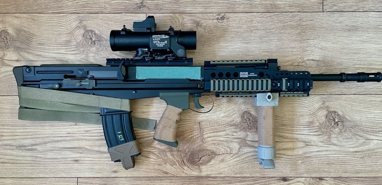

Nick G Posted August 29, 2022 Posted August 29, 2022 6 hours ago, lokkers said: WE L85A2. All stock internals at the moment, other than an LFS disc. Externally, replaced the polymer (plastic) foregrip with the Daniel Defence rail (Madbull, I think), and added the top picatinni rail. It's great fun to skirmish! Annoyingly, the dust cover catch has departed the upper receiver, so it's always open now. I need to see if someone can 3D print the part, as you can't get them aftermarket ? Have a look at KYAirsoft, they stock pretty much every part for the WE range, they just might have one. Love my L85 GBBR it's great to use.

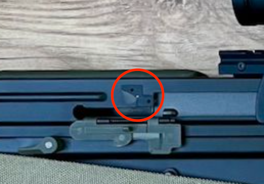

lokkers Posted September 1, 2022 Posted September 1, 2022 On 29/08/2022 at 21:24, Nick G said: Have a look at KYAirsoft, they stock pretty much every part for the WE range, they just might have one. Love my L85 GBBR it's great to use. They do - need to grab some bits from them, but they don't appear to do this part as normally it's pressed to the upper receiver. Nick G 1
sjhirst Posted September 1, 2022 Posted September 1, 2022 Is this what you're after? https://www.evike.com/products/47155/
lokkers Posted September 1, 2022 Posted September 1, 2022 5 hours ago, sjhirst said: Is this what you're after? https://www.evike.com/products/47155/ No, it's the catch on the receiver that's come off
Jacket2122 Posted September 1, 2022 Posted September 1, 2022 KYAIRSOFT do the bare upper part, Part 1. Easy to strip your old and replace with this. https://www.kyairsoft.com/parts/we-rifles-gbbr/l85-series/l85-1-gbbr.html
lokkers Posted September 3, 2022 Posted September 3, 2022 On 01/09/2022 at 19:18, Jacket2122 said: KYAIRSOFT do the bare upper part, Part 1. Easy to strip your old and replace with this. https://www.kyairsoft.com/parts/we-rifles-gbbr/l85-series/l85-1-gbbr.html I know. However I resent having to buy an upper receiver (plus postage) because a 50p piece of sheet metal wasn't properly attached in the first place. I'm going to ask around and see if someone can scan and 3D print the missing bit instead.
Jacket2122 Posted September 3, 2022 Posted September 3, 2022 I agree mate, it's a pain when something little requires the replacement of a big part. I just thought I'd give you a steer to the replacement. On the plus side its very realistic, the real steel is constructed with the same 50p sheet metal haha. lokkers 1
