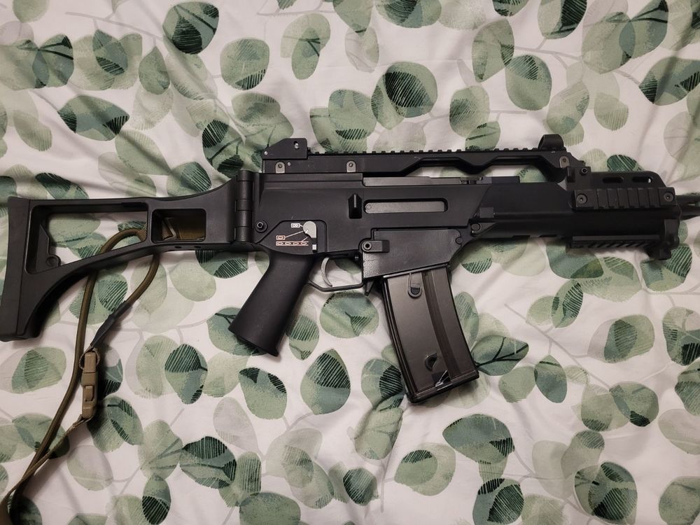

CrackCommandoUnit1972 Posted March 29, 2023 Posted March 29, 2023 Here is my good old WE G39c. Done a few mods on its including and NPAS, steel charging handle, maple leaf bucking and a tight bore barrel. Shoots like a laser but can be difficult to get under 350fps on a warm day. Nick G and SBoardley 2
