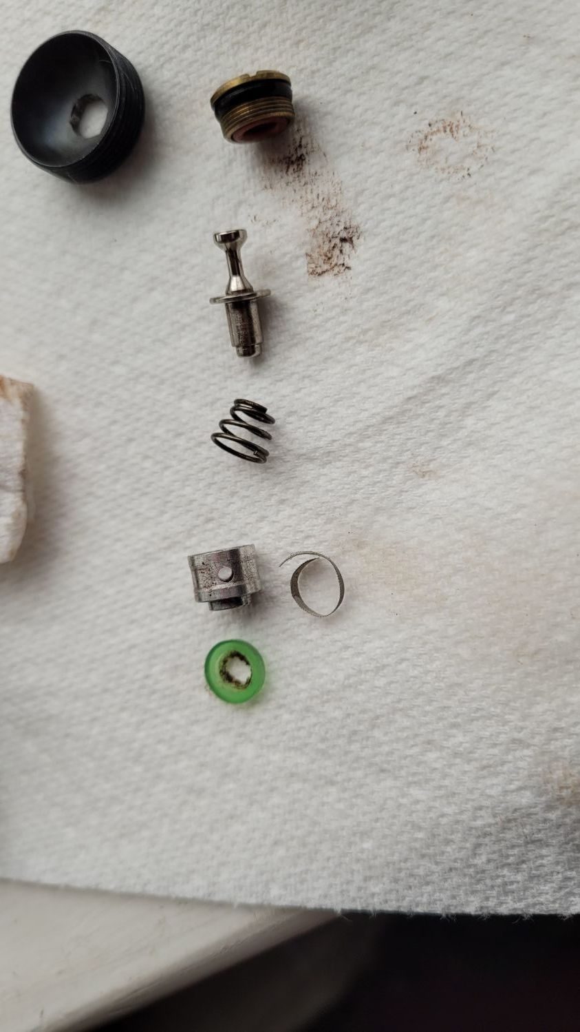

The actual sealing washer or gasket (the one that surrounds the piercing pin ) for most Co2 pistol mags is usually proprietary rather than a standard oring . Leaving co2 cartridges in the mag is the usual way of buggering them as they are under constant pressure and just deform .
you may find some cross compatibility from other mag service kits , try looking at the 4.5mm / .177 side of pistols as they are all Co2 and as such service kits a little easier to find.

Well its stripped down and I think the culprit is the green seat sealing ring. So that's the part I'd be looking to swap out/replace.
I found similar looking parts for glock mags but they have no sizing information on them so no idea if they would fit. I don't mind swapping out the green for an oring if someone knows what material will take the co2 temperatures.
