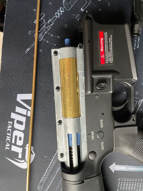

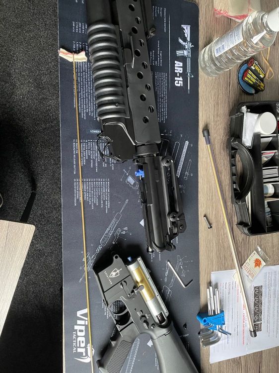

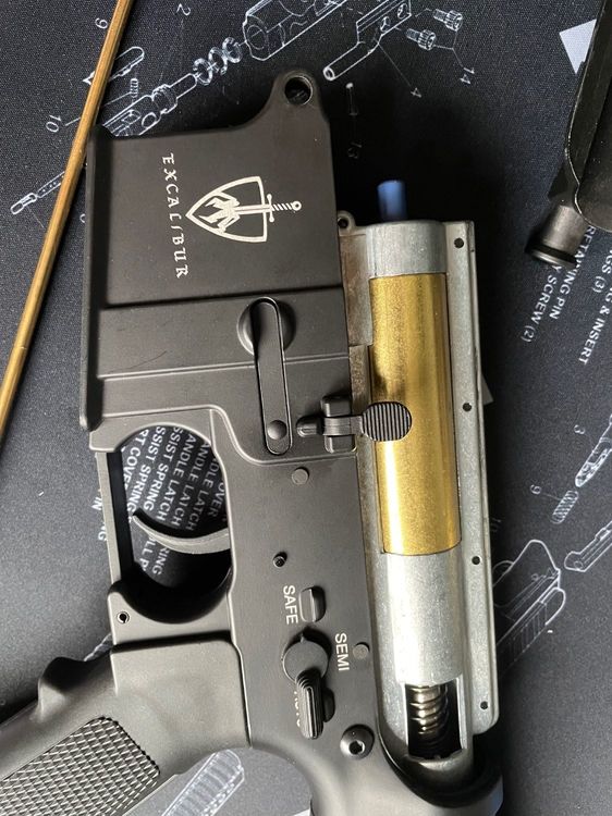

ak2m4 Posted June 7, 2022 Posted June 7, 2022 14 hours ago, Fatboy40 said: I wonder what sort of cylinder that ships with as stock ? I did wonder this as well. I've never seen an E&C with a closed cylinder before, they don't advertise it in their catalog either which is why the 500mm inner barrel threw me a little. @KarlosM15 let us know when you fit the new inner barrel will you please.
KarlosM15 Posted June 8, 2022 Author Posted June 8, 2022 Thanks for your input guys, I’ve ordered a ZCI 509mm barrel and maple leaf hop with the omega nub from AK2M4 so hopefully turns up this week! I will let you know about cylinder when fitting barrel may throw in a pic too! thanks again gentlemen Fatboy40 1
ak2m4 Posted June 8, 2022 Posted June 8, 2022 @KarlosM15 it arrived today according to the tracking, give us a pic when you get a chance ?
KarlosM15 Posted October 11, 2022 Author Posted October 11, 2022 Sorry it’s late but here’s couple pics of gun
