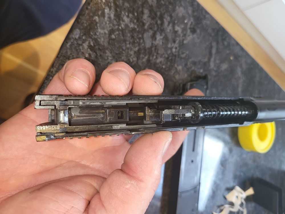

My lad's R32 has always been a pain.  It doesn't seem to want to fully fill that magazine, often only getting a single shots worth of gas.  When. It does get enough for a bit more it goes off like a teenager's first time....
Several rapid fires in a burst then a little pop.
At first we thought it was just cold weather and crap gas, so I cleaned the gun, bought some decent green gas (which is fine in my Glock l), but the problems remain.
I can't seem to get a clean seal on the Inlet valve when filling either.
The mag doesn't appear to leak what gas it does hold, but I'm wondering if it is a faulty gun or a faulty mag.
Any ideas gratefully received. A few pictures attached, not that I can see anything out of place.  A link to it not working here  https://youtu.be/rjYYOm4Bs7c.

Honestly? Throw it in the bin and buy something with a decent mag capacity, it will never work well
We're talking mags.... Not the whole gun?
Tinkering with it now, and the kick from the slide going back after pressing slide stop isn't great compared to the Glock.  Could that explain the uncontrolled rapid fire?

The whole gun. There isn’t the capacity in the tiny magazine for enough gas to cycle the slide properly,
The 1911 grip isn’t big enough.
Even the TM with a polymer slide isn’t anywhere nearly as good as a Glock. You’re on a hiding to nothing trying to get it to work, sorry.
Look for a pistol with a decent sized magazine ( hi-capa is the closest looking to a 1911 with a  decent mag capacity , but DO NOT buy a WE hi-capa, one of their poorer pistols)
