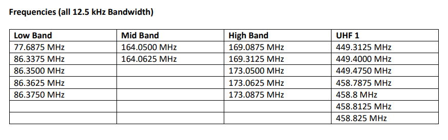

Leah Posted September 20, 2022 Posted September 20, 2022 Hello, I bought an Ofcom license in March 2020 for the ability to use radios while playing Airsoft. However, it has been unused since lockdown. I'm now trying to get back into Airsoft, but I cannot remember how the license works. I have the option of using one of multiple bands all on a 12.5 kHz bandwidth. These include: Low Band (77 MHz-86 MHz), Mid Band (164 MHz-164MHz), High Band (169 MHz-173MHz) and UFH1 (449MHz-458MHz). I'm assuming that means I can use any of the frequencies listed? But i'm not 100% certain on that - plus I'm not sure what band is best to use? We use UV-5R radios.

Leah Posted September 21, 2022 Author Posted September 21, 2022 14 hours ago, Chev Chelios said: I am assuming you have the one you just fill in and pay £75 rather than completing the 6hr foundation course? Hi, that's correct. I never did a foundation course, maybe I would know this stuff if I had lol. I never got as many frequencies as you just showed me. I got 17 in total across all of the bands.

Pseudotectonic Posted September 21, 2022 Posted September 21, 2022 Ok I just checked the actual Ofcom wording and you may be right. (On the license it says "the Licensee and any person authorised to act on the Licensee’s behalf is hereby authorised to send and receive...") Although I would argue if you are the licensee you should also technically own the entire fleet of radios that you authorise other people to use. Although in reality I don't imagine it is at all policed/enforced unless someone is seriously messing about using your license prompting some sort of action by Ofcom. At which point you the licensee will also be responsible (if you are ratted out). For frequencies, you can use any of the frequencies listed on your license. Among the ones you listed the UHF frequencies (4xx Mhz) will be most practical because the same antenna will work for PMR446 so your baofengs can be set up to access both sets of frequencies. So you can play with walk-ins if they can't or don't want to reprogram.

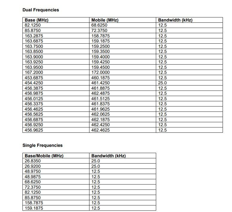

Leah Posted September 22, 2022 Author Posted September 22, 2022 11 hours ago, Chev Chelios said: Leah, how many UV-5Rs do you see kicking about? These are illegal to transmit on PMR as the equipment is not permitted to transmit over a maximum power of 0.5 watts, even on low power they transmit more power than is legal in the UK for the PMR446 allocation. Even it it was 0.5 watts they have a removable antenna and that excludes them being used on PMR. The ones I have don't even carry CE Marks. I would never advise anyone to break the law but do your own research and I think you will come to the same conclusion as me, that nobody cares if you are using "business radios" with or without a licence or using high power radios to transmit PMR. Which is the reason I bought the Ofcom license, so I don't have to transmit on the free frequencies? or am I misreading something here. 23 hours ago, Tommikka said: The guidance notes via the link below would generally cover airsoft users as a team (under incorporated association of people with a common interest) or an individual. An individual won’t have much use of a radio channel. But under either you can have handsets configured to an appropriate channel and let some extra people use the same channel to talk to them for the day under your licence (you could hand them a handset from your collection, let them Programme in your frequency, or as there are common frequencies which others may be licenced to use just agree on the one to use today - and conversely to use different ones so you are separate) Incorporated Association Is a group of people who share a common interest. Individual or Sole Trader Any person may apply for a licence in his or her own name. If the person runs a business solely in his or her own name then that person is known as the sole proprietor of that business. Legally that person is wholly liable for all aspects of that business and all its obligations. Thus the person will need a WT Act Licence in their name to operate a radio system which states the applicant/ licensee’s name. If the person holds a trading name, then this may also be stated on the licence but it is important that this is not substituted in the place of the individual’s name. Off topic as the OP already has a licence but PMR is the easy solution with free to use unlicenced channels, and again can be used together or seperately among groups (I used to set PMR ranges between factions and let them pick particular channels ….. and I could then be nosy and listen in with the very old fashioned cheap handsets that could pick up all the subfrequencies) I'm not sure which one I got to be honest. I may try contacting Ofcom tomorrow, it does say this in my License Document: 2. Purpose of the Radio Equipment 2.1 Subject to the administrative and technical requirements set out in this and the subsequent schedule(s) to this Licence, the Licensee and any person authorised to act on the Licensee’s behalf is hereby authorised to send and receive messages concerning the business of the Licensee between the mobile stations.
Supporters Rogerborg Posted September 22, 2022 Supporters Posted September 22, 2022 4 minutes ago, Leah said: Which is the reason I bought the Ofcom license, so I don't have to transmit on the free frequencies? Yes, and you're doing the right thing, even if pragmatically speaking, there are no consequences for (ab)using the PMR channels at higher power. You should have a Simple UK Light licence, which allows use of any of these frequencies. https://www.ofcom.org.uk/__data/assets/pdf_file/0036/79965/Business_Radio_Simple_UK_licence_template.pdf Chev Chelios 1
Leah Posted September 22, 2022 Author Posted September 22, 2022 43 minutes ago, Rogerborg said: Yes, and you're doing the right thing, even if pragmatically speaking, there are no consequences for (ab)using the PMR channels at higher power. You should have a Simple UK Light licence, which allows use of any of these frequencies. https://www.ofcom.org.uk/__data/assets/pdf_file/0036/79965/Business_Radio_Simple_UK_licence_template.pdf Yup, that's the exact table I have I believe. I'm going to contact them tomorrow (if I have time + remember) to see if I have the sole trader or organisation license, as I believe I need the latter - hopefully I do already :S
