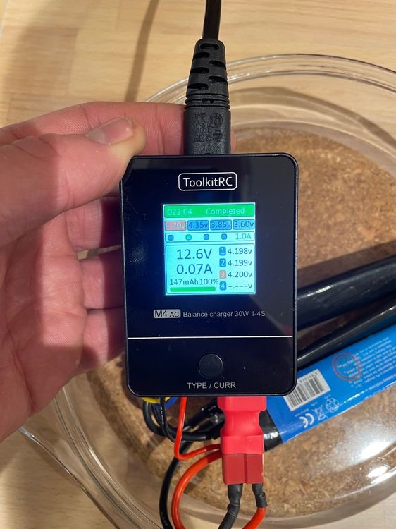

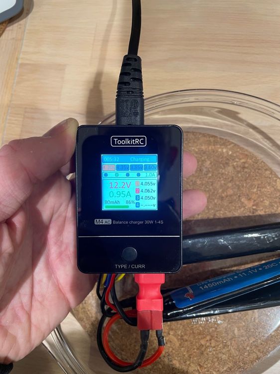

Hotweeweejef Posted November 19, 2022 Author Posted November 19, 2022 Little update for you guys. Charger turned up earlier this week and I thought I’d give it a quick spin tonight. Really happy with it for the money! Great little charger that is more or less plug and play. Once you’ve set the charge voltage and charge current, literally plug in the battery, charger assesses the load and starts charging. Shows you all the information you need, and once it’s done it automatically stops charging. Last used settings are saved too so, next time (provided you’re charging the same or similar battery) just plug it in and away it goes. Recommended for anyone looking for a cheap little charger. Rogerborg and Speedbird_666 1 1
Supporters Rogerborg Posted November 20, 2022 Supporters Posted November 20, 2022 Oh, nice, it shows per-cell voltages so you can see if you've got a problem one. Hotweeweejef 1
Hotweeweejef Posted December 11, 2022 Author Posted December 11, 2022 On 20/11/2022 at 10:48, Rogerborg said: Oh, nice, it shows per-cell voltages so you can see if you've got a problem one. Yeah, a nice little feature I thought. Rogerborg 1
