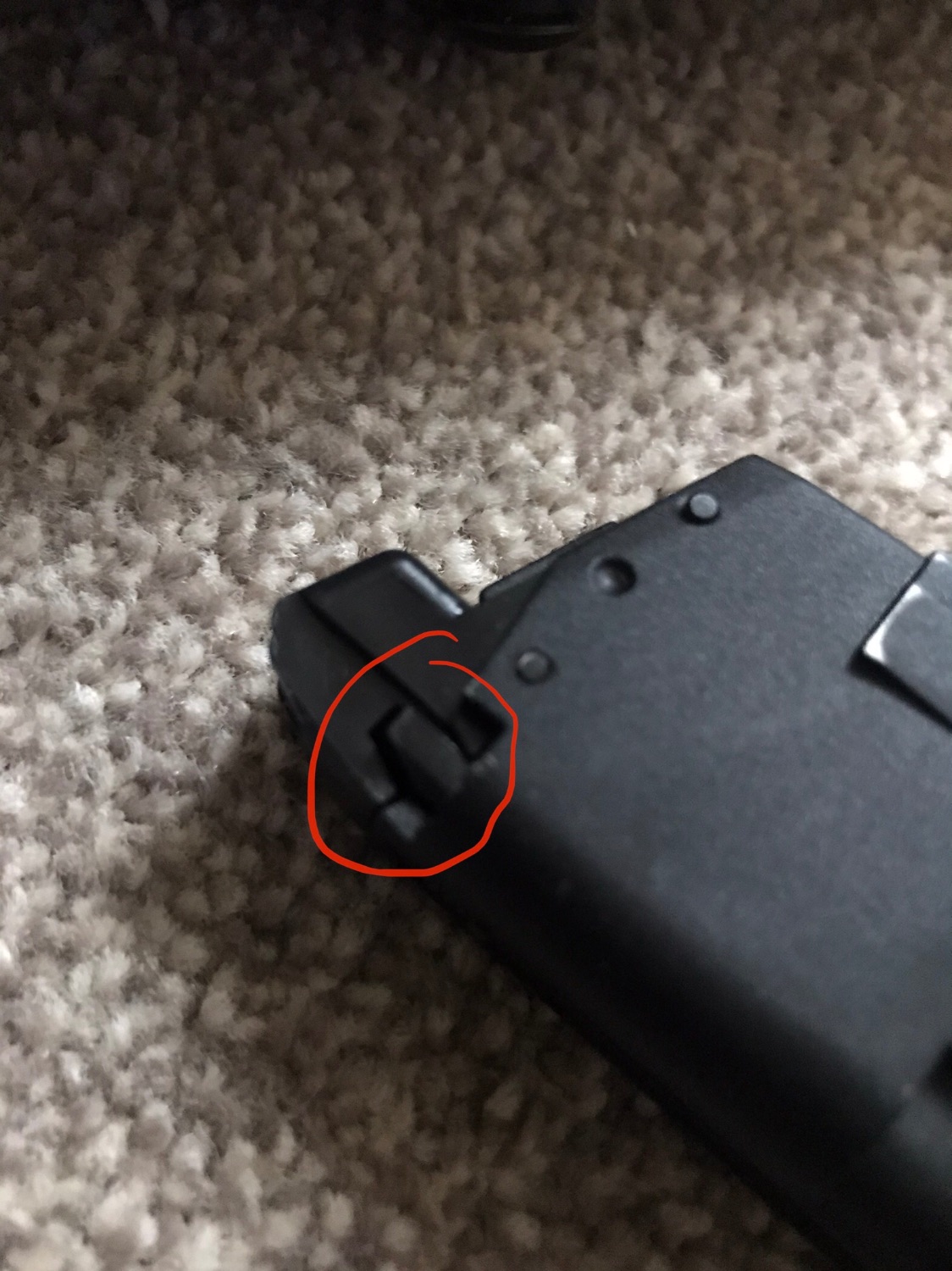

Practical shooter Posted December 16, 2022 Posted December 16, 2022 Hello, I have a umarex glock airsoft pistol which has the last round hold open function when the magazine is empty. Is there any way to cancel the feature so I could basically continue to dry fire with a empty magazine Thanks
JimFromHorsham Posted December 16, 2022 Posted December 16, 2022 Remove the follower tab on the magazine that engages the slide stop .
SBoardley Posted December 17, 2022 Posted December 17, 2022 It isn’t reversible. However if you just wanna play cowboy without bbs you could just take the spring and follower out temporarily. Just carefully slide the base plate off making sure to grab the spring, lower spring guide and upper follower amp put somewhere safe and dry fire all you want. Rogerborg 1
