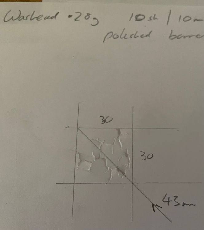

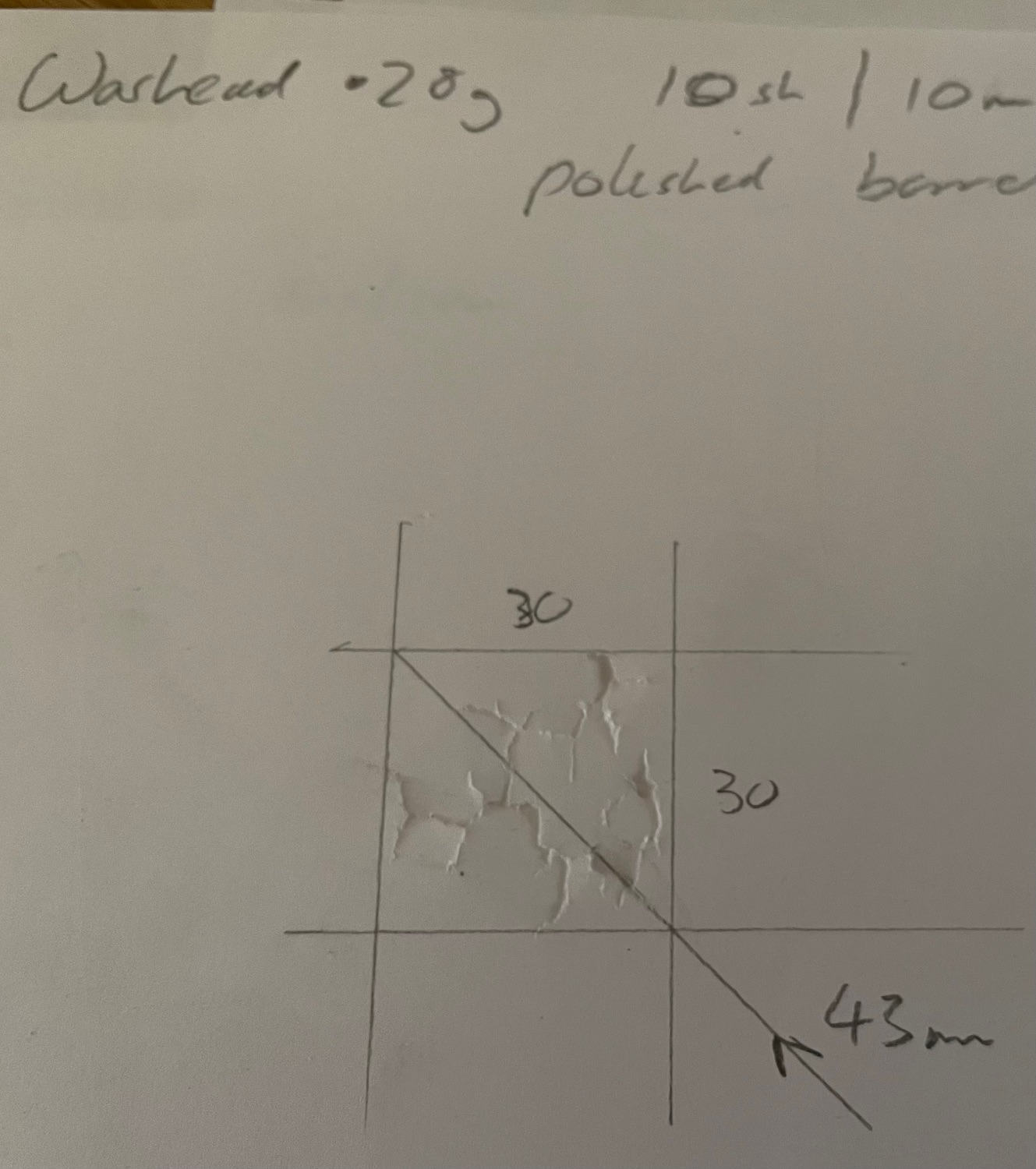

SSPKali Posted March 5, 2023 Posted March 5, 2023 (edited) Just tested all the BBs I own in my new (to me) TM M733. 300mm polished brass barrel, Macaron 50deg rubber, shooting 320fps on 0.20g. RIF was clamped, and some warm up shots fired and hop set. 10 shots fired at 10m and the diagonal of the box around the hits measured. *Warhead 0.28g - 43mm (30x30mm box!) Longbow tracer 0.30g - 45mm **Greendevil Bio 0.30g - 46mm Warhead 0.32g - 50mm ***Geoffs Super Precision 0.32g - 54mm Amoeba 0.30g - 72mm While it can easily over hop the heavier ammo the M733 likes 0.28 - 0.30g BBs and the Warhead ammo seems really consistent AND a good price! When I can be arsed I’ll check them in my MWS and see what results I get Obviously this was in my gun, with all the quirks and varied performance - YMMV * - Polishing the barrel with cleaning rod and Autosol dropped this from 51mm! ** - Spartan Airsoft specific *** - best in test for my MWS with CrazyJet barrel Edited March 5, 2023 by SSPKali Added photo RostokMcSpoons and Rogerborg 1 1
