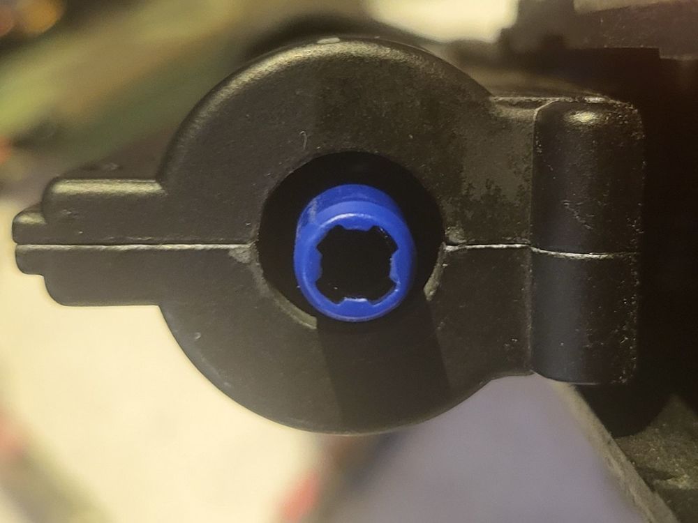

Dan Robinson Posted February 6, 2023 Author Posted February 6, 2023 Rightio... Here is a linky to the video of the pew. Took the barrel off and fired at a piece of blue roll, and I think it is OK on the cylinder and nozzle end. Next test was to get a BB in the hop, hold my finger over the magazine receiver hole, then fire. Got a decent shot off every time. Leading me to think its the seal between hop and mag - or perhaps, the nozzle and hop? Have ordered a new CNC hop up from Rocket Airsoft, and whilst I was at it, a new bucking and nub from @ak2m4 . Double checked the barrel seal to the existing Specna Hop and it was fine. On a different topic - perhaps @ak2m4can help here - thinking of upgrading the spring in my Rapax do you know what is in there from the factory? Dude at AWA said he'd changed his to an M110.. Do you have the right on in your shop? Cheers in advance!

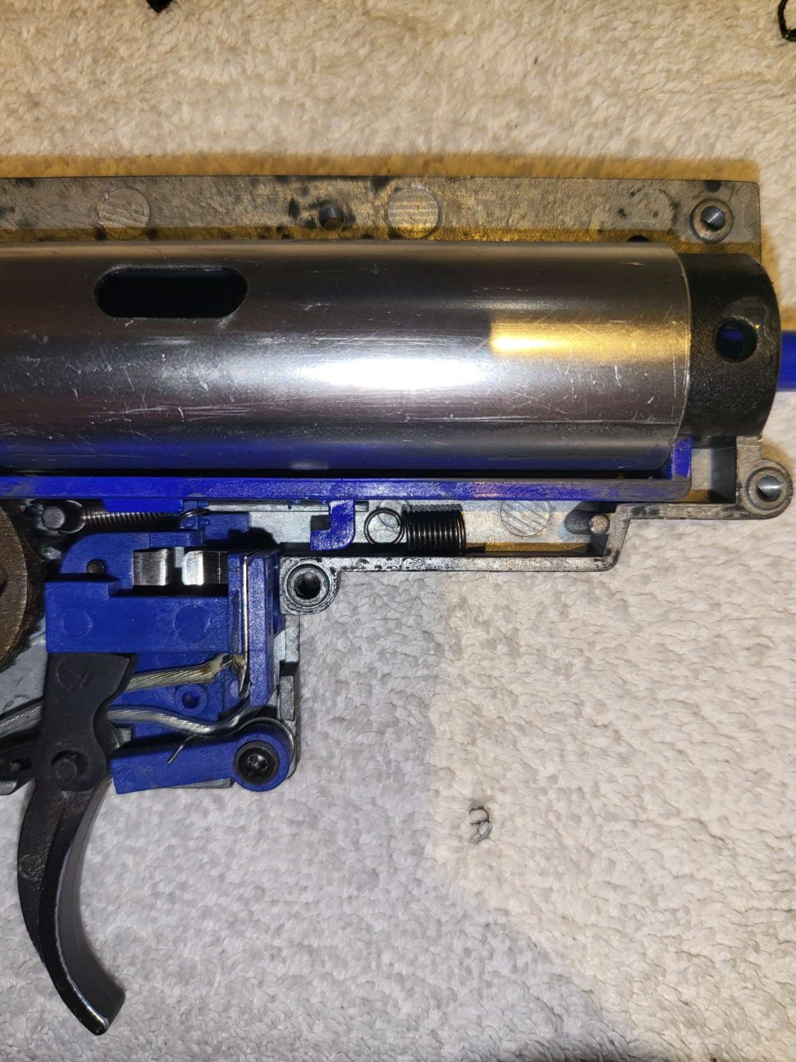

Tuton Posted February 6, 2023 Posted February 6, 2023 Hey Dan, might be the video refresh rate but is the nozzle moving back and forth? If not it could be damage to the Tappet plate up front or on the fin, the gear sitting too low or the spring has snapped/come off Dan Robinson 1

Dan Robinson Posted February 7, 2023 Author Posted February 7, 2023 (edited) Not sure if I'm going in the right direction, but I've changed the hop unit and have much more punch down the barrel, so there was a seal problem of some kind. But there is still the same feeding issue. Not totally convinced by the new hop unit itself though as it came with a small tear on the down-barrel end on the bucking, and the nub lever seems too long as if it was forming its own nub. So I'll put the maple leaf and omega nub back in the box for now.... Can always trim the lever down a tad if needed. Anyway, did a couple of slow motion shots and it seems like the nozzle isn't always pushing forward: Sorry for the grubby fingers. That being said if I cycle the piston with careful use of the trigger, the nozzle is freely moving when the piston is retracted. End of the nozzle looks OK to me too, but then what do I know? Also have a spring left over that came with the hop. Presumably for a different type of pew? Thanks again for the advice. Edited February 7, 2023 by Dan Robinson

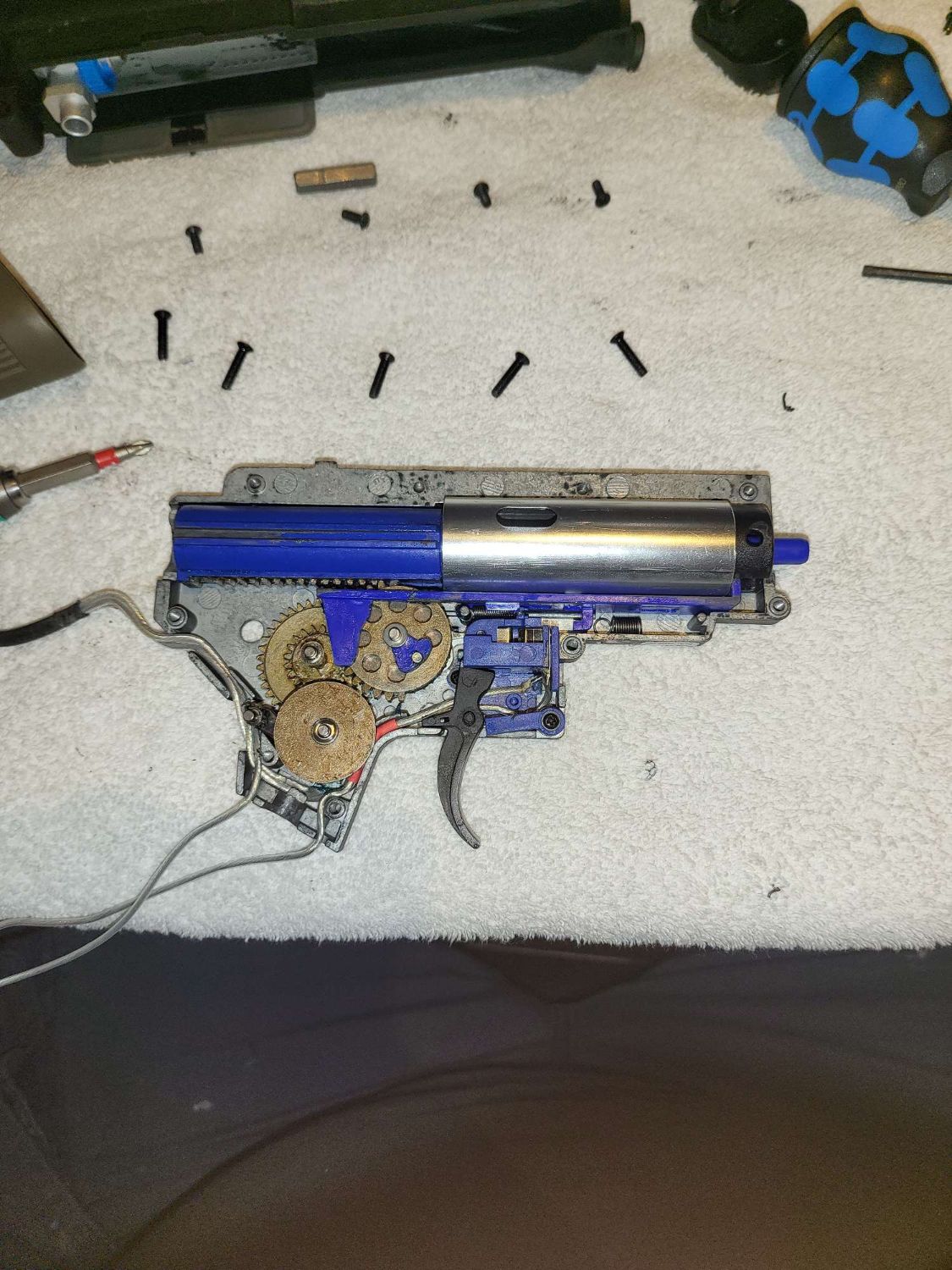

Colin Allen Posted February 7, 2023 Posted February 7, 2023 The nozzle certainly does not seem to be moving properly. It could well be a tappet plate issue; it might be sticking in its groove, rubbing on the sector gear or possibly catching somewhere. It is probably time to take the gearbox apart again. Dan Robinson 1
Dan Robinson Posted February 7, 2023 Author Posted February 7, 2023 That's what I was afraid of.... Not done that before so not really sure what I'd be looking for. Took my Rapax into the shop in Stevenage this afternoon as its under warranty.... One of the guys in the tech room opened a gearbox as I walked in, only to see a spring shoot straight out of said box and launch itself clean across the room LOL. Tried to take a picture of the inside of the cylinder but it's next to impossible. ?. Will have a look around You Tube to get some tips. Then I'll call Cage to give it an overhaul. LOL.

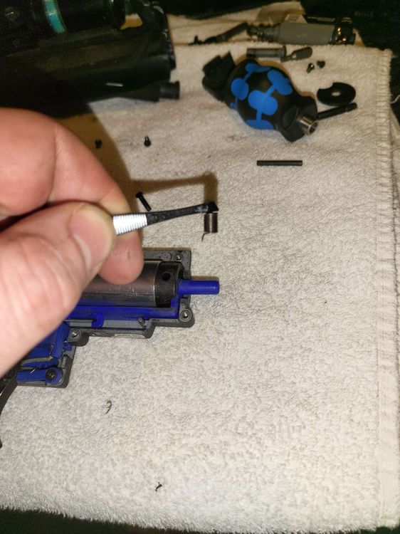

Dan Robinson Posted February 7, 2023 Author Posted February 7, 2023 (edited) I'm feeling very pleased with myself..... Tappet spring snapped.... Now where to find one? For reference, and because it should get here in time for the weekend.... https://www.ebay.co.uk/itm/314285046327?mkcid=16&mkevt=1&mkrid=711-127632-2357-0&ssspo=OlkWCNwaRSW&sssrc=2349624&ssuid=tna5mbwtskm&var=&widget_ver=artemis&media=COPY Now the cat is out of the bag.... I'm thinking new cylinder head as the seal seems a little disappointing. FFS what have I started? Edited February 7, 2023 by Dan Robinson Rogerborg 1
Shamal Posted February 7, 2023 Posted February 7, 2023 12 minutes ago, Dan Robinson said: I'm feeling very pleased with myself..... Tappet from snapped.... Now where to find one? Somebody did say it could be a broken spring. Halfords do a box of mixed springs.might be something in there which will do the job. Dan Robinson 1
Speedbird_666 Posted February 7, 2023 Posted February 7, 2023 You could trim the broken spring end and bend another coil out with needle nose pliers as a stopgap. I've done that before. It will put a bit more tension on the tappet though during cycling. Dan Robinson 1
Colin Allen Posted February 7, 2023 Posted February 7, 2023 25 minutes ago, Dan Robinson said: I'm feeling very pleased with myself..... Tappet from snapped.... Now where to find one? For reference, and because it should get here in time for the weekend.... https://www.ebay.co.uk/itm/314285046327?mkcid=16&mkevt=1&mkrid=711-127632-2357-0&ssspo=OlkWCNwaRSW&sssrc=2349624&ssuid=tna5mbwtskm&var=&widget_ver=artemis&media=COPY Now the cat is out of the bag.... I'm thinking new cylinder head as the seal seems a little disappointing. FFS what have I started? Excellent! Well found. AK2M4 ships out very quickly and has them in stock as well (https://www.ak2m4.co.uk/internal-parts/misc-internal-parts). Dan Robinson, ak2m4 and Lozart 2 1
Dan Robinson Posted February 7, 2023 Author Posted February 7, 2023 11 minutes ago, Shamal said: Somebody did say it could be a broken spring. Halfords do a box of mixed springs.might be something in there which will do the job. Yep it was @Tuton, so browny points and extra thanks to him ? 5 minutes ago, Speedbird_666 said: You could trim the broken spring end and bend another coil out with needle nose pliers as a stopgap. I've done that before. It will put a bit more tension on the tappet though during cycling. Nothing to lose I suppose LOL.

Dan Robinson Posted February 8, 2023 Author Posted February 8, 2023 Looks like it's going off to Cage anyway. I can't get the damn thing back together without it jamming up. Two teeth are missing from the spur gear, and 3 are missing from the Sector gear. 2 of them were already broken as I picked them out when I got it open. Not sure if shortening the Tappet spring caused it, but ce la vie. Might buy myself a boneyard gearbox to practice with instead of my main AEG's ?.

Dan Robinson Posted March 9, 2023 Author Posted March 9, 2023 (edited) Little update, Cage were running silent so I bought my own set of 16:1 gears and had a crack at rebuilding and shimming. Took a few goes and lots of YouTube but I think I finally cracked it (so to speak). I don't know what I did differently so can only assume the missing teeth on the old cogs were the reason for gearbox locking. Pew number one is now back together and cycling nicely with a decent punch of air coming out of the barrel. Can't really test it properly though at this time of night. Plus I should really put some grease on the insides. But it appears that I have graduated to Junior Tech First Class. Have some proper silicone grease coming tomorrow so hopefully will get it rebuilt following a successful garden test in good time for next game day on the 19th. Will upload a video for you guys to assess the sound as best as can be done to see how it is.... I still have trouble discerning what's acceptable and what is good when it comes to these cheaper gearboxes. I'm still envious of some guns who sound like the gears are running on silk, but I'm guessing they're 4 figure pews.. Edited March 9, 2023 by Dan Robinson ak2m4, Rogerborg and RostokMcSpoons 1 2
