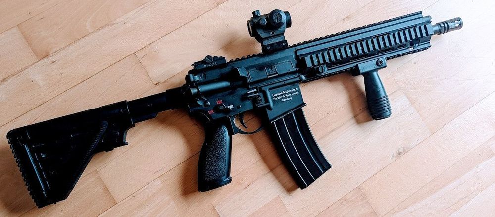

Couldn't spot a thread for this big ol' lump of goodness, so I thought I'd kick one off, so I can ask all my dumb "new owner" questions in one place.
I'll also do a personal review once I've taken it for a skirmish, but the TL;DR version is - it feels fantastic as it's built like a tank, the recoil is powerful, and with heavy BBs it seems very accurate at 15m (which is as far as I've shot it so far)
A bit of context: I've got several AEGs, a Tippmann M4 HPA which hasn't been set up well enough to skirmish with, and this is my first GBBR, so I'll be asking newbie questions about gas guns in general, as much as about this in particular.
This gun was bought used with minimal wear, with a single mag (which itself suggests light plinking use rather than skirmishing) from Action Hobbies.   I've just received a second mag from Patrolbase (cost £50, the last they had in stock)
As it's set up right now, with some old Green Gas in the mag, it's hitting 290fps with 0.40g Geoff's Natural Precision BBs ... that's about 50fps more than I should have.  Oopsies.
My initial questions are:
1) What should I check / maintain in the gun from the off?   I have already used some light silicone grease mixed with a squirt of silicone spray to make a very light grease, and lubed the bolt carrier and bolt.
2) I understand there's a built-in NPAS or power valve.  The instruction booklet is useless, doesn't say anything about that - how do I adjust it?
3) I've only shot my gun at 15m with those 0.40's... is the standard hop-up capable of lifting them at range?   Or should I be ordering something a little lighter?   (My current ammo is all 0.25 and 0.28)
4) Any recommendations on gas?  Currently there's some weird old "Puff Dino"(!) green gas in there that came with the gun.  I mostly have Abbey Ultra, Abbey Sniper, and Ultrair Power Gas that I bought for my winter use of pistols.    A bit of Nuprol 1.0 and 2.0, and some Abbey 144a Maintenance gas too.
5) Any must-have accessories?   I've already got a specialised speedloader adapter (for the cheapo pistol speedloader I'm using at the moment) off of eBay.  It seems to work a bit better than the standard one.  I've got an Odin knock-off coming too, but I suspect the mag spring will defeat that quite quickly.   The full Odin + adapter combo is a bit pricey at ~£72 though!
As always, your thoughts much appreciated :D

Guess I'll answer the ones I've figured out...
2) The NPAS valve is actually inside the nozzle, in the front of the bolt.  It needs a 1.5mm Allen key to adjust it, CW = Less Power, CCW = "MOAR POWERRRRRRR".   I've not actually done this yet, but it now seems it should be straightforward
3) A test fire at a target reveals my 0.40s were hitting smack on where I was aiming.   Either that's very lucky on the ballistics, or the hop is keeping them on the level.
(For reference - red dot sight, 15 shots in a 4.5" group, standing, no rest.  6 inside the 1" bullseye.  That's quite close to the peformance of my AEG's from a rest with scope sights - pleasing!)
4) I'm now thinking that this big ol' hunk of metal should be able to take pretty much any gas I throw into it.  It's really all down to adjusting the quantity of gas via the NPAS to get the right output.
I'll probably use my Ultrair and Abbey Sniper gas as they're low on the lube content and won't mess with my hop too much.   I'll save my lily-livered Nuprol 1.0 for my plastic slide pistols.
5) I found that BZ Tactical have the rebuild kits for Odin Speedloaders, so could buy one and fit to my cheapo speedloader, and then buy the £22 adapter.   But as I've just got two mags for ~60 rounds capacity, I might as well stick with the pistol speedloader for the moment

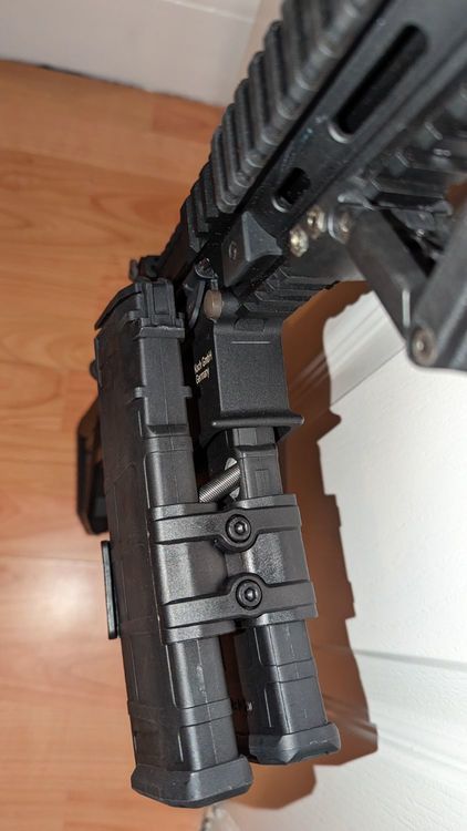

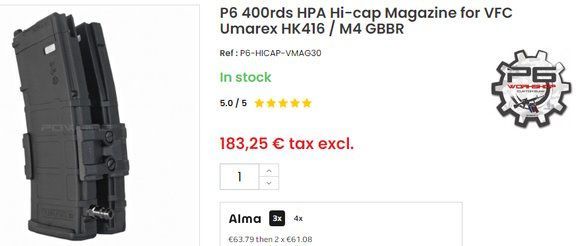

I got a notification last night that Powair6 had new stock of these little beauties...
https://www.powair6.com/en/stock-atelier/11842-p6-400rds-hpa-hi-cap-magazine-for-vfc-umarex-hk416-m4-gbbr.html
So basically a high-cap mag with an HPA line installed in.  That would save me paying out £50-60 per low cap mag, and give me stable FPS with no concerns of cool-down etc.
Usual downsides of dealing with a line getting tangled, losing the fun of tactical mag changes etc, but I think it's a trade-off I'm willing to accept.
Has anyone tried something like this, how did you find it?
My current Tippmann HPA setup has a Dye LT small tank.  It's just got an open/close valve on the top, along with a pressure gauge.  I'm not versed in the ways of HPA... would I need to buy a regulator for this?
Also, the Powair6 page asks for "EU or USA connector".    As my setup is a Tippmann, is there any chance I've got USA connectors?  How do I tell?
Edited by RostokMcSpoons
I believe Total Recoil Airsoft on you tube used this or something very similar in his 416 as well. I did look into it but after shipping and import I can imagine it being rather expensive.
I was thinking of approaching airtac and seeing if they could possibly make something like they have with the tm ak
Yeah there are actually two videos from total recoil on the product page... He seemed pleased with it.
It is expensive, especially if I'm unlucky and get whacked for tax / duty / fees but if it lets me get more use from the gun then I consider it a good investment!

Back in stock and just placed an order for one
Yup I got a notification too, nearly went for it immediately.
It'd be great to hear from you how well it works... Any idea on how long it'll take to arrive?
Hopefully before next weekend. Paid a bit extra for faster postage but guess it all depends if it getd stuck at customs.

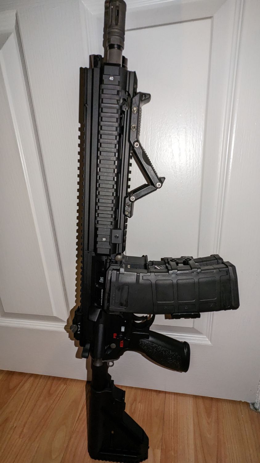

It's arrived. Ordered Sat arrived Tues.
£230 after Brexit tax
Seems well put together.
Going to field it this weekend and test it out.
Not used the 416 since October so looking forward to taking it out.
