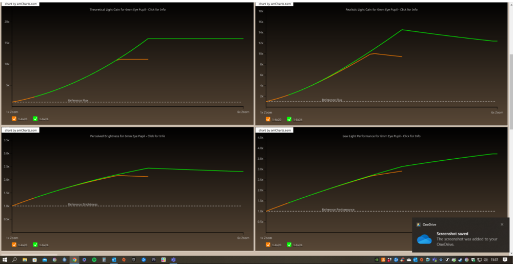

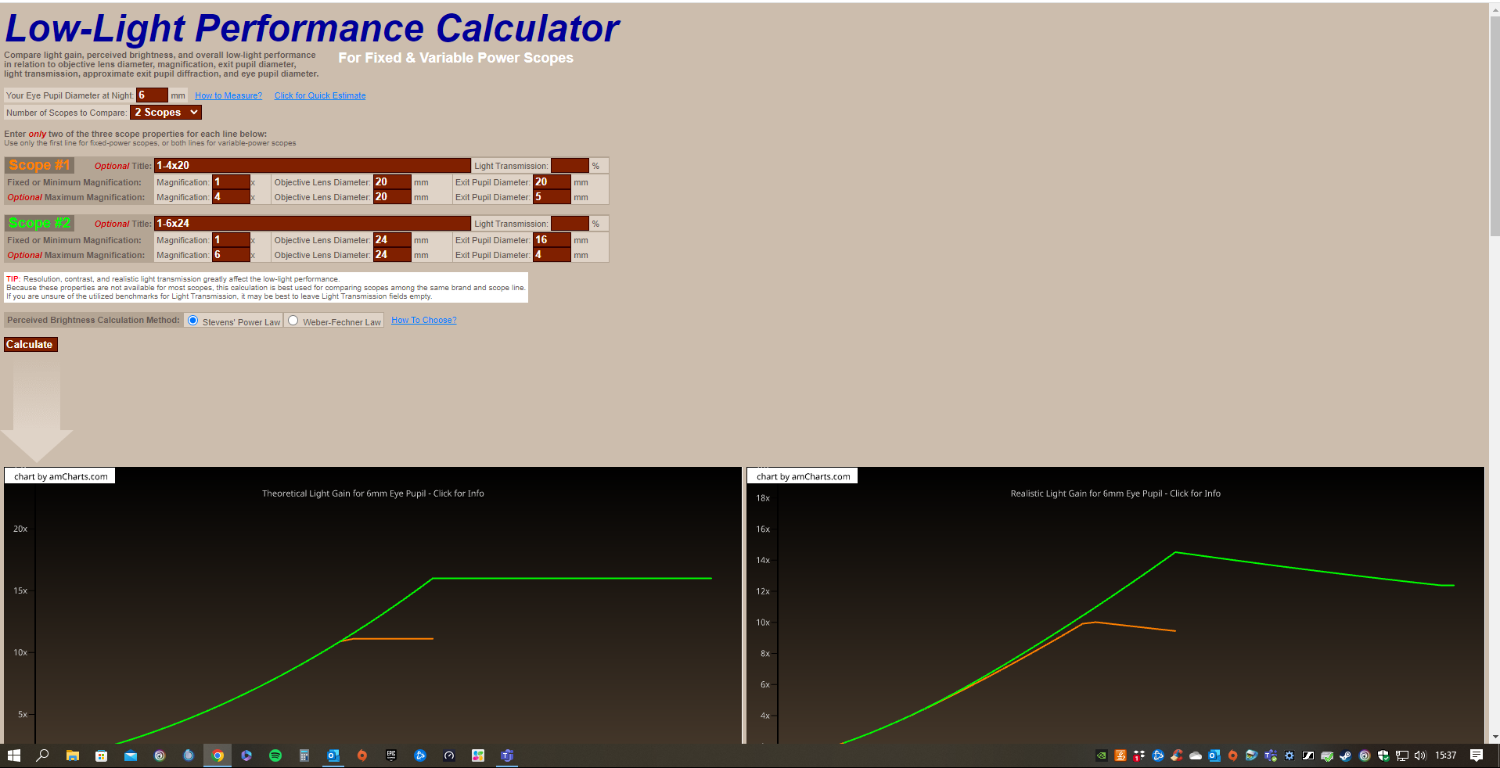

I'm going to leave this thread up though as it may help others; scopecalc.com lets you put in your scopes info and then maps out the brightness etc using flash player (so you'll need an emulator but there's some good plugins around for chrome).
Basically it would seem that at any magnification I'm likely to use the two perform pretty much the same in terms of light transmission and usable image but (as suspected) the one with the larger objective gives a better size of image.
Pics below for the rest of the nerds here! linky to calculator
