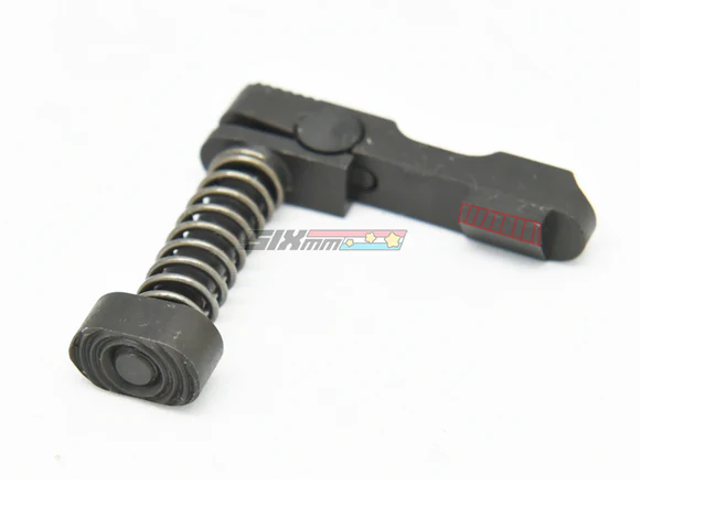

Guest ZeGausCaus Posted February 11, 2023 Posted February 11, 2023 (edited) I recently acquired my TM MTR-16 G-Edition and I adore it very much, however one issue simply devastates my enjoyment in using the weapon and that is the magazine release/catch. It is extremely stiff with a magazine in, and while I'm not unfamiliar with AR platforms, I just can't believe it is so stiff to the point where I cannot use my index finger to release the magazine, instead using my thumb and pushing down quite hard until there's an audible 'click' and the magazine drops. It's gotten to the point where I actually bruised my thumb a little, haha. I have two magazines, the one that came with the gun and the GUNS MODIFY PMAG and both have the same problem—although the magazine that came with the gun releases a little bit easier (But still requires considerable force with my thumb). I don't think this is normal and my first instinct is maybe to break the gun in but I have my doubts; I'm just not sure and this frustration is hampering my dream gun. I've tried loosening the magazine release screw a bit, rotation by rotation to no use and I've tried pushing up on the magazine, it seems to help a bit with the stock magazine but makes almost no difference with the PMAG. This problem doesn't seem to occur when I have the upper receiver separated from the lower—it's still a bit stiff and still needs the magazine to be pushed up—but at least I'm able to separate the PMAG with my index finger as long as the upper receiver is off. I've seriously tried looking everywhere from Reddit to this forum, I really couldn't find any answers that would have helped me case, so I've resorted to making a post here myself. Thank you so much for your time if you've chosen to read through this, I'd appreciate any help at all. --- The solution that worked for me if anyone stumbles across this is filing down this width of the catch as it was being pushed inward more due to the angle inside of my ambidexterous magazine release. It seems to clear it just enough that it no longer tightly rubs into the magazine. Edited February 13, 2023 by ZeGausCaus
mightyjebus Posted February 11, 2023 Posted February 11, 2023 (edited) if it's under warranty take it back to the shop. If not remove the red area by a very small amount using a file. test fit and if still tight take a bit more off. bestr to do it slowly and not rush it or the mag won't sit correctly. Edited February 11, 2023 by mightyjebus
Guest ZeGausCaus Posted February 11, 2023 Posted February 11, 2023 2 hours ago, mightyjebus said: if it's under warranty take it back to the shop. If not remove the red area by a very small amount using a file. test fit and if still tight take a bit more off. bestr to do it slowly and not rush it or the mag won't sit correctly. I'll give this a shot and see if this works out, thank you.
Guest ZeGausCaus Posted February 11, 2023 Posted February 11, 2023 (edited) On 11/02/2023 at 14:33, mightyjebus said: if it's under warranty take it back to the shop. If not remove the red area by a very small amount using a file. test fit and if still tight take a bit more off. bestr to do it slowly and not rush it or the mag won't sit correctly. I'm not sure if I've filed enough but I'm not fully comfortable with filing off any more. My problem still persists though, there is no worries with the magazine yet as it still seats and feeds fine. Please excuse my poor filing work but this is how far I've filed. Edited February 13, 2023 by ZeGausCaus
mightyjebus Posted February 11, 2023 Posted February 11, 2023 yeah thats plenty. you should have seen a difference if that was causing the issue. best bet would to go and buy one of these to try and fix the issue https://www.fire-support.co.uk/product/angry-gun-cnc-steel-magazine-release-for-marui-m4-mws-gbb-standard-version
Guest ZeGausCaus Posted February 11, 2023 Posted February 11, 2023 (edited) 35 minutes ago, mightyjebus said: yeah thats plenty. you should have seen a difference if that was causing the issue. best bet would to go and buy one of these to try and fix the issue https://www.fire-support.co.uk/product/angry-gun-cnc-steel-magazine-release-for-marui-m4-mws-gbb-standard-version Ah that's unfortunate, would have loved to keep the gold theme, dang. Starting to think the issue might not be the magazine catch at all, but at this rate I don't know if I'll ever find out. Thanks for your help though. Edited February 11, 2023 by ZeGausCaus

Nick G Posted February 12, 2023 Posted February 12, 2023 Have you tried comparing the mag catch lug to the slot in a mag whilst out of the gun ? I wonder if the catch is dragging in the slot slightly. I'm thinking width of lug on the catch rather than hight which you have alreads worked on.
Guest ZeGausCaus Posted February 12, 2023 Posted February 12, 2023 (edited) 20 hours ago, Nick G said: Have you tried comparing the mag catch lug to the slot in a mag whilst out of the gun ? I wonder if the catch is dragging in the slot slightly. I'm thinking width of lug on the catch rather than hight which you have alreads worked on. After taking a very long hard look and even filing some bits, I might have genuinely found the problem, and I might be stupid as hell for it. I'm assuming the cylindrical rod that connects to the button of the mag release, if you were to lay the mag catch flat on the ground—that it should be facing straight upwards? Because mine is bending ever so slightly, that I think it may be dragging on the slot inside my magazines whenever the magazine release is being pushed. I think the spring inside my ambi mag catch might be too strong which is what is causing the bend. I could entirely be wrong, but I have a feeling that isn't right? I might have taken a bit of a bad angle, but it is much more noticeable IRL. Edited February 13, 2023 by ZeGausCaus
Nick G Posted February 13, 2023 Posted February 13, 2023 That an ambidextrous mag catch , so you can also release the mag with your left hand , they do tend to sit at a bit of an angle. However it should be adjustabe. It looks like there is a grub screw at the right of your picture and it looks to be wound all the way out. You should be able to screw that in slightly which will alow some movement in the actual 'catch' part . Try that, I think you may have found your problem.
Guest ZeGausCaus Posted February 13, 2023 Posted February 13, 2023 6 hours ago, Nick G said: That an ambidextrous mag catch , so you can also release the mag with your left hand , they do tend to sit at a bit of an angle. However it should be adjustabe. It looks like there is a grub screw at the right of your picture and it looks to be wound all the way out. You should be able to screw that in slightly which will alow some movement in the actual 'catch' part . Try that, I think you may have found your problem. Unfortunately it doesn't appear to be a grub screw and there's nothing I can see to screw in, its a piece attached to the, 'arm' of the catch I suppose, after taking it apart the only thing unusual I can spot is that the spring is slightly bent at an angle instead of straight, that's really it though..
Guest ZeGausCaus Posted February 13, 2023 Posted February 13, 2023 (edited) 7 hours ago, Nick G said: With great help from both of Nick G and looking carefully at the mag catch, filing down the width that sticks into the magazine solved my problem as it was effectively catching onto the magazine the most due to how angled inward the arm is! Thank you for the both of you, its nowhere near as stiff and I can now reliably eject the magazine without having to use my thumb or changing my grip around. After putting a few mags through, I can confirm the magazine still reliably feeds, engages the bolt lock and holds up in both semi and full auto. I'm glad to finally be able to put this silly issue behind me and can finally enjoy my MTR-16 for what it is. I hope nobody ever has to bear this curse as I have. Once again, thank you so much for your and everyone elses help here. Edited February 13, 2023 by ZeGausCaus
