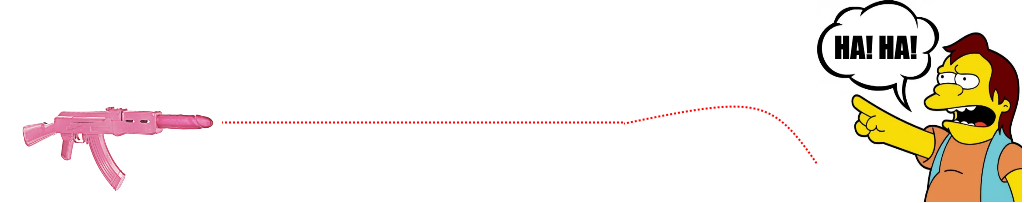

Supporters Rogerborg Posted March 8, 2023 Supporters Posted March 8, 2023 On 06/03/2023 at 13:27, irgingermk2 said: Would like abit more range from it as alot of the other guys have a fair bit more than me OK, but we need to know what's wrong with it now. What weight of BBs are you using? What energy is it shooting them at? Are they sufficiently hopped? BB trajectories can be tricky to see when looking down the gun, it helps to have an observer look at them from the side. Opinions vary wildly on the ideal trajectory, but I like to see flat, then a little lift at the end, and a sharp drop - this indicates that there's sufficient hop on it. If you go for flat and then drop without a rise, you'll never be sure that you've got enough hop on. This is what I go for: Then there's consistency. Where are the BBs going? Ideally you'll test this by strapping the thing on a bench and taking the human out of the equation. Just shoot a bunch of BBs in exactly the same direction, and see where they hit a target. The answer to those questions will lead to useful suggestions for what needs changing.
