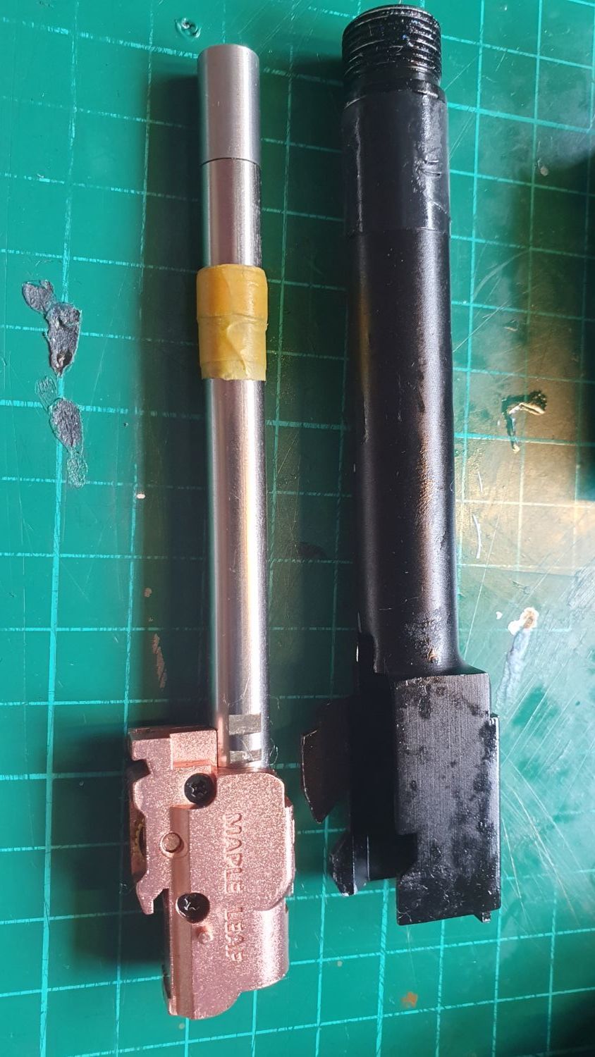

The inner barrel has tamiya masking tape wrapped around  it until it stuck/caught on outer then two turns removed to allow smooth movement. Ends superglued down so oil won't lift it and a spot of superglue under first wind onto barrel to ensure it won't slide on a oiled barrel. Play between inner and outer was removed and hop can still move as required.

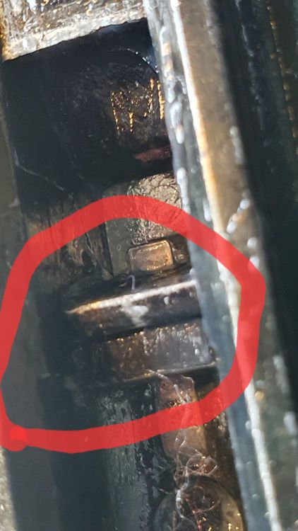

The hop is held in place on the lower either side of takedown lever on G series. I thoroughly  cleaned the area the hop sits on on the lower  and attached two pieces of plasticard, plastic and is a scratch build  modellers plastic sheet in different thicknesses cut off and shape type stuff. See pics inside red  circles are two areas. It's already very thin stuff but once set with superglue  I sanded then until the hop clips into place without a bit of wobble and Movement.  i was suprised how much it moved  and thought it would take a fair bit but the opposite. I sanded the plasticard  pieces in place quite a bit before the takedown lever snapped back cleanly locking the barrel in place.
I've yet to check accuracy but I've taken a lot of Movement out of inner and outer barrels at the exit end and steadied the hop considerably. Given this I cannot seen the value of fixing the barrels as now takedown lever secures the barrels  to the frame with no play. I'm sure the shims will wear. I've silicone geased them lightly  but it's a 20 min job to make and fit new ones.

First two show black shims that sit under the hop in front and behind takedown arm. Looks a mess I removedcpaint so shim stuck to metal and sanded in place. These removed so much unnecessary movement. Takedown lever now clicks when it locks the hop down!
Last pic inner and outer barrels, yellow tape is tamiya masking tape 5mm width (from memory) wrapped round inner barrel  removing  all but necessary  play.
You can just see black tape close to end of outer where it sits in the slide to remove  up/down play.

Shims are small and not easy to pick out.
Front 2mm x 6mm
Back 4mm x 4mm
