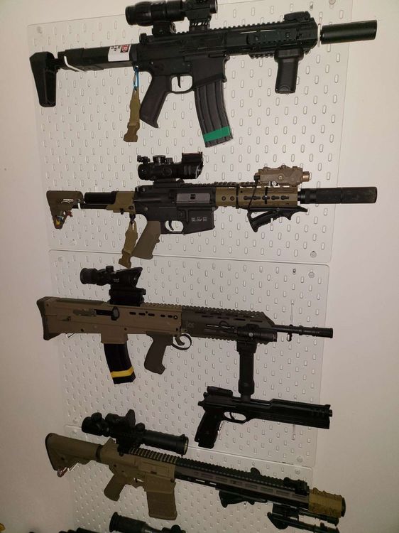

gavinkempsell Posted June 6, 2023 Posted June 6, 2023 12 minutes ago, Dan Robinson said: Interesting you say that because when his doesn't shoot, there is a much different click from the trigger. Bearing in mind that I had to remove the unit to get at the grip screw. I call BS ?? Has literally sat here 99% of the time, took it down to check the power of the 7.4 lipo's I've previously mentioned and noticed it wobble then it dropped off (still not a euphemism)
Dan Robinson Posted June 6, 2023 Posted June 6, 2023 Ouch. Is it because you have them hanging with the handle touching the racks? I purposely hang mine charging handles out..... The boy's L85 handle is lose and always has been.... We have a Web page for a spare saved for when it happens ? gavinkempsell 1
gavinkempsell Posted June 6, 2023 Posted June 6, 2023 Here's a slightly better pic, realised my LSW was hidden & I had room to move them down. I was going to take apart my Carbine to see how it's fitted to see if I can repair it but would 100% botch it so I'l try and be patient. Saw a Youtuber testing an ICS L85A2 and he had the exact same fault, cocking lever fell off due to the blow back action. DJsnipe 1
Dan Robinson Posted June 6, 2023 Posted June 6, 2023 (edited) Nice collection there dude..... I was pondering the l86 myself? I didn't know ics did a blowback L85. Edited June 6, 2023 by Dan Robinson
gavinkempsell Posted June 6, 2023 Posted June 6, 2023 Pretty sure it was solid before I took it down from the wall, and it's always been on a longer rail like seen in the pic Just now, Dan Robinson said: Nice collection there dude..... I was pondering the l86 myself? I didn't know ics did a blowback L85. It's not a BB, but fitting for the handle is the same & same lever (except for the fake insert) I loves my Bullpups & love the SA80 so try and get a version of each model, on the lookout for a Daniel defence rail A2 & a UGL for it.
