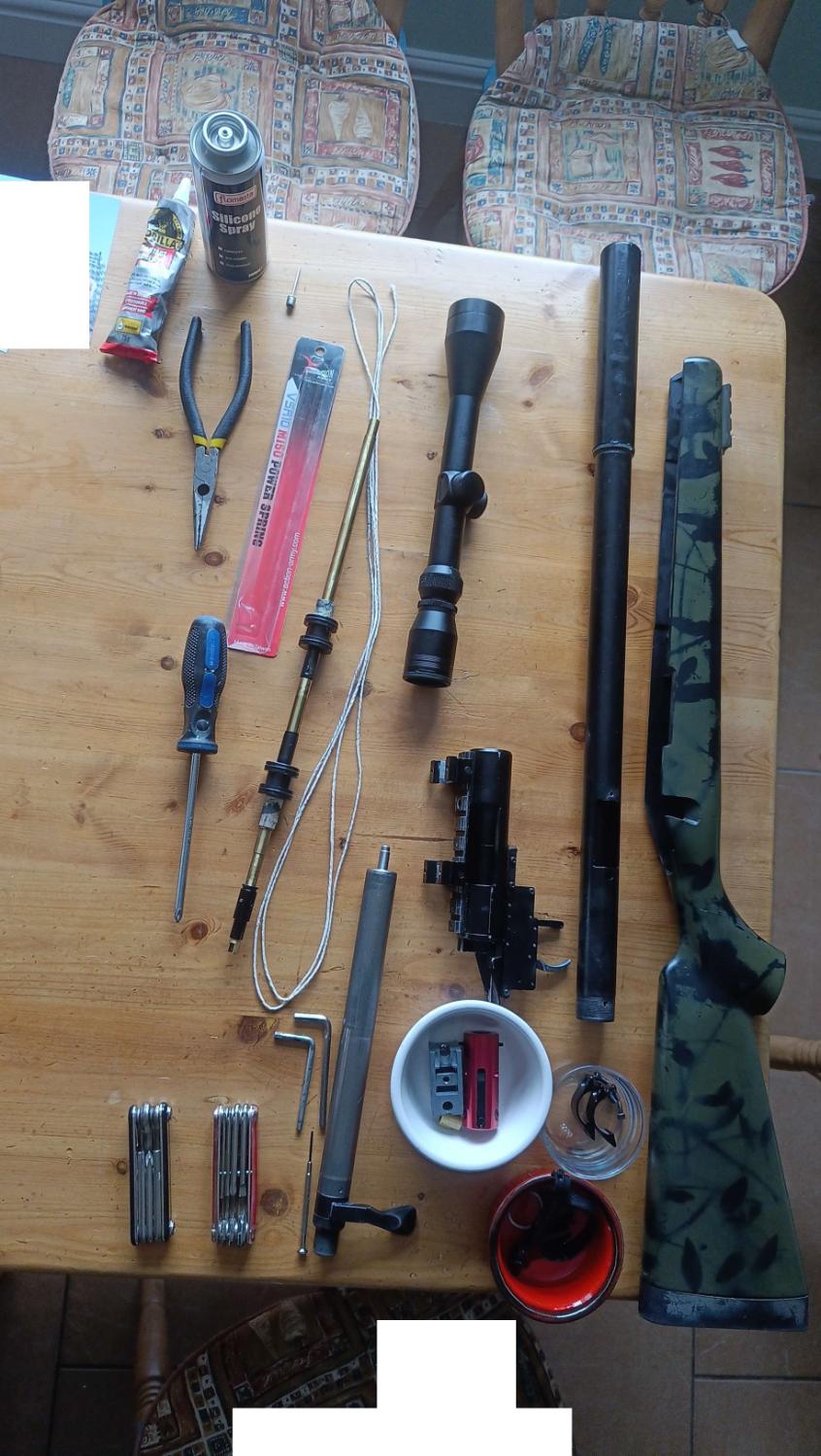

I have a TM VSR10-G spec with
Upgrades installed
EdGi 430mm bull barrel.
Laylax barrel spacers.
90� zero pull trigger.
Laylax piston.
Laylax cylinder and cylinder head.
Laylax spring guide.
Action army hop up unit.
Maple leaf 60� autobot bucking.
Maple leaf omega nub.
I baught this 2nd hand 4 years ago used it 3 times then stopped playing, I have recintly decided to get back into airsoft as I have free time again and I installed a new Action Army Vsr-10 M150 Spring but im only getting 260 fps so I thourght somthing may be broke. I took it all apart re-lubes it all with silocone spray. when I got to my buckshot it looked ok no visable tears but old. here are photos anyone got any suggestions on what I need to do?
No photo description available.No photo description available.No photo description available. image.thumb.jpeg.1397e1ab56ee44581574f5aac4e13cb4.jpeg
M150 and only 260 fps, I'd be going straight to the air seal parts. Start with a flash rubber in the hopup and new orings they feel lubed but if they have lost a little mass then you'll be loosing the seal.
What flash rubber/ oring sizer would you suggest?
I'd look to maple leaf rubber and you can either by a box of orings to try sizes or search for a vsr10 piston oring , it's usually about 18mm unless the laylax change the cylinder inner diameter.
